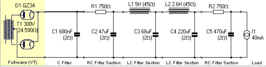

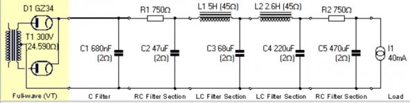

thank you all for the thoughtful replies, I am trying to make sense of it all. To start with the missing info, attached is a schematic of the PS modeled in PSUII. I should add that the voltage and current figures I measure are different than predicted, for instance the voltage at the C5 is 330-335V, not 280V, which is pretty high for the preamp tubes. The transformer is the Hammond 272FX, 600V c.t. at 150mA with 5V at 3A and 6.3V at 5A. Regarding the filaments, I have an 8V transformer supplying a regulated DC supply, so filament current is not a problem. I have several questions based on your comments but I will try to get up to speed first.

Tjj226 supplied a reference for recalculating Dc current capacity depending on transformer, rectifier, and filter type. For LC and full wave application it seems that this is measured after the choke and I might enjoy an additional 50%, or 75mA. If we ptovide for 20% headroom, that is around 175mA, less the 4 preamp tubes that leaves 135mA. Maybe I should retitle the post “low but lets be reasonable wattage power stage question.”…?
Not certain that I'm following you. Are your existing chokes rated for 150mA? Or are you intending to add other chokes for the power amp? The existing supply is not choke input, so the transformer's current rating is still 150mA. With extra load, you could expect B+ in the 300 VDC range - very flexible - and slightly more than 100mA (to spare).

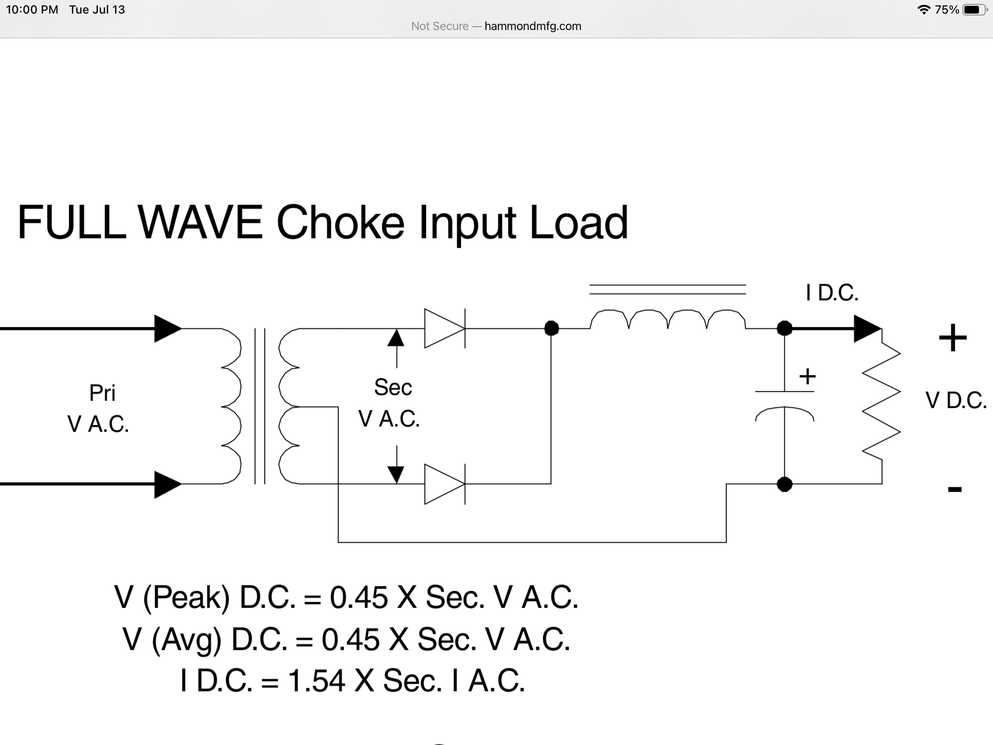

I must misunderstand the concept here. I am looking at the attached diagram. The xformer is rated for 150 mA Ac, the 5H choke in my PS is rated for 200mA and the 2.6H at 300mA. I was (wishfully) thinking that I might get more than 150 mA in Dc current after the filter section…no? And I hear you that getting a power section with whatever current is left over is possible, so we are in business. And your assumption about my listening environment is totally correct, furthermore, my wife will often be present so less is more so to speak. Also, if the OPTs are not too big, it is possible to squeeze everything into the same chassis, which is pretty big.

Now I understand - you're intending to convert to choke input, and keep the existing chokes and accept a lower B+ to the preamp. The existing large 750R resistor will have to go anyway, so you can expect - what?, about 250 VDC and lots of current. Call it preamp draw of 40mA plus another 120mA plus. 5 Hy is comfortably above critical for current drain of more than 80mA, and you're good to go.

The reason I added those 750 Ohm resistors was to get the voltage down. Previously I had a single 300 Ohm resistor in the last RC section and my B+ was over 390 vdc. I’m guessing the 6sn7s won’t last long up there. The current PSD II modeled PS above was projected to level off at 280V. What would you recommend changing in the current PS to lower the voltage, increase available current, and maintain <1uv ripple?

With a choke input he would only get ~135v assuming no loss.

Somewhere above he said 600 VACct, so 270 VDC choke input assuming no loss. What would we really get? Maybe 225 - 240 VDC? Assuming the 750R dropping resistors are gone too.

I am still missing something about the choke input load. Correct my mistake: I was thinking that DC current has a gain of x1 with and RC stage on the secondary, and a 1.54 DC current gain with choke on secondary. Shouldn't that be 1 x 1.5 which equals...225mA DC?
