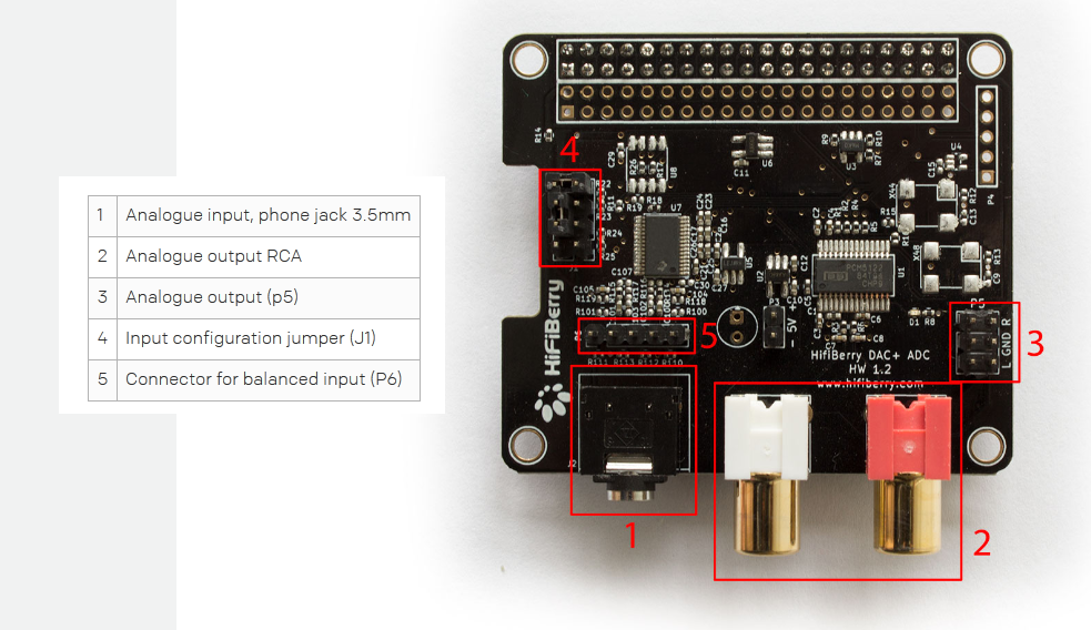

Although this thread has remained dormant since 2017 I am happy to say that I have finally found the product I was originally looking for.
It's an ADC+DAC combo implemented in a Raspberry pi HAT from HiFiBerry:
HiFiBerry DAC+ ADC | HiFiBerry
The cost is very reasonable: US$50 plus shipping by post (about 2 weeks to the US). I also found them for sale on Amazon with a steep markup, but available in a couple of days.
I have one of these on order currently. Should take a couple of weeks to reach me. When I get it I will load it on a Pi and test it out (measure the real-world performance).
The HAT is built around the Burr-Brown PCM5122. The specs look promising (see link below) and HiFiBerry has a good reputation.
Datasheet DAC+ ADC | HiFiBerry
Scroll down to the section titled "SPECIFICATIONS" for all the details. I am not sure if this is the measured specs, or (more likely) the codec MFG's specs for the chip. That's why I want to measure it for myself.
The board offers both unbalanced inputs (via 3mm audio jack) and balanced inputs (via header pins). There are a couple of different input gain settings to choose from.
This will open up some doors for using the Pi as a "DSP box". There have been several good DACs available for the Pi but few very good ADC options that didn't use USB.
NOTE: You may need to update the kernel in order to use the ADC (requires 4.18.12 or later). I just compiled the kernel as part of a related project described HERE, and updated to 4.19.23-v7+. At some point, the kernel supplied with Raspbian will be sufficient, but for now you can follow the directions posted in the thread at the link above - see post #2.

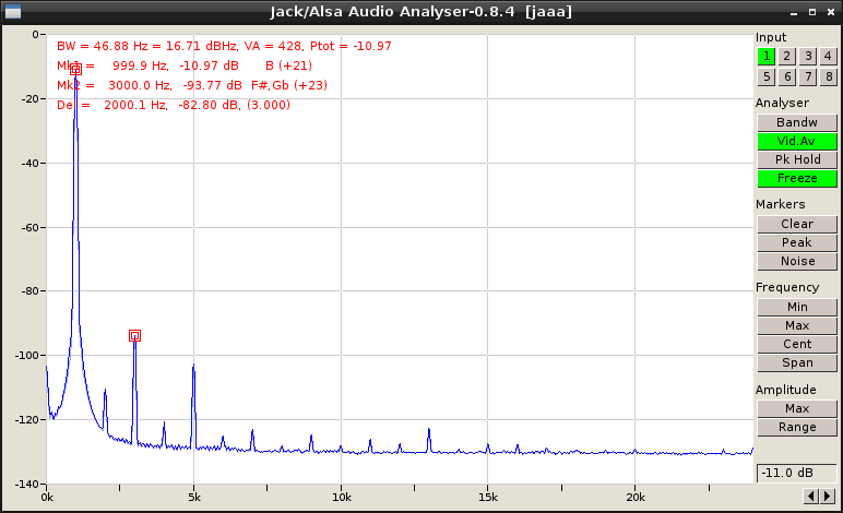

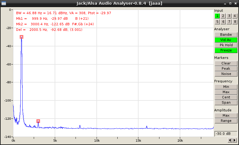

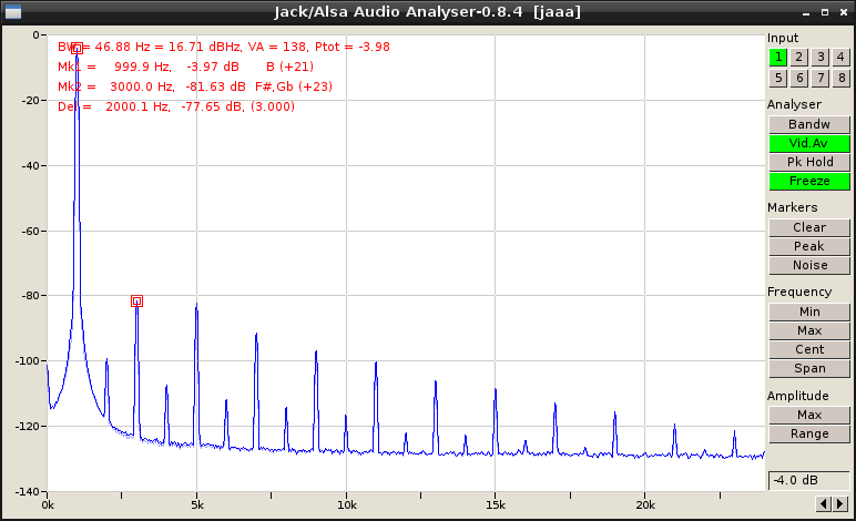

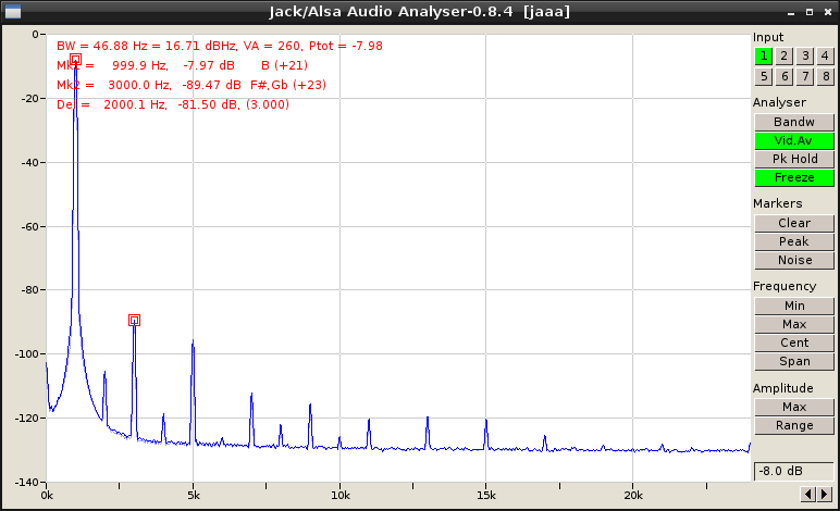

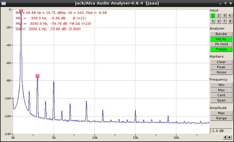

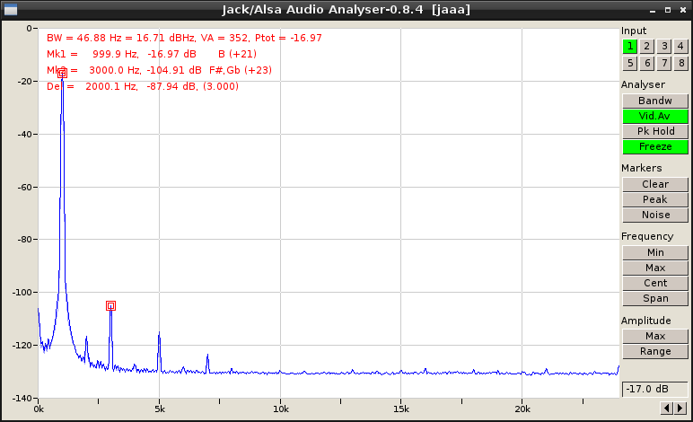

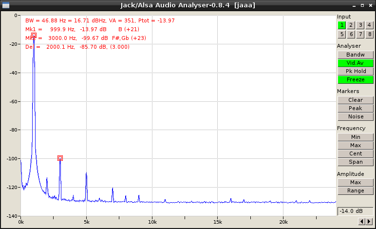

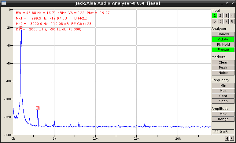

I finally managed to do some kind of testing on the HifiBerry DAC+ADC HAT. For this I performed a loopback test using the analog output --> analog input of the HAT under kernel 4.19.23-v7+. This was possible on the Pi using the software "JAAA" (JACK and ALSA Audio Analyzer). It's a basic FFT analyzer plus a signal generator.
After some initial testing I was a little perplexed at what I was seeing, so I sent an email to HifiBerry and got a response back within a few hours explaining a few things. While the board has a maximum input and output voltage of 2.1Vrms, the designer told me that he had optimized the performance for about 0.5-0.7Vrms. I also had failed to see in the documentation (they call it the "datasheet") that "typical" distortion levels of about -90dB or slightly better could be expected for those signal levels.
I went back and made a series of measurement that help to explain what you can expect from this board. These are provided in the attached screen shots. They are the spectrum for a 1kHz test tone at various output levels. The level is shown in the bottom right hand corner as well as in the top line in red text at the upper right hand corner of the spectrum window. The highest distortion peak was always 3rd order. JAAA allows you to monitor two peaks in real time and displays their level and the DEL, or difference. It's this difference that is the distortion level (see lowest line of red text).
Here is a summary table for the 1kHz test versus level, for 3rd order distortion only:
Distortion starts rising by around 2dB for each 3dB increase in level beginning around 0.2Vrms. For all but the highest levels, 3rd order dominated and this is a reasonable approximation of THD. In all cases the noise floor remained below -120dB.
This seems to be a nice Pi HAT for the DIYer, providing both stereo INPUT and stereo OUTPUT for only US$50. Combined with some IIR DSP on the Pi, a pair could make a nice active crossover for a 2-way system. Additional USB DACs could provide additional output channels as needed.
Please see attached screenshots of the spectrums collected for these measurements.
Code:
LEVEL......Vrms........DISTORTION...% distortion
-30dB......0.066......-92.68dB......0.0023%
-20dB......0.210......-90.11dB......0.0031%
-17dB......0.296......-87.94dB......0.0040%
-14dB......0.419......-85.70dB......0.0051%
-11dB......0.592......-82.80dB......0.0072%
-8dB......0.836......-81.50dB......0.0084%
-4dB......1.325......-77.65dB......0.0131%
-1dB......1.872......-73.80dB......0.0204%
In addition to the distortion measurements above, I want to stress that the noise floor of the DAC+ADC HAT is pretty low, making the S/N better than 120dB. After I made these measurements I threw on a USB (self powered) pro audio interface and while its distortion was lower the noise floor was higher.
As long as you keep the signal levels on the low side of consumer level the HiFiBerry HAT should be a great audio I/O solution, even when using high sensitivity CD+horn tweeters.
^^ The noise floor or SNR really isn't below -120 dB, only the levels of single frequency components in FFT are below that level ("FFT noise floor"). The SNR is ratio of signal power to noise power. Compare the results to SB Live! RMAA measurements here for an example, the fft noise floor is there close to -130 dB but the noise level is about 102 dB:
