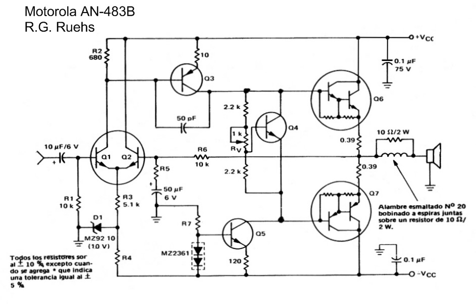

Motorola AN-483B
Author R.G. Ruehs
Year ?

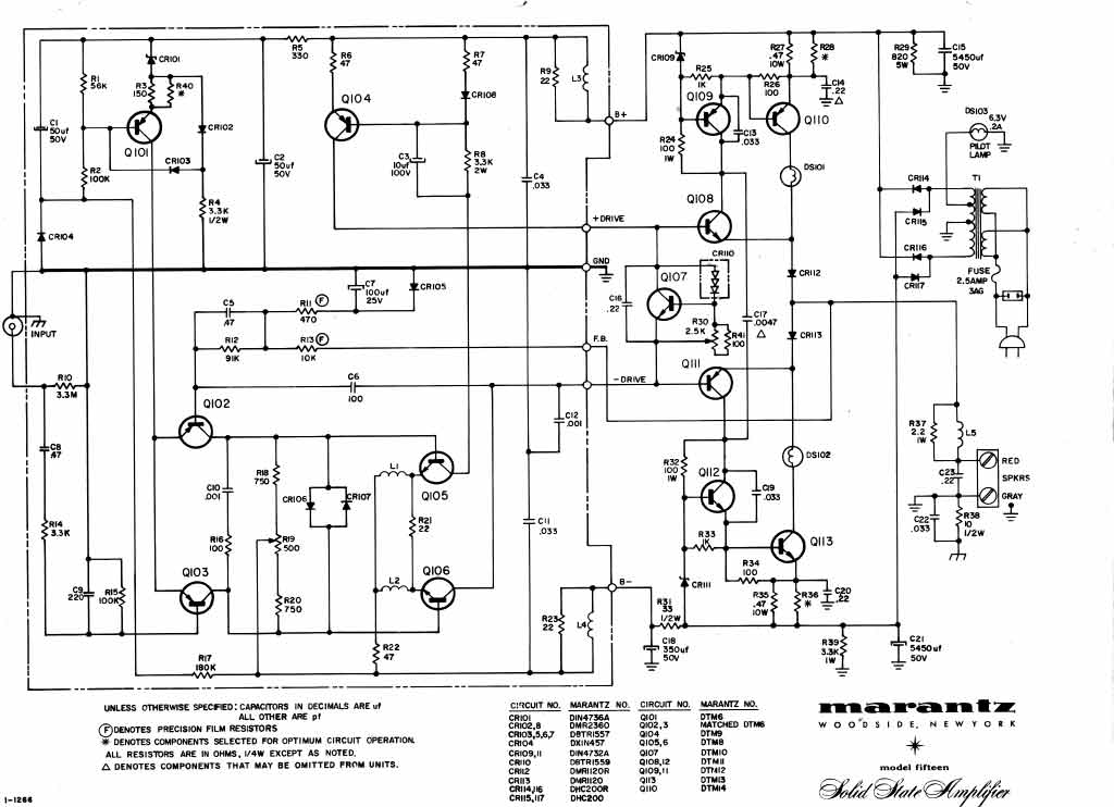

jez, thanks for having provided the Marantz Model 15 schematic. I'm taking the liberty to reproduce it here, from your post on DIYaudio http://www.diyaudio.com/forums/solid-state/194562-diodes-instead-across-emitter-resistors-2.html Very interesting post indeed. Will somebody organize a LTspiceIV simulation ?
Bad news, I can't say that the Marantz Model 15 dating back from 1966 is a "blameless" ancestor. Okay, it has a differential input (long tailed pair Q102 Q103) fed by a current source (Q101) but that's all. Q104 Q105 Q106 are not the kind of VAS you'd expect from a "blameless". This beind said, the Marantz Model 15 schematic is far for being uninteresting, with the CFP arrangement at the output. Why CR112 and CR113 ? I would expect a low value resistor between CR112 anode and CR113 cathode. Has anyone tried replacing Q102 Q103 by matched FETs, Q109+Q110 (and Q112 +113) by a MOSFET, and using Schottky diodes for CR112 and CR113 ? This would deserve a dedicated DIYaudio thread.

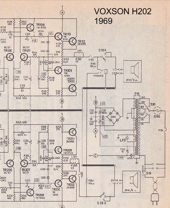

In 1969 there is the Voxson H202. The differential input pair isn't fed by a current source. The VAS gets loaded by a capacitive boostrap arrangement. This is actually worse than the Sinclair Z30/Z50. The Sinclair Z30/Z50 has the VAS loaded by a constant current source.
I think Kenpeter gave valid explanations in some of his posts, diodes in the output being one of his pet subjects.
To summarize his views (which i agree with), the diodes "extend" the exponential characteristic of the B-E diode, but without the huge heating caused by the collector junction.
Removing the emitter degeneration resistors in a class B PP improves linearity, but it also is extremely risky.
Using external diodes mitigate the risk (not completely, apparently, since light bulbs have been added: there must still be some times when things go badly wrong).
The other purpose is to prevent shutdown of the inactive device: at high currents, the apparent resistance of the diode becomes very small, and the total voltage of the base spreader is still sufficient to keep both devices on.
This also gives a much softer transition, with crossover artifacts "diluted" over a large voltage range.

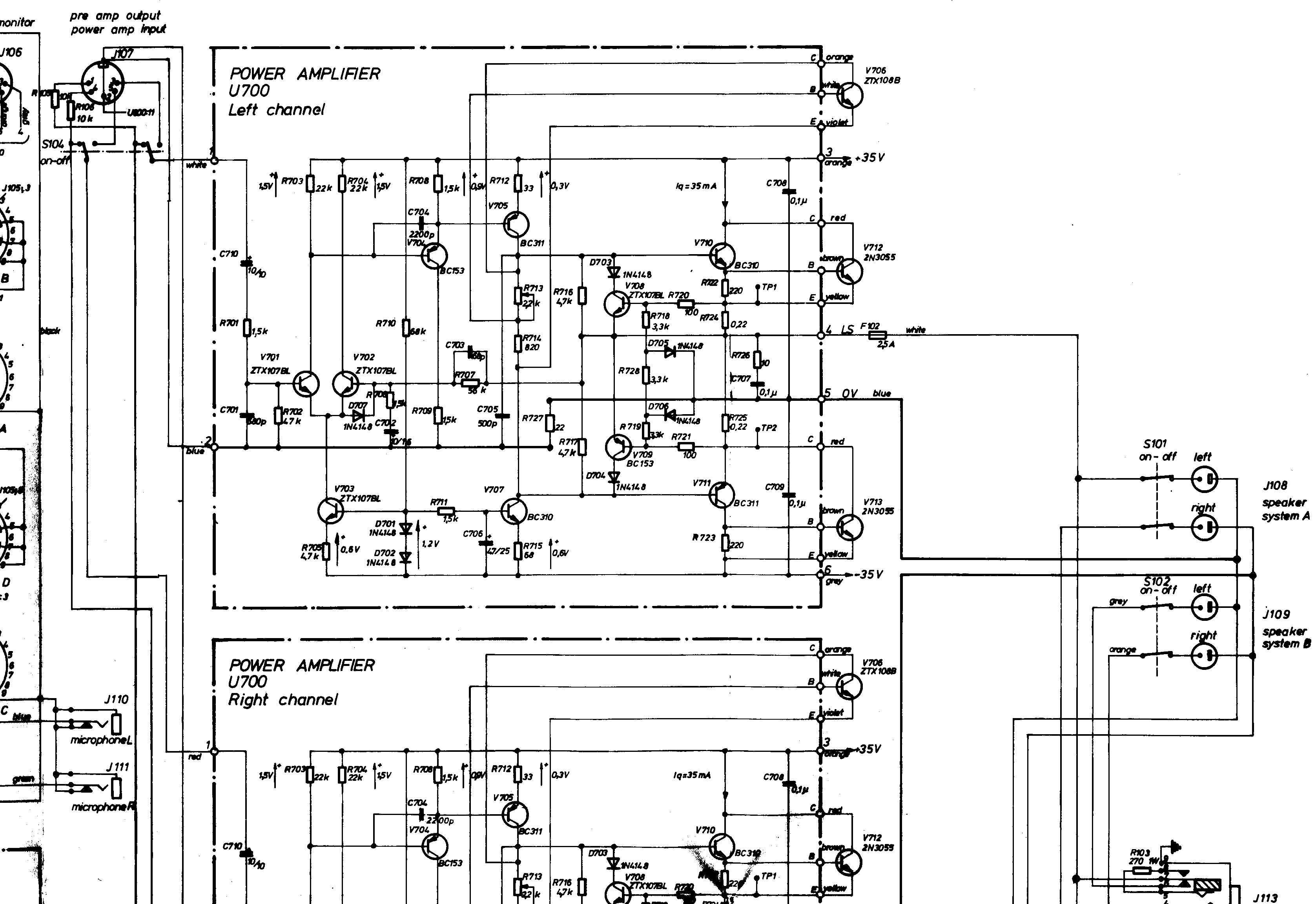

Agree with you, but you see, if we call those amps "pre-blameless" we'll get thousands of people coming with the H.C.Lin (RCA - 1956) "complementary and transformerless push-pull" topology. So, how would you call the Sonab R4000/U700 power amplifier dating back from 1969 ? Make a proposition (max 16 letters, space included).
Disabled Account
Joined 2006
Just a Lin topology with enhanced beta vas, its still missing the current mirror, its very close though, do you perhaps know who the designer was ??. I guess the nearest we can get is to find out who came up with the different schemes that make up a blameless for instance the current mirror or the beta enhanced vas, it would be interesting. What D Self did very well indeed was to combine all these features to make a amp with extraordinary performance while keeping complexity to a minimum. One has to use quite a lot more parts to be able to inprove on it.

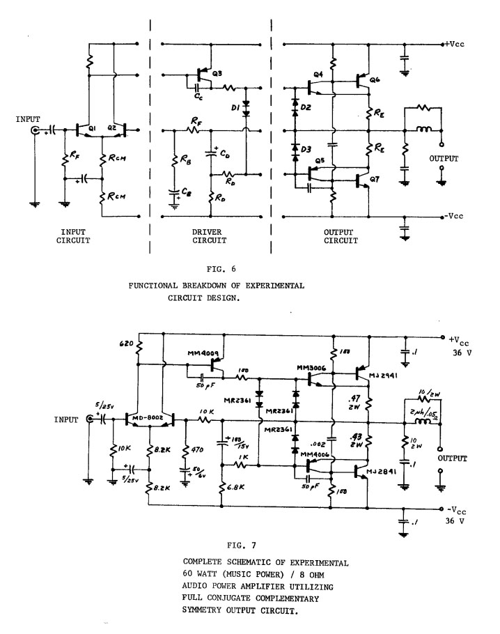

Clearly, within Motorola in 1967 (Haas AES publication), the current mirror as load for the differential stage had not been disclosed yet. See attached pictures.
Could it be that this particular AES publication from Haas in 1967, working at Motorola, is the milestone marking the end of the H.C.Lin era, and the beginning of the blameless era ?
If yes, I would agree to name all the "pre-blameless" amplifiers, "G.C.Haas" amplifiers.
