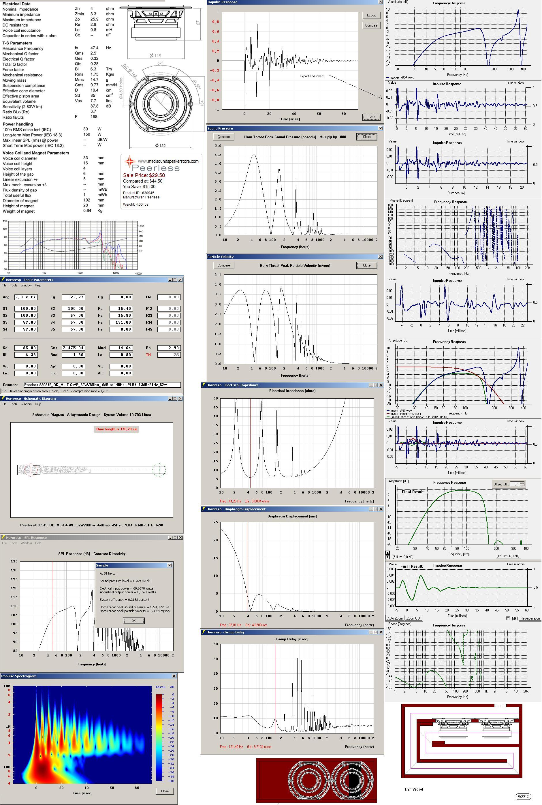

Hi, Here is a suggestion that is omni up to ~150Hz and can be used in numbers to form an array.
b🙂

Bjorno, thanks for all that! something must be a bit awry... I see something about "at 51 dB Sound Pressure Level =103,9943 dB"... I wonder what it would take to quadruple that 150 hz. I'll spend some more time with that and learn some more.
