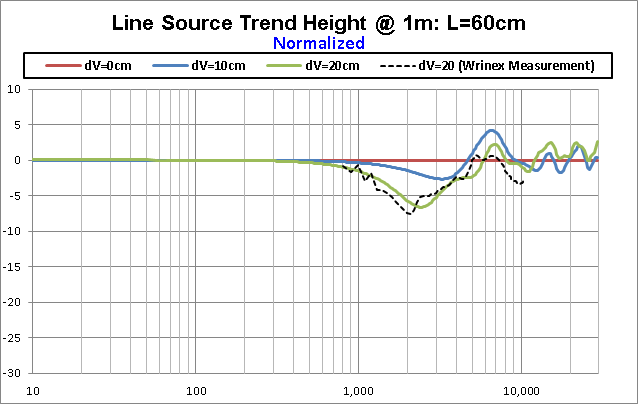

So I borrowed a BG8 from a friend and took a quick set of measurements to compare with the calculated theoretical off axis response.
Measurements were taken at 1m from the BG8 mounted in free air on a pole attached to rotating platform.
I estimate the width to be about 5 15/16" = 0.1508 m.
Theoretical response calculated using the sinc function mentioned in post#3, and the cos(theta) response for a dipole radiator.
Plot #1
The measured off axis response for the BG8 on the long axis.
Note that I didn't bother to notch out the cavity resonance.
Plot #2
Same data set, just normalized to the on axis response.
Plot #3
Normalized measurements compared to theory for 5, 10, & 15 degrees off axis.
Plot #4
Normalized measurements compared to theory for 30, 45, & 60 degrees off axis.
NOTE: Due to length of measurement window, ignore measured data below about 350Hz.

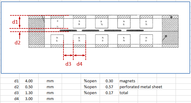

It is a combination of 4 things that define fr(resonance frequency) and Q :
1) Mass of the diaphragm + conductors (heavier makes fr lower)
2) Gap distance between diaphragm and magnets (larger gap makes fr lower)
3) Thickness of the channels or slots between the magnets including the outer plate. There is also an end correction similar to port end correction for vented enclosures. (thicker makes fr lower)
4) Percent open area. (Q increases as % open area decreases)
As you noted, the same behavior exists for ESLs, but usually it is more troublesome for planar ribbons because of the higher mass of the diaphragm and conductors, the added thickness of the magnets, and the lower % open area. The Monsoon drivers have higher diaphragm mass, but the %open area is much greater than the Neo8. A comparison was posted as Attachment #2 here:

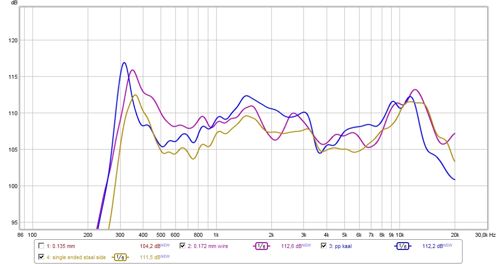

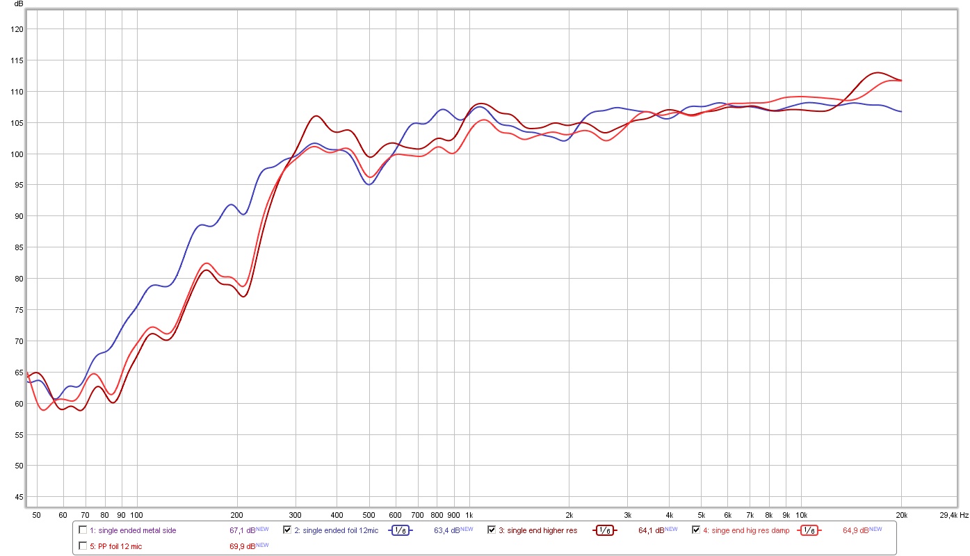

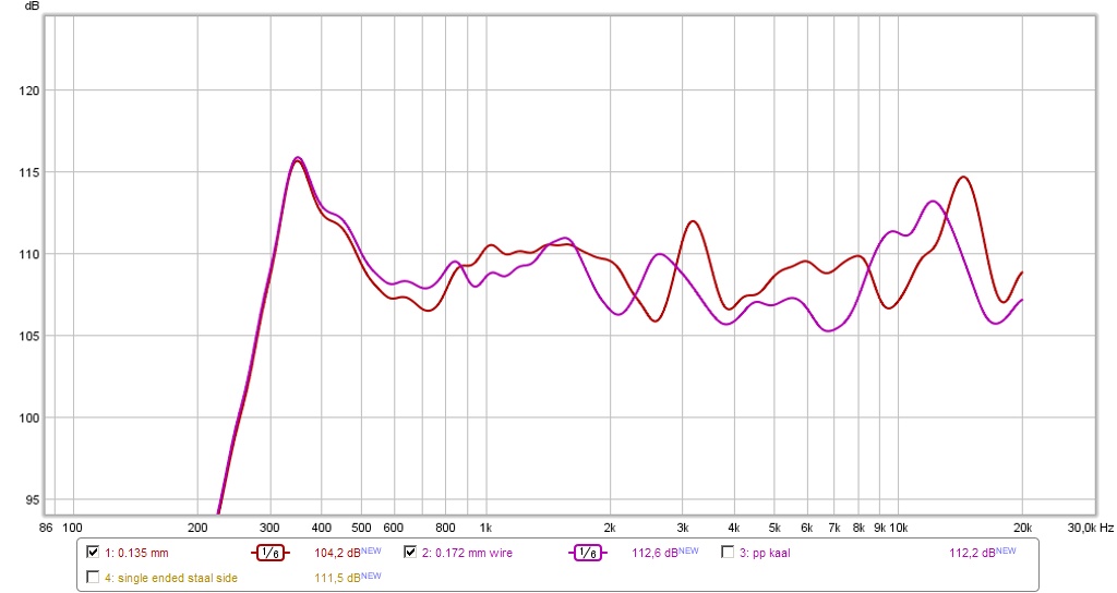

Redit measuring 2 rows of light 0.135mm wire vs 4 rows of heavy wire 172mm.
yes it would be nicer to have 4 and 4 but the magnet structure was made for 6 wires. and if i use uneven the wires end up on the wrong side of the panel 🙂.
any how beside less output they look rather the same and i was mostly interested in the peak only. so here they are in
picture 1. 0.135mm wire vs 0.172mm
You can see the thinner wire has the peak a little higher, spl is not right, since one wire has 4 turns in the magnet gaps and the other only 2. i leveled them at resonance, but when i think of it i might have gained the thin wire to much since it uses less of the foil and is only near the edge of a spacer it probable cant even put out the same volume at res. so the height of the peak we cant compare. just the shift, i think.
Picture 2.
No i thought it is fun to see what happens to Push pull (BLUE) vs single ended , the single ended (BROWN) is measured with the metal plate facing the mic, to make it a bit more fair. also only one wire gauge is used throughout. also it is the same panel just added a backside
now what is funny, the resonance goes down as expected in push pull, and the cavity fr goes down to. But when i add the push pull from the first picture with the same wire (Purple) you can see that panel had higher resonance since the PP version is as high in res as the (brown) single ended version. now what is fun that the cavity resonance fr is also the same as the single ended version. even with an extra metal plate and magnets behind it. sooo, by the looks of it it is even more complicated ? foil resonance dictates something as well looks like it ? Bolserst any idea what is happening here?
Oh one last thing i just thought about, in pic one it might not even be the fact the wire is lighter that the peak shifted, but the fact it only played near the spacer where the resonance sort of looks higher ? i mean if i made single wires all over the foil and measured them from left to right one wire at the time (might be very interesting by the way), i bet i get different resonance and one main resonance ?

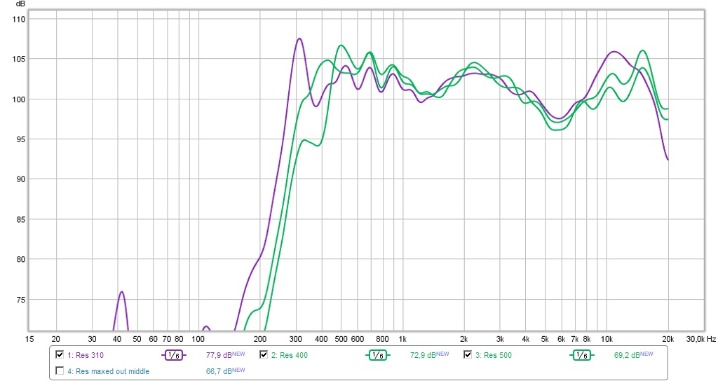

i thought so many times about making a panel i could adjust resonance on the fly 🙁 i might have to build one. so i can leave everything the same and see what resonance does EXACTLY with the peak.. and while im at it i might do the single wire test to to see what happens to a conductor when it is near a spacer or more in the middle of the foil where it is aloud to move more... so much to test if you suck at mathematics 🙂

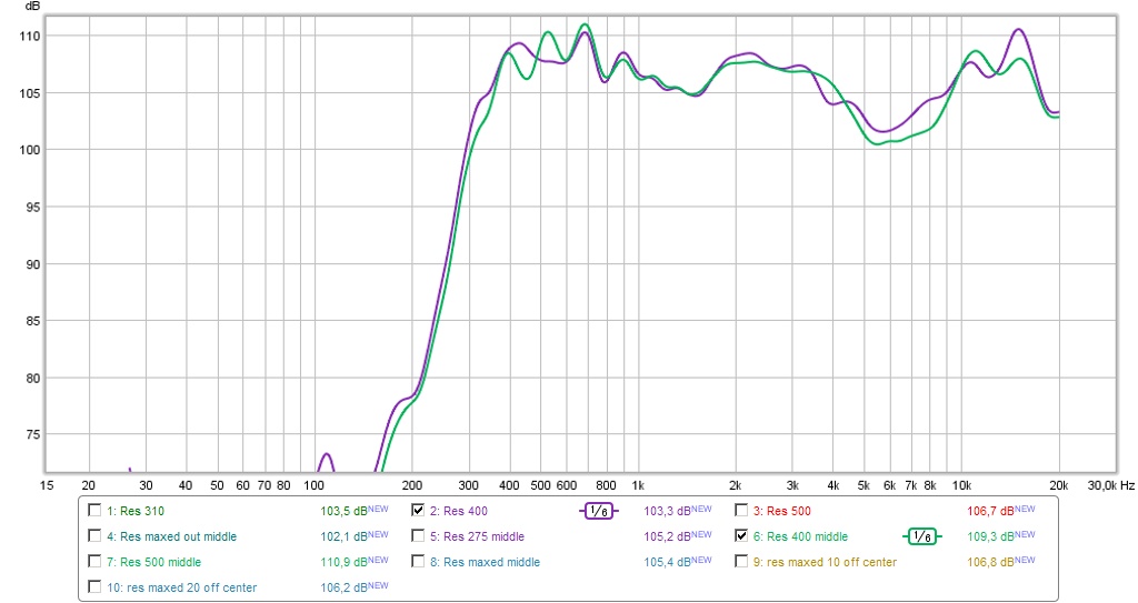

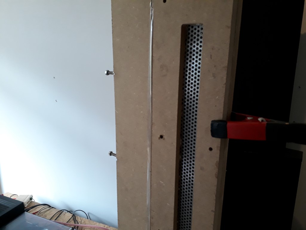

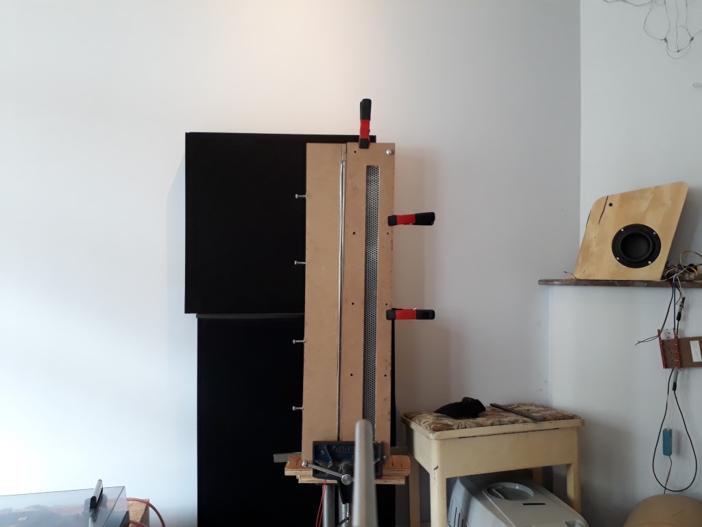

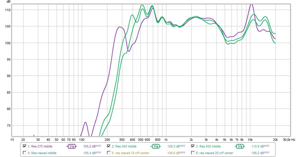

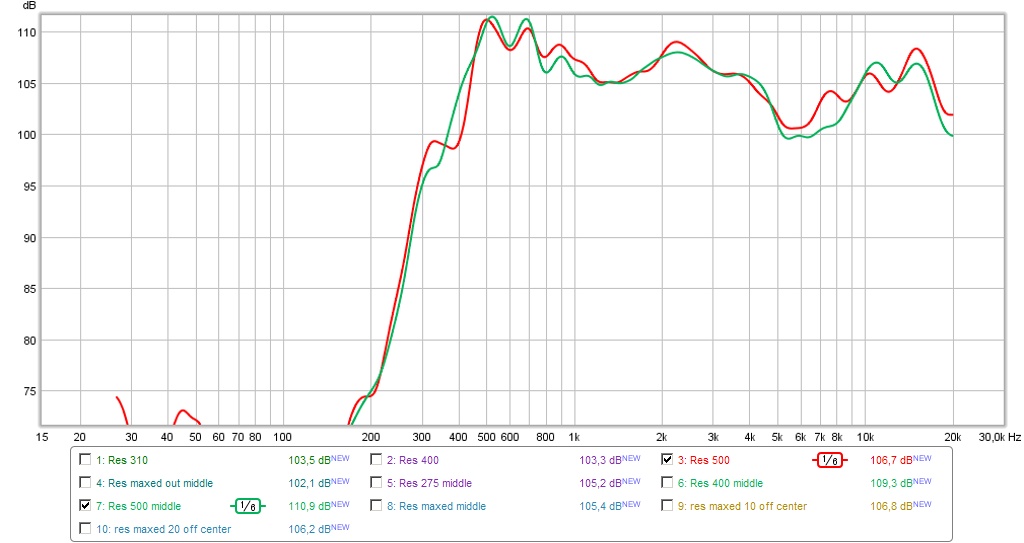

So i made variable jig so i can change resonance to once and for all be done with guessing.
Pic 1.
0.135 mm wire with different resonances
Pic 2.
0.172 mm wire with different resonances
Pic 3 difference between 0.135 and 0.172 mm wire at 400hz res
Pic 4 difference between 0.135 and 0.172 mm wire at 500hz res
Pic 5 0.172 mm wire , tension maxed out at 530hz or something. but the difference in changing the measuring position in the vertical plain.. changes are rather extreme ? i measured @ 1 meter, and the panel is 60 cm x 2.8.
Pic 6 and 7 the panel and setup, those edges of the wood might fuckup something as well 🙁 i forgot to round them off and now my bit wont fit in there haha
well there is not much happening , it did look like it did before 🙂 well thats why i tested of course, it does change a bit but mostly the dip becomes larger and the peak goes a little up and gets broader.
in terms of weight, 0.135 or 0.172 does not change anything. might be due the fact i used 12 micron mylar.... so i could redo the whole thing with 6....
any idea about the vertical changes that are so dramatic? i measured in the middle for all tests and then shifted the mic 10 cm up and then 20 cm.
Does the space in between the magnets not also change the FR of the resonance ? just like a bass reflex tube/helmholtz ? like if i change it from 1 mm to 3 mm? or only the Q goes down (the height of the peak). while still using 3mm thick magnets and 1mm steel plate. so thats the length of the ''port' but if i make the 'port' wider the resonance goes up ? at least in reflexes it works like that i have to add a longer tube if i used a bigger one.
by the way it looks like it has 2 cavity resonances one at 11 khz or something and one at 16 ? could this because i shaved of 0.5 mm from one side of the magnets and not from the back stator ? would be rather dramitc improvement 5 khz for 0.5 mm to be honest 🙂
i forgot 🙁 the 0.135 vs 1.72 wire comparisons dont say witch wire is witch haha
So for the 400 Hz comparison Green is 0.172 purple is 0.135
For the 500 Hz comparison Green is 0.172 and RED is 0.135
so yeah in both cases 0.135 does extend a little further. not by much though.

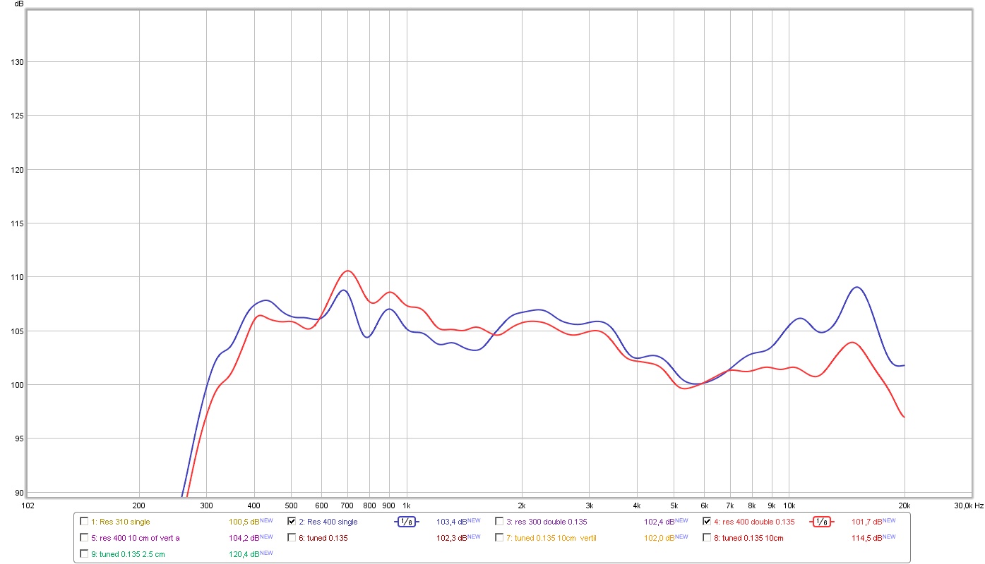

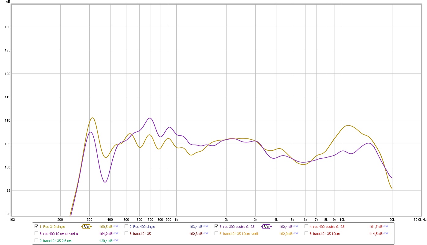

Here are the comparisons of only 0.135 mm dia vs double 0.135 mm dia in parallel. (i did gained the single with 3dB since the resistance is twice as high)
Pic 1. 300 Hz single (brown) vs 300 Hz Double(purple)
Pic 2. 400 Hz single (blue) vs 400 Hz Double(red)
You can see in both pictures the peak is less pronounces but the NULL at 5.8Khz remains
why there is more output down low in the double wire, i have no clue

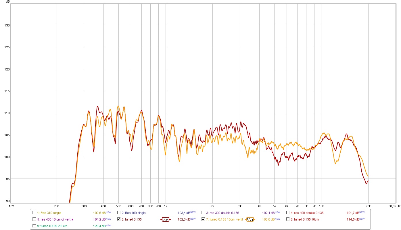

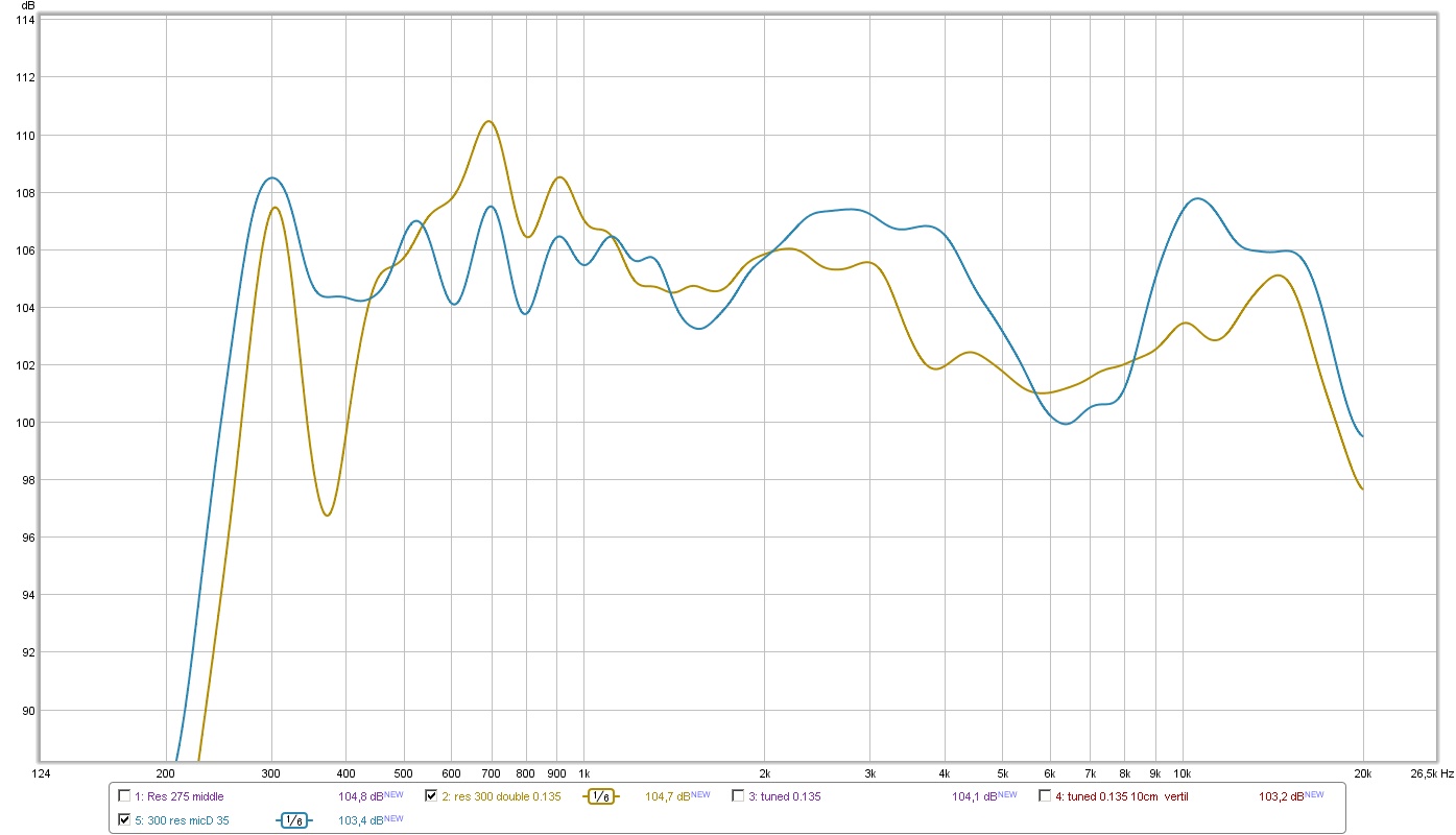

Then i bumped the mic 10 cm up so before i measured 1 meter away but exactly in the middle of the panel, now i measured 1 meter away but 10cm off vertical axis. (the panel is 60 cm long)
Pic 3 off axis vertical vs on axis. On axis (red) 10 off axis (brown)
What i think is weird they are mirror images at 2-3Khz and 4-9Khz, any one has a clue ? what is the real thing ?
Pic 4
I thought lets measure the thing in the midle of vertical axis 1 meter away and once in the middle 2.5 cm away.
1 meter away (Red)
2.5 cm away (Green)
so this weird mirror thing disappeared up close, so might that be a problem with the baffle width or the shape ? it still does not reach 20khz as seen but at least it looks a bit more solid so far.

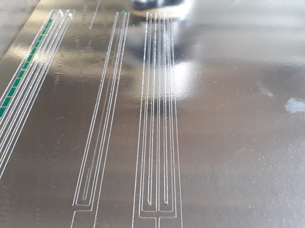

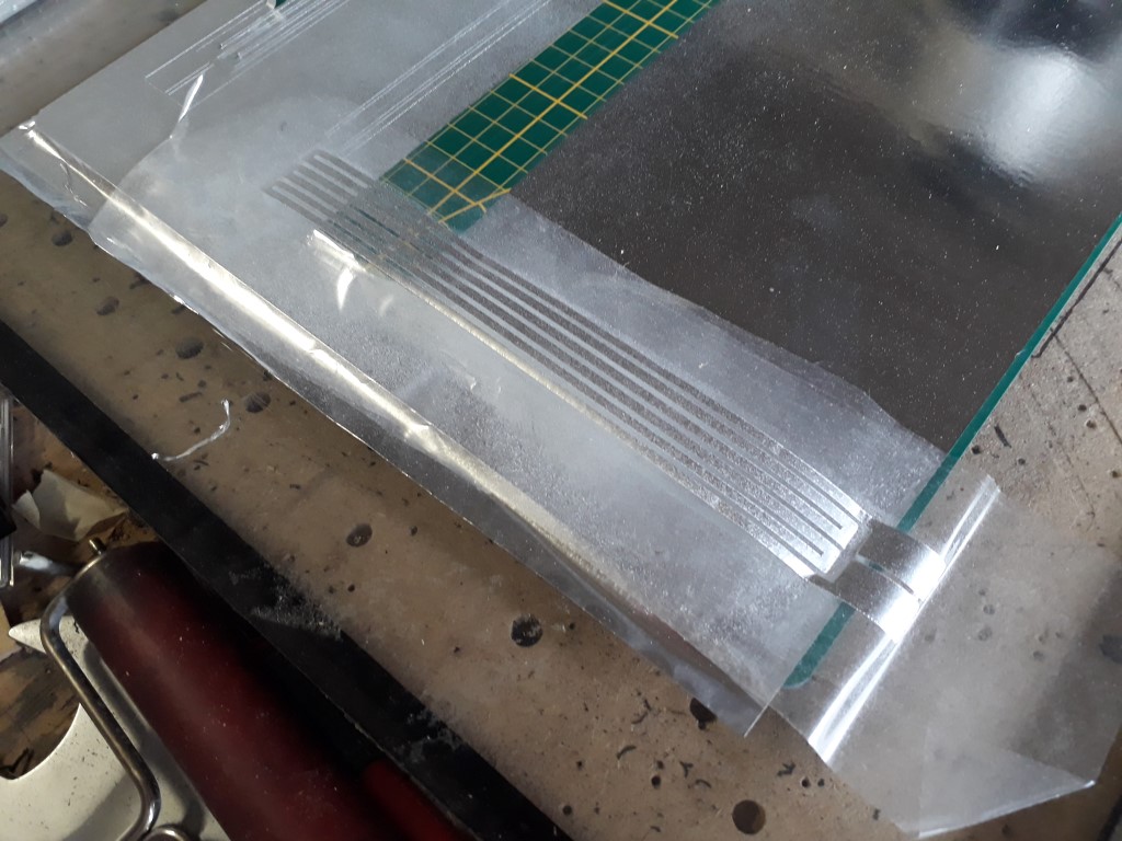

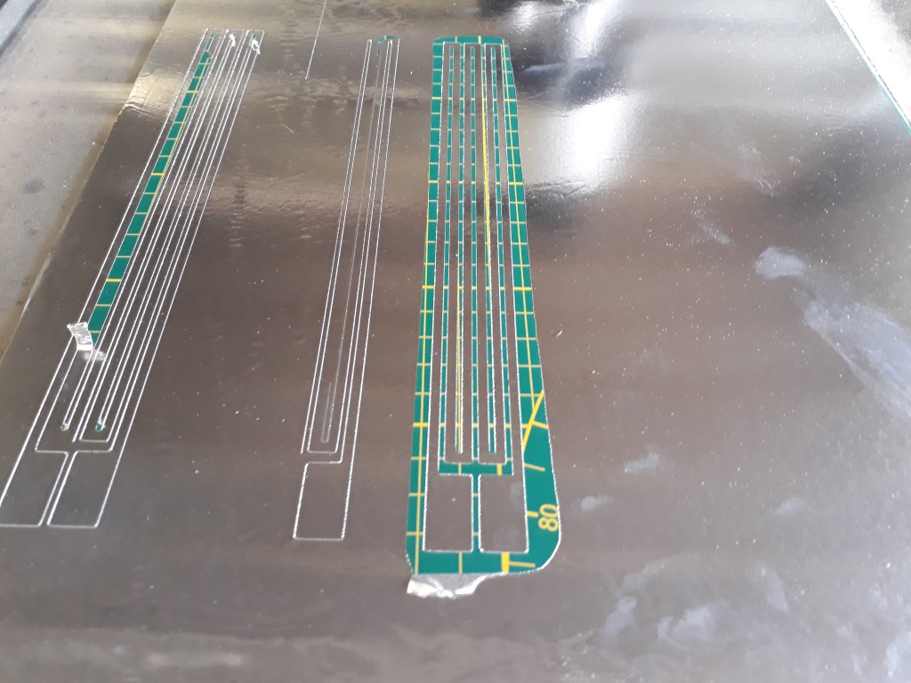

Okeeeeej another day another try.. so i went into my shed got my plotter knife out, since i made some sort of sled for plotting with a marker, i though i might give the cutter another go since that one failed always. so i first screwed up my knife within 5 second by cutting alumnium foil on a glass plate.....
i went to the shop to get a A3 sized cutting mat(the biggest i could find 🙁 ) i want A2 or 1. but hell it is just a test it might still suck.
So i cutted a small coil and the result is rather ok i still have to find a nice way of getting the foil flat on the mat (i used single side spray glue on the foil only) and a way of transferring it. (maybe with transfer paper, transparent would nice to be able to line it up).
as transfer stuff i used some mylar with spray glue on it, but it would not grab the foil hard enough 🙁 so i had to spray on the alu to. but now it is ofcourse more stuck then i wanted haha. so since i managed to make some tears in my 3 micron on the tweeter, i thought **** it ill just mount my transfer mylar with coil and all into the damn thing. so tension is not perfect but i hoped i could get at least some measurement results.
Pic 1 coil just cut
pic 2 coil without inner parts that i dont want to transfer (should have vut an ouline as well as you can see, first time using a cut plotter so)
Pic 3 coil on the transfer paper
Pic 4 A really ghetto tweeter just stuck in there 🙂 1/3 of the complete tweeter length. but hell should give me some results, probable less low end though.

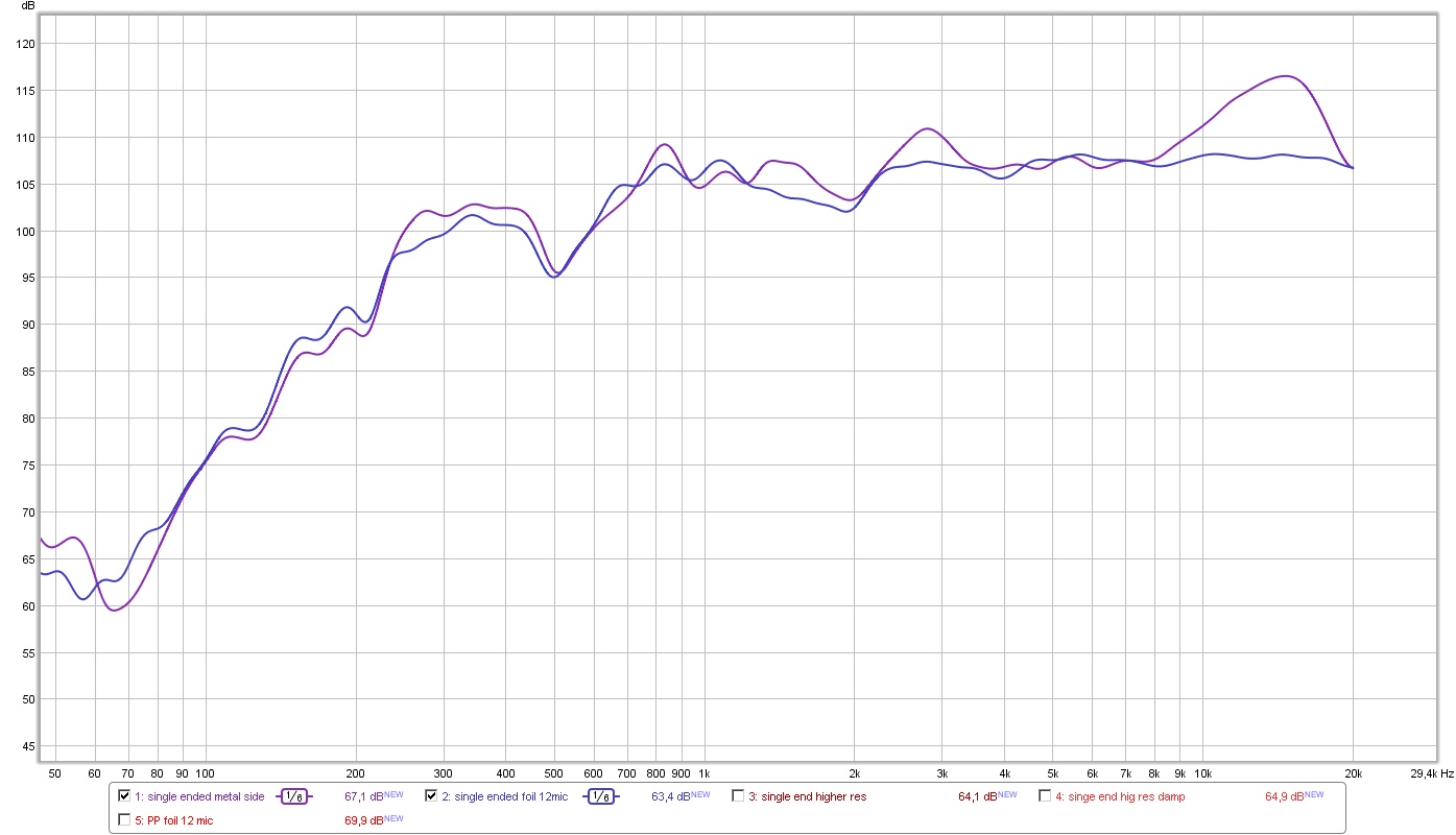

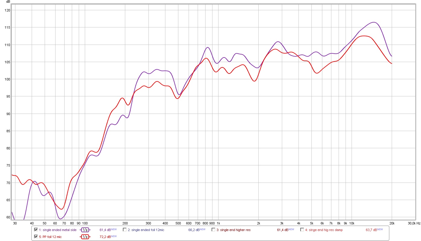

Then the measurements
Pic 1
Measurement single ended metal side(purple) Vs Push Pull(red) some how the single ended ended up being louder.... something goes wrong there. but really have no clue what. the magnets are still aligned as far as i can see, and feel.
another ansty thing is PP looks worse.
Pic 2 Single ended metal side Vs single ended Mylar side.
UHm wtf, i dont need to say more i think for this picture. Blue is mylar side Purple is metal side
Pic 3
I increased resonance a bit compared to Blue it boost the mid range a bit more (dark red) but it also creates the peak in the high frequency.
i then added some felt on the backside of the panel on the metal. and we got curve light red. it is smoother as blue but it is also less flat. but i am rather sure it becomes flatter if the panel becomes vertically larger. Light red with dampin has lower distortion as the undamped blue curve. as expected.
so... although i did not manage to get it to work in push pull config. it still is way better then i ever achieved in single ended as well. no clue why it worked flawless this time. might be the combination of all things i changed. since i tried foil before without much luck.
i can live with all of the 3 curves above 🙂 measured at 1 meter

By the way the cuts are not perfect since the software is not compensating voor de blade turns. its just a normal cnc Gcode. there is plugin to do it correct but i have to buy a new cambam first.... soooo i think ill have it like this for a while haha

The way a planar ribbon measures is the result of several different aspects of the design.
1) The diaphragm and magnet structure transparency I mentioned previously adds a peak at the top end of the response.
2) The dimensions of the planar will determine if it will radiate like a point source, an infinite line source, our something in the middle (finite line source) which tends to have awkward shifts in response throughout the midrange with changes in distance and position along the ribbon length.
3) If your baffle is thick like you show in post #32, the slot of air can add an additional resonate peak.
4) The baffle edges will add their own peaks and dips from diffraction. The baffle you show in post #32 looks pretty good, having the baffle extension to the left and the right of the ribbon of different lengths will minimize the magnitude of the peaks and dips.
With all of the above in play, it can drive a man to drink trying to understand why a particular ribbon measures the way it does…especially when changing the mic position in distance or height can show completely different behavior as you have found out. All I can say is that to develop an intuitive understanding, you have to experiment by changing one thing at a time and take careful notes on a range of data so you can see the trends.
1) The transparency model was developed for ESLs, so it assumes a uniformly distributed mass and driving force on the diaphragm. Using spaced wires results in more complicated behavior …looks like multi-resonances in the top octave. But, the planar built with aluminum foil in post #38 has a single well defined cavity resonance like the Neo8 and ESLs. The dimensions you sent me are summarized in Attachment #1. Since the magnets have to add thickness, and the wires or aluminum foil will always be much heavier than the mylar, I don’t think it is possible to push the cavity resonance of a magnetic planar above 20kHz. Even with ESLs this is sometimes difficult to achieve. I am not a ribbon expert, but it seems the best approaches for a smooth top octave without resorting to damping material are to use a single ended approach, or increase the % open area as much as possible to reduce the magnitude of the peak. I am working on a simple Excel modeling tool for this so you can play with the dimensions yourself. I’m pretty sure you will come to the same conclusion.
2) You wondered in post#32 why the response changed so much with small movements of the mic along the length of the ribbon. It is because of the difference in distances from the different points along the ribbon to the mic causing phase cancellations at different frequencies. You can use the EDGE diffraction simulator to play with this. I usually export the data to Excel so I can normalize all responses relative to the on-axis response. I took your measured data and performed the normalization so It could be plotted along with the theoretical resultsAttachment #2 & #3. You can see they match pretty nicely. Tomorrow I will post a few sets of plots showing different trends for line source length and distance that you may find helpful.
3) Attachment #4. is an example of the type of resonate peak you might expect to be added by the slot in your thick baffle in front of the ribbon. In this case, I used Hornresp to model response with and without the slot.
4) Most people are already familiar with diffraction from baffles and how it affects the response. If needed, I can provided some links on the subject.
