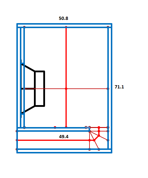

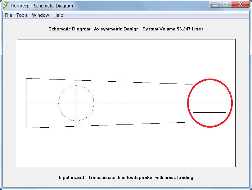

Right, and the mass loading stems from the ports air mass, correct?Technically it's a OD-MLTL
Exploitation of box modes. A standard ported box doesn't do this.what designcriteras needs to met for calling it a TL,
Right, it must be a high enough aspect ratio for 1/4 WL pipe modes to damp the vent enough to make a measurable difference to a lower Fb, so varies based on desired tuning, otherwise it's presumed to have a ~uniform particle density.

If you adjust for the end correction and set QL to lossless as shown in the attachments, the results become effectively identical, with the fundamental frequency being 42.4 Hz in each case.
Yup, but it does raise the question of which of those two models will more accurately predict the response of the attached system, without having to adjust any of the dimensions involved. I do know that the standard OD model did a very good job of predicting the Fb for both my POC6 and my "Boom Unit" builds.

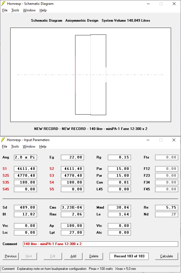

David, for those of us that are mentally challenged enough to not understand all that fancy wizardry you've put into the more recent revisions, but instead just want to hammer some digits directly into the designated fields.
I am having some difficulties just adding the port information like you did, it just becomes an open hole?
Obviously I'm doing something wrong, but I am unable to understand exactly what that would be.
Anyone got any tips? I tried it in a number of different "driver entry point" settings etc.
Could well be that I need to revise my workflow, I just really like to tab around and use the numpad. No need to move the hand to the mouse and back constantly, fiddling with sliders that are a pain to get "just so". Numpad FTW!
Specify the loudspeaker configuration as OD not Nd, and also specify a closed mouth.

Not near a computer right this minute, but I like to run the same sim as ND and OD to check for discrepancies. It's just numbers and default is front firing port which is my personal preference anyway so... Low frequency should be correct at least, will just add this as a single step further at the end. Thanks!Specify the loudspeaker configuration as OD not Nd, and also specify a closed mouth.
