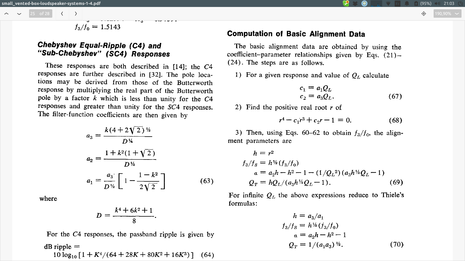

Has anyone tried making a small program to predict alignment of vented box by changing the coefficient, I am trying one from the appendix of paper by Small. In the paper it is said to find the positive roots of 'r' but there are four roots which one should i use?. The biggest, smallest or should use any one of the positive value?
