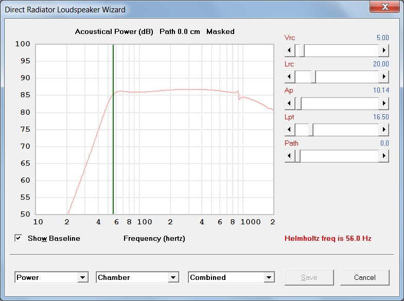

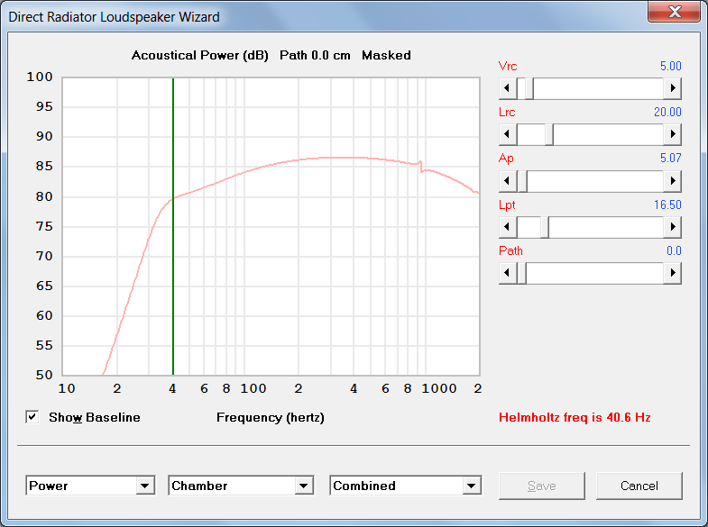

Attachment 1 shows the power response of a bass reflex loudspeaker having the above dimensions and a MCM 55-1853 driver. The fundamental resonance frequency of the system is closer to 40Hz than the desired target value of 60Hz. Attachment 2 shows the "flatter" power response obtained by simply doubling the port tube cross-sectional area Ap to move the fundamental frequency closer to the required 60Hz.
