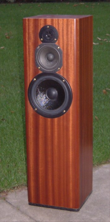

I simply used iron on veneer, the heat from the iron has the side effect of softening the wood allowing you to gently form it aroud the edges. the glue is that thick stuff that fills the imperfections underneath so long as they arent too nasty
here's what I did, no radii on the top. but a 1" rad on the side
Andy
Andy
