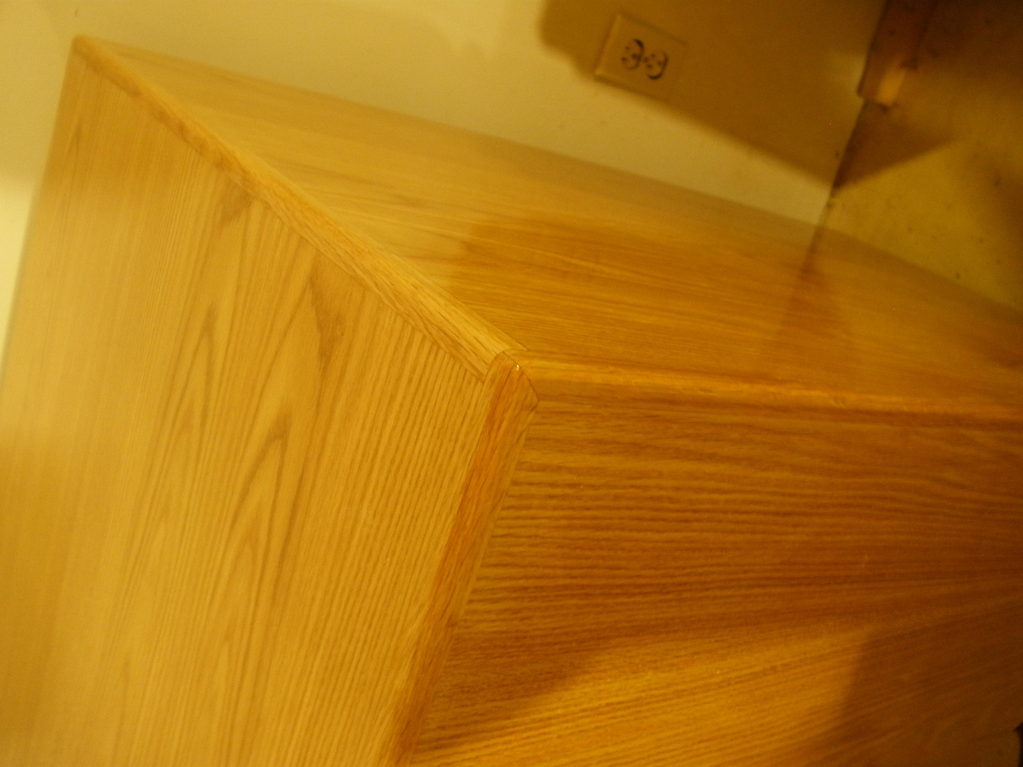

here is a cabinet I made with 1/2 inch oak plywood glued on a 3/4 inch fir plywood box before routing. I used 1/2 inch x 1/2 inch solid oak for the corners.

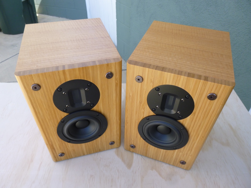

I've accomplished the cut on a few speakers using a Whiteside router bit.
Thanks for the tip on the Whiteside bit. That one looks real promising.
