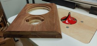

I have a lot of woodworking and furniture building experience, but mostly in solid wood... I am new to veneer. I have a problem that has stumped me.
Let's assume I have a baffle of MDF or plywood, and I have cut my tweeter hole of 75mm, and I cut a 3.5 mm deep recess for the tweeter flange which is 105 mm diameter.
Now I veneer the baffle. How do I cleanly cut the veneer to match the recess? The depth of the recess is only 3.5 mm (about 5/32 inch), so I don't see how I can use a laminate trim bit. I also struggle to see how a veneer saw or utility knife can negotiate the inside curve of a 4 inch circle and make a clean cut...
One solution is to veneer before cutting holes... but that seems like the wrong order. I generally cut driver holes early in the process, and veneer at the end... ???
Obviously I am missing something... thoughts?

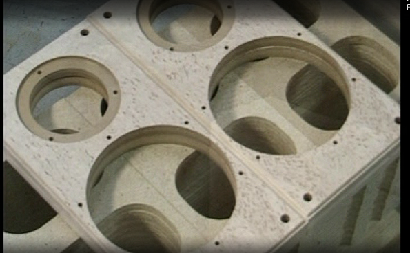

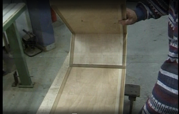

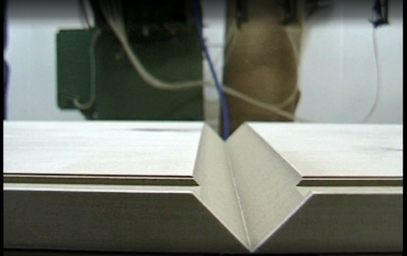

To veneer before cutting and routing is the professional way. Do whatever suits your skills and machinery better. Interesting to watch the "Dynaudio factory tour" promotional video that used to circulate on dvd's in the early 2000's.
edit: baffle gets in the groove you can see in 1st and 2nd photo.

You have to reconstruct the center point to guide your router.
Hold a piece of scrap wood behind the cutout and trace the hole shape onto it with a very sharp pencil. Remove the scrap and find the EXACT center of the hole.
To do that draw several chords at various points of the circle and then draw the perpendicular bisector for each chord. They should all intersect at a single point and that is the exact center of the circle.
Use a compass to draw a circle from the center to the existing diameter. The two diameter traces should line up perfectly.
Use a drill press to drill a very small hole through center of the scrap piece. Use a compass to trace the cutout diameter onto the back of the scrap piece using the through hole as the center.
Cut a piece of scrap wood that is slightly smaller than the circle and the same thickness as the baffle, and glue it to the back of the marked up scrap so that it is within the circle area.
Go back to the drill press and now continue the center hole all the way through the second glued on piece.
Temporarily attach the scrap to the back of the baffle with extra glued on piece protruding through the cutout, and aligning the circle back up perfectly with the cutout.
You have now reconstructed a center point for your router.
Now use the same router/bit combination that you used to cut out the driver bezel recess initially to remove the veneer.
before you veneer, attach a board behind the front bafle.
using high school gometry find the centre of the tweeter hole and mark it on the board behind the baffle.
use a compass to verify you have the exact centre.
drill a small hole in the centre of the board.
veneer the front.
drill a hole in the veneer using the hole in the board as a pilot
use a circle jig and router to remove the rest of the veneer.
You could also use a hand held dremmel tool with a small drum sander on the dremmel to remove the veneer after rough removal of the veneer.
When I built my first speaker project, I cut the driver holes in the baffle first, then veneered. I covered the whole baffle in a sheet of veneer, making a slice across the grain of the veneer over each hole to avoid splitting. After the glue had cooled, I then used a sharp craft knife blade to cut round slowly and carefully through the veneer at the edge of each hole. This gave good enough results for me - YMMV!
Alex

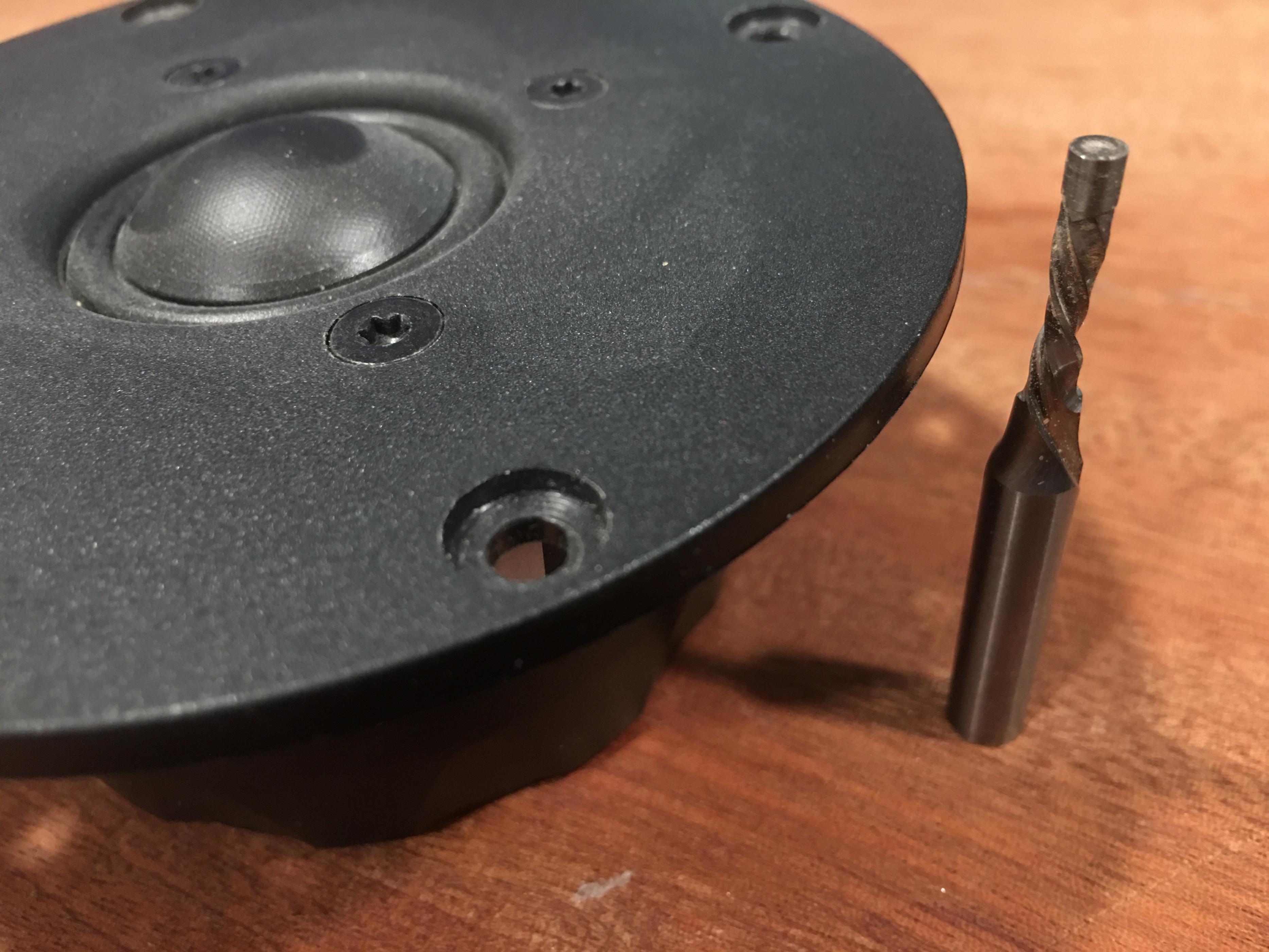

Purchase one of these solid carbide bits, then grind down the end, allowing you to use this to follow the existing cutout.
That is a good plan. I have never tried to grind carbide, but I have a friend who is a machinist.
Making a new center hole jig for guiding a router is not really that big of a deal. It only takes a few minutes with the process I described and you can use the same jig for both baffles.
Yes, I know... I was hoping for something more turn-key... It's like doing a mortise and tenon joint. There are multiple ways to do it, but none of them are fast...

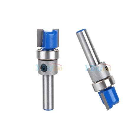

..as an alternative to post #12, there is yet one more way......
Fabricate a thick (MDF works well) template with a hole the same size as the tweeter flange, then use a top bearing bit to trim the veneer....the bearing rides in the hole of the template.
.....of course you will have to attach and center the template on the baffle.
