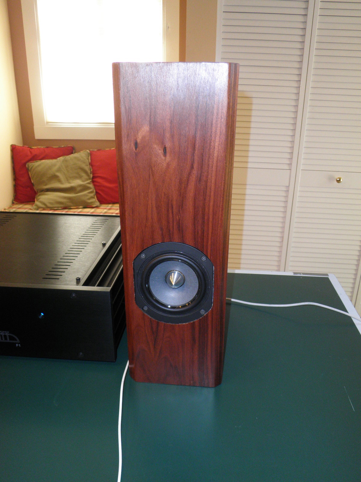

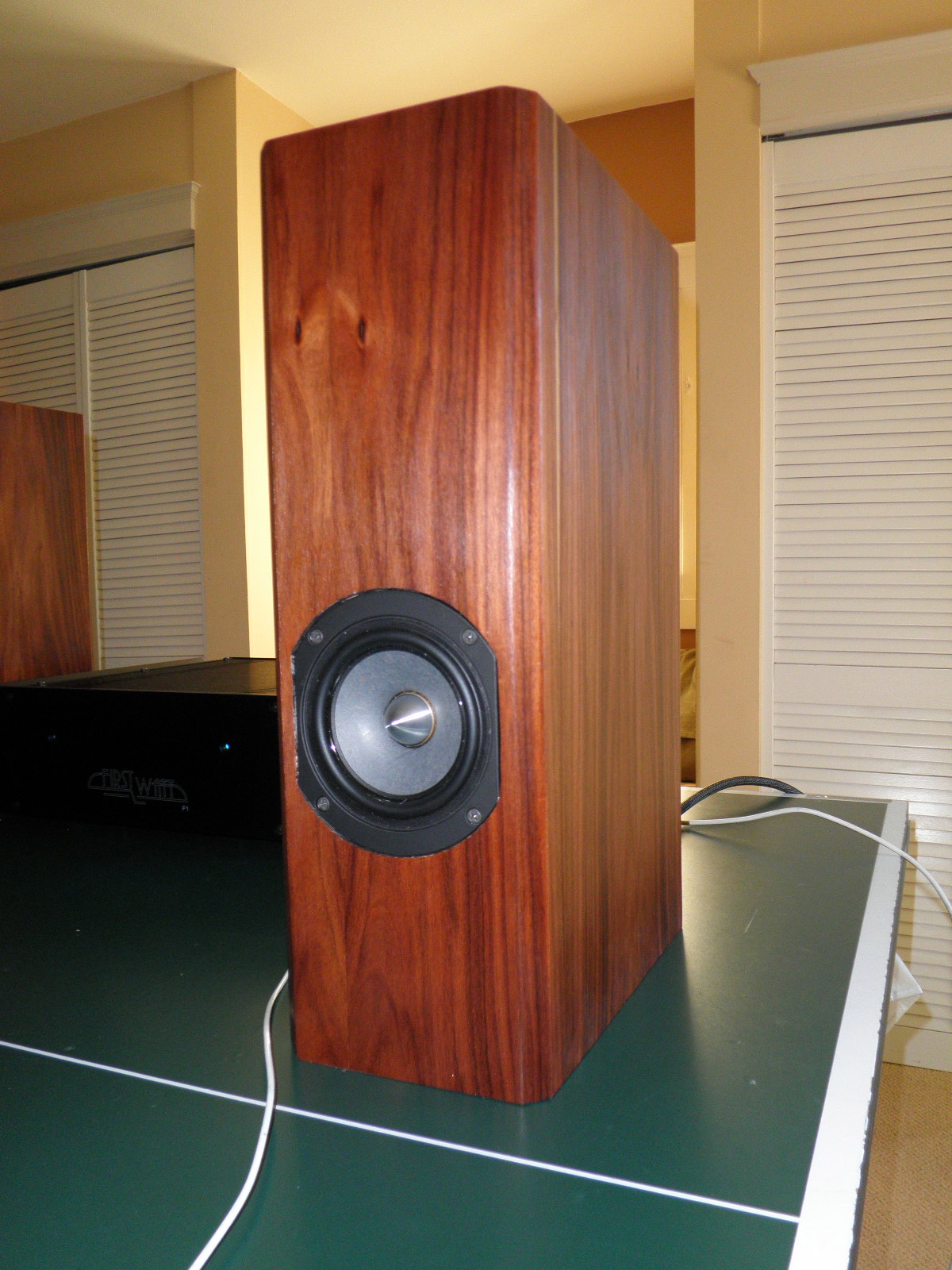

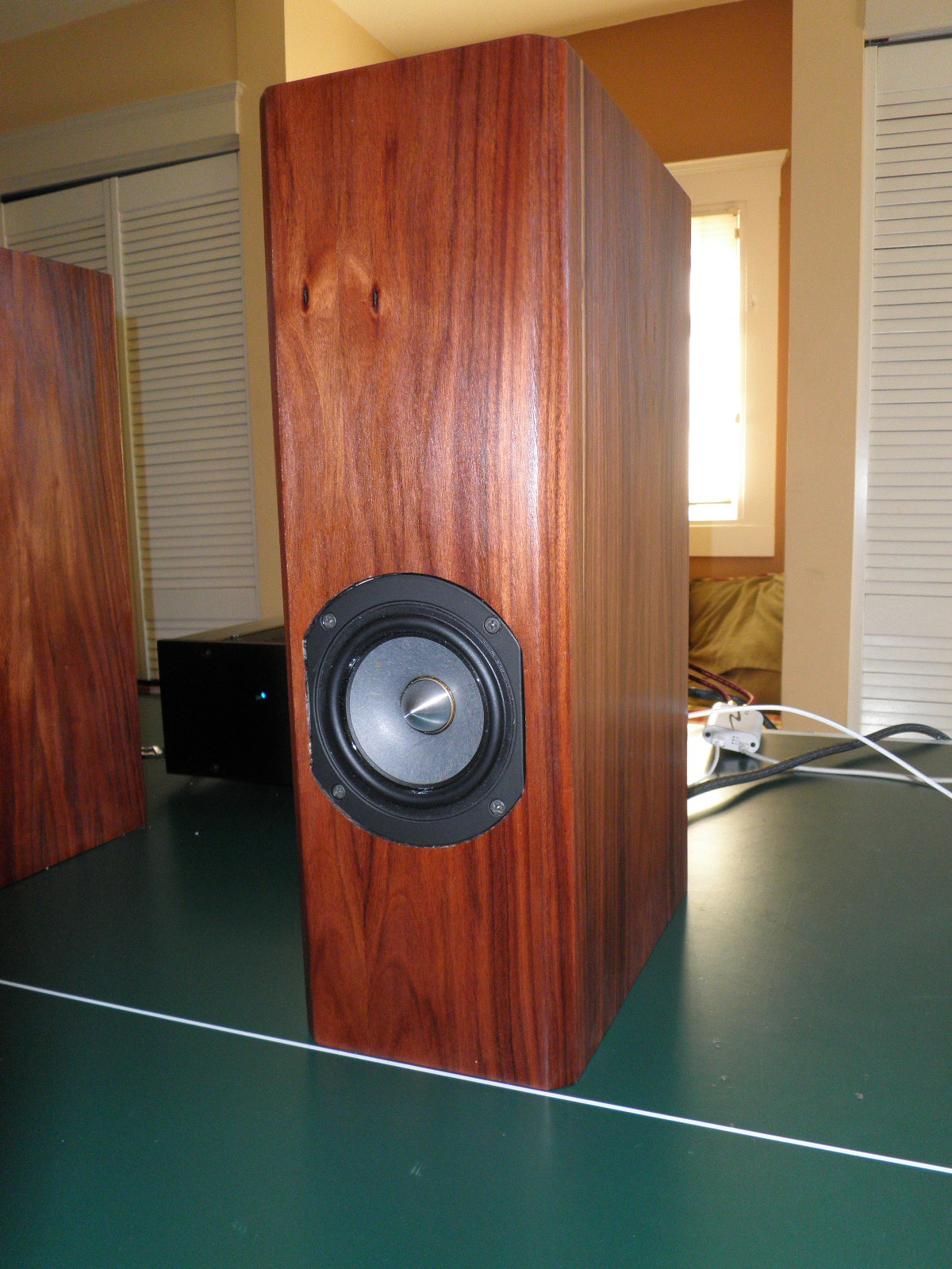

These folded TABAQ TL's use TangBand W4-1320SJ's and are veneered with South American, quartered 10m paperback rosewood...the photos don't really do them justice IMHO. After a couple of earlier attempts, I've gotten the hang of this jellied polyurethane/tong oil/mineral spirit finish...after rubbing it in can't let it set more than a minute or so before the straight, with-the-grain final wipe. No problems with WAF.

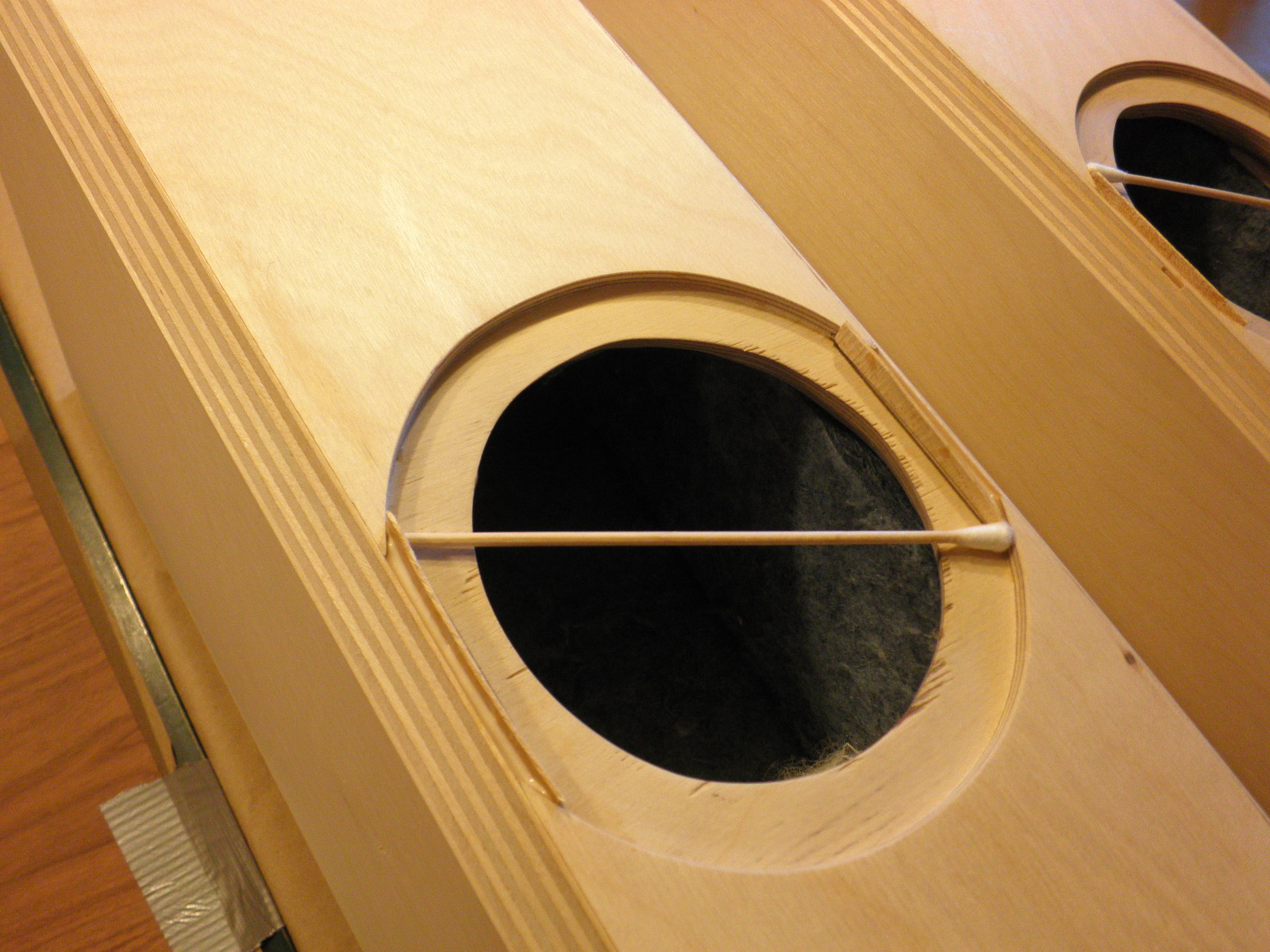

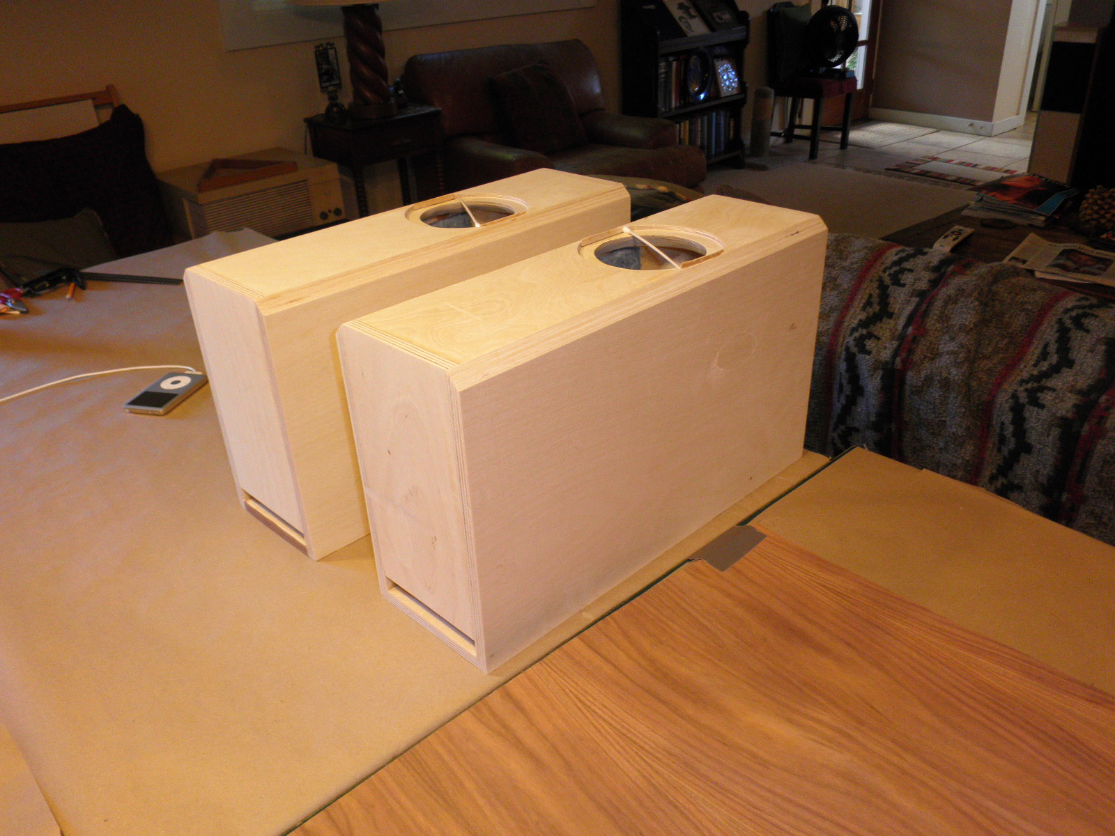

I used a small palm router to recess the front baffle with a complete circle and truncated the sides of the recess with small strips of wood. The small voids on the sides were then filled with wood filler and sanded down flush. I do need to create a driver gasket, however, to bring the drivers out a couple mm as currently they're a little too recessed.

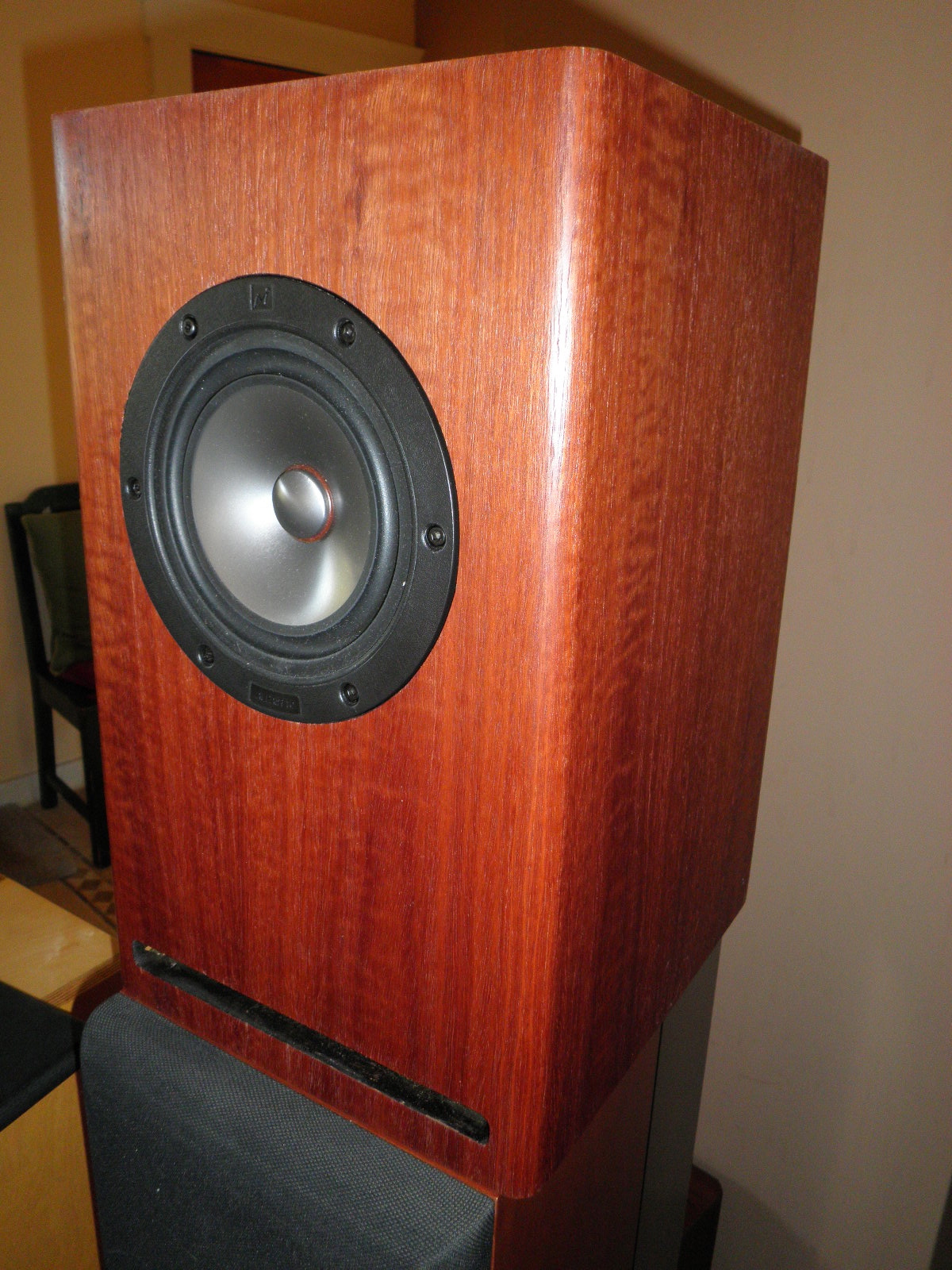

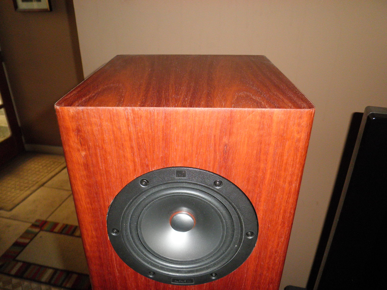

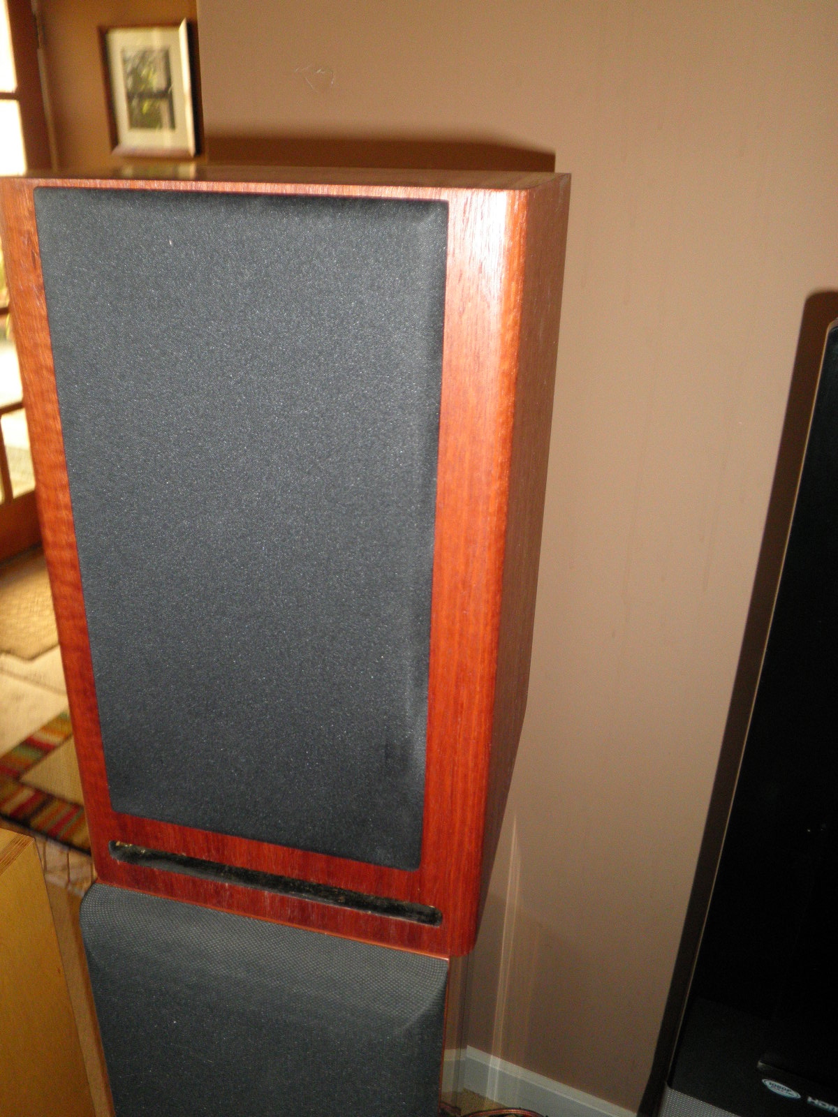

I've finally used all four veneers that I bought some time ago! The Jarrah veneer was unexpectedly much harder to cut and trim than the other veneers I worked with. I used this on a pair of Alpair 10.2 TwinAudio cabs that arrived via post pretty badly beaten up...the return would have cost me much more than the price paid for the veneer.
So I filled (a lot), sanded and routed a .5" radius on the baffle edges. Magnets were placed before veneering so I could use standard PE grills. I'm pleased with the outcome but I'd like to eventually rip out the foam lining that came with cabs and replace with Ultratouch. On samples I found that plain wipe-on polyurethane highlighted the grain better than the polyurethane/tung oil/mineral spirit mixture used on past projects

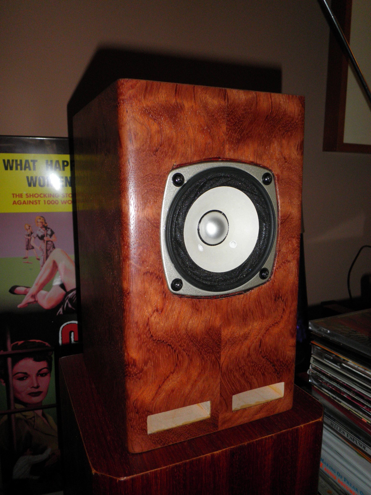

The other pics are uFonken veneered in Bubinga Burl which was the easiest (so far of 4 veneers tried) to cut and wrap across baffle edges. Contact cement, veneer saw and the above described finish mixture were used.
