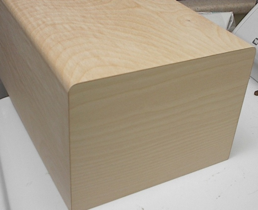

Here's a recent veneer job using paperback veneer and contact cement (Lepage's :up: ). This looks good to me, it's not going anywhere either. More here
