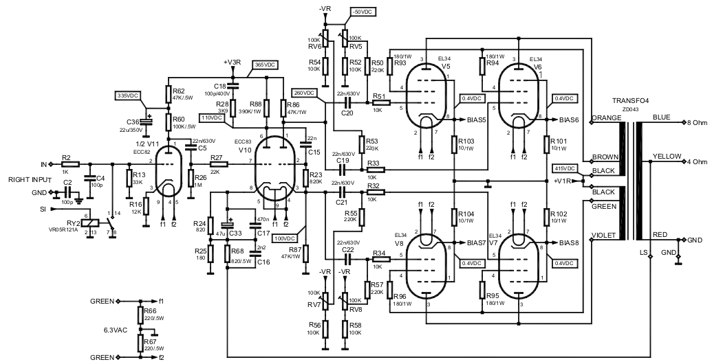

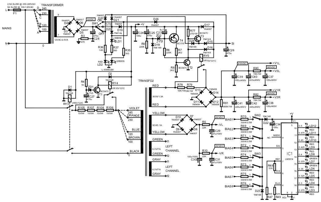

K4040 schematic and output and power transformers
The schematic for the K4040 is quite conventional: Two triode amplification stages, a cathodyne phase splitter, and a big and hot qual of EL34s in untralinear more driving the output transformer. The feedback is fed into the cathode of the second triode stage; the whole amplifier is inverting.
The output toroidal transformer has Raa of 1800 ohm (15:1 turn ratio between anode-anode primary and 8ohm secondary). The ultralinear taps are 33%. The secondary has a 4ohm tap that is also used for feedback.
The power supply has a whole bunch of nice features not frequently seen in pother designs. It includes:
  • A separate standby power supply based on a separate small PC mounted transformer (in the upper left corner of the power supply schematic, marked "TRANSFORMER")
  • A thee way switch selecting between OFF (only standby power is live), STB (main power TRANSFO2 transformer is live, heaters are on, but anode supply is reduced) and full ON
  • Soft start (Q1)
  • Delay between powering on heaters and applying full anode voltage (Q2-Q4); it also controls the muting relays that short the amplifier's input
  • Output tube bias meter based around LM3914 and a LED array
The main power transformer is quite beefy - 300V secondary is rated at 1.3A and provides 415V DC unloaded (but only about 380V) under load, and two heater secondaries rated for 7A each can power two quads of KT88.

K4040 IronAudio mods
Over the years, there has been a lot of discussion of what to change in the K4040. One of the more comprehensive lists was posted in 2001 on ironaudio.com, now defunct. The list is still available on web.archive.org (thank you gemenakis for providing the link!), but here it is for your convenience:

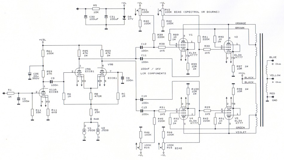

In 2006, ecsdesign published here on diyAudio a much more radical way to modify the K4040, which I ended up implementing. His original posts are here and here - if the links take you to a wrong place, they are posts #1029 and #1037 on the thread "Building the ultimate NOS DAC using TDA1541A".
For convenience, here is his first post (the second post will follow):
Little bit off topic here, since you are talking about tube amplifiers, guess what I have been doing? I needed a tube amplifier to test both the sonic resonators and the octal D-I DAC, but I didn't have one. I didn't want to spend a lot of money on a High-End tube amplifier, and there wasn't time to design one from scratch, so I decided to buy a K4040 kit (shame on me). I knew there were some design problems, and I might need to do some minor modding in order to get the sound right. Some JJ KT77's were ordered, just in case...
Then the kit arrived, it didn't have the ILP transformers I hoped for, the EL34's were from Svetlana, the ECC83's from Sovtec and the ECC82 from Electro Harmonics. The housing looked very impressive with the massive chrome plates, even the feet and the decoration rings for the tubes were chrome. It comes with a a huge single-sided PCB. I planned to use Beyschlag metal film resistors instead of the cheap carbon resistors, Spectrol cermet's for bias adjustment and Panasonic electrolytic capacitors. After a few hours the PCB was assembled, wiring the EL34 sockets cost a lot of time. Then it took me another day to squeeze-in the transformers and wiring as there was very little space.
I continued with the bias adjustment, there is a LED indicator for this, but it's readout wasn't very good, a lot of LED's burning and flashing at the same time, so I had to solder a 100nF across the LM3914 input to get it working correctly. Finally it was time to listen to this 2 X 90W rms tube monster, well in fact the sound it produced wasn't that good. Perhaps the Svetlana's needed some burning-in time, but after burning-in one full day without significant sound improvement I lost my patience. Measurements showed relatively high distortion and a huge peak at around 40KHz.
Next lot's of different tube brands were tested, but it became clear to me, the design wasn't optimal, so I could prepare myself for some serious modding. Starting with the input stage, what's a ECC82 doing here? I replaced it with a JJ ECC83 and changed the resistor values for maximum linear drive. A concertina phase splitter using a ECC83 to drive 4 X EL34 ?? out it went and replaced with a modified Schmitt phase splitter with a constant current source (2 X J508 in parallel) to ensure fully symmetrical drive. The ECC83 wasn't capable of driving 4 EL34's, so I replaced it with JJ ECC81. The EL34's were replaced with JJ KT77, next the 22nF coupling cap's were replaced with LCR 100nF/1KV polypropylene capacitors, yes tubee, coupling cap's can make a world of difference. Oh yes, the overall feedback was removed, only using local feedback. The bias voltage was stabilized with a 47V zenerdiode (22K series resistor lowered to 10K).
After these modifications there wasn't much left of the original K4040 design, but the sound quality was stunning, what a difference. The K4040 turned into a beautiful sounding High-End power amplifier. Distortion is much lower, it sounds crystal clear, transparent and open, with a deep impressive bass and a wonderful sounding midrange. Unbelievable what a few modifications can do.
Second post by ecsdesign on his K4040 mods:
The phase splitter used in the K4040 is often referred to as concertina phase splitter, when looking at the schematic diagram it resembles a cathodyne phase splitter. One output at the annode, one at the cathode. With this setup there are problems like low gain, linearity and load sensibility.
I used a Schmidt phase splitter, the modification is a added 4mA constant current source. The Schmidt phase splitter is very linear, easy to adjust, stable and has low distortion. The outputs of the Schmidt phase splitter are both on the annodes, the constant current source lowers distortion.
I added a schematic diagram of the modifications I made, this makes it a bit clearer, the same reference numbers were used where possible, but I may have missed one, only the left channel is shown. The following list gives a overview of the modifications made:
1) 100nF/63V capacitor across D23, this will suppress hum on the bias readout.
2) R5 and R10 lowered to 10K, C29,31 increased to 100uF/100V, 47V zenerdiode across C29 and C31 (cathode to plus), this will stabilize the bias voltage, regardless of transformer load.
3) High-quality potentiometers for bias adjustment (Bourns or Spectrol)
4) V11 changed to ECC83, improved sound quality (ECC83 from phase splitter can be used)
5) R61=100k, R62=100K, R59=27k, R60=27K, R11=6K8, R16=6K8, this will set the correct gain for V11.
6) C5=100nF/1KV, C9=100nF/1KV polypropylene (Farnell P/N 106367)
7) Cathodyne phase splitter replaced by modified Schmidt phasesplitter (see diagram). J508 and J509 are 2mA constant current sources (Farnell P/N 9549951). V9 changed to ECC81 (RS P/N 5011342).
8) C11...14, C19...22 changed to 100nF/1KV polypropylene (Farnell P/N 106367)
9) RV1...4, RV5...8 changed to Bourns or Spectrol.
10) R89...96 changed to 1K Ohm 1W.
11) R32...34, R51, R29...31 and R38 changed to 1.5 K Ohm.
12) Overall feedback removed, only using local feedback.
13) Svetlana EL34's replaced by JJ KT77, clearer sound, better bass and trebles.
14) 3.3nF/5KV capacitors were placed in parallell with D11...D14 to suppress switch noise.
15) ZD1=3.9V zener instead of 7V5 (solves mains brownout problem, this is already modified in new kits)
The EL34 sockets may cause bad connections when a tube with bigger pin diameter has been inserted once, due to bent contacts, pin 5 should be checked carefully as it is also used to set the bias current. Higher quality tube sockets could be used.
All carbon film resistors were replaced with Beyschlag 1% metal film resistors for stability and lower noise.
Always be carefull working on high-voltage circuits, wait until the electrolytic capacitors are fully discharged. When modifications are made, always double check before switching-on the power.
Finishing touch, the chrome decorative rings may scratch the large chrome plate, so I applied protective self adhesive polycarbonate sheet (used to protect front panels) to avoid scratches.

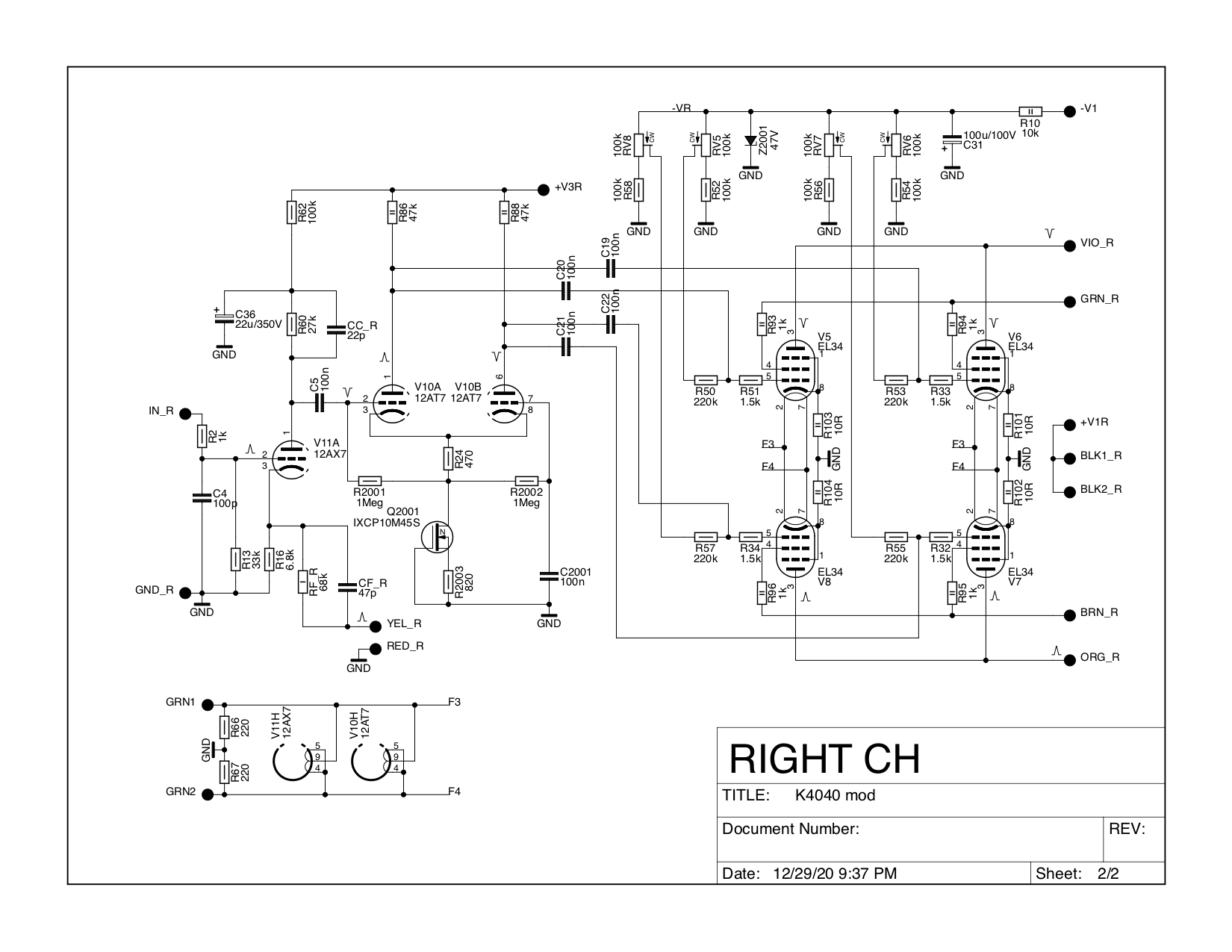

Fix : jumper the wipers to the -VL end of the pot, probably decrease
the series resistor by a parallel one if the adjustment range suffers.
Edit : additional resistors in series from -VL to pot are required also.
ecdesigns's modification removes the global feedback from K4040. Without feedback, K4040 has a higher input sensitivity, more hum and noise, and depends on matching the output tubes between the channels.
There are two ways to re-introduce global feedback after ecdesigns's mod:
  • Apply it to the grid of V9B (see the schematic attached to post #12) by lifting the bottom end of CA from the ground and connecting it to the feedback divider. This option is easier to wire and has less stability issues, but it does not enclose V11 in the feedback loop and, as the sensitivity of the rest of the amplifier decreases, makes V11 work harder, increasing distortion.
  • Apply it to the cathodes of V11. This is trickier to introduce from the stability viewpoint but improves overall linearity.
Either way, one needs to pay attention to the phase - depending on how the phase splitter is wired, the output transformer's primaries may need to be swapped (which is very easy to do).
I tested both and ended up implementing the second option. Attached is the final schematic. CF (47pF) helps to improve the phase margin. CC (22pF) was required for stability of the left channel, which is connected to V11 via a long trace across the PCB, with two wire jumpers.
With feedback, the distortion and hum are reduced, and the sensitivity in in line with the sources like CD players, giving 2Vrms full scale.

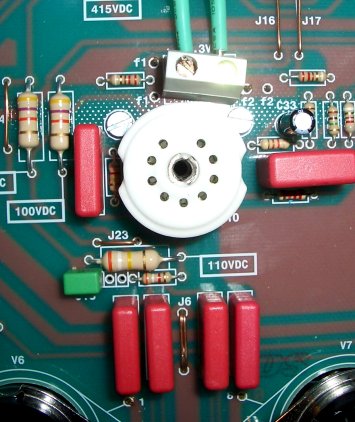

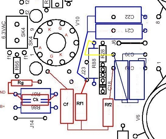

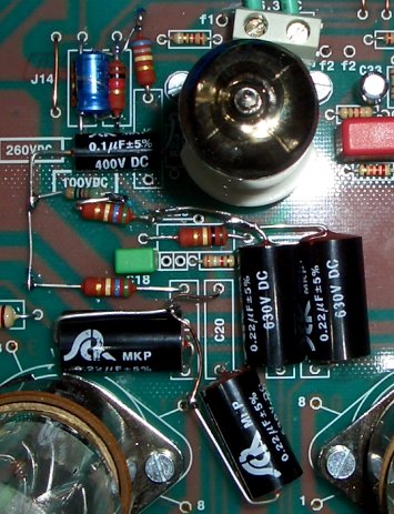

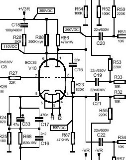

In 2005, Jan Veiset published a different way to modify the phase splitter. Unfortunately, his website (www.veiset.net) is gone. A copy is available on web.archive.com, but it is in Norwegian with black letters on black background 😱
Here is a slightly edited Google translation:
Original circuit description

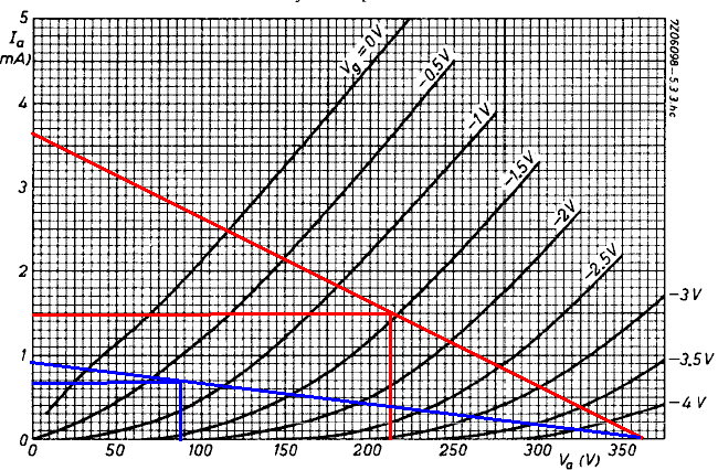

The phase inverter is built around the double triode ECC83. The first half is used exclusively for gain, just under + 40dBu, and the other half is a split-load phase inverter. The advantage of split-load is that it is a simple and tidy construction, and they are easy to balance. The disadvantage is the lack of the ability to deliver (high) voltage.
A slightly more technical review
The triode that works as an amplifier has the following working points: Ia = 0.65mA, Ug = 0.65v (blue curve). The stage works with a relatively high anode load, 390k and the input impedance to the next step is very high, partly due to positive feedback. All in all, the stage works atop maximize the gain.
The next stage is a little harder to understand. It is basically a completely traditional split-load phase inverter, but without the negative bias on the grid! Although the grid leakage is not very high (820k), it is possible that negative bias builds up when the signal is applied. In any case, it looks like this half of the tube is running very hard. Which is also necessary to be able to deliver enough voltage to the output stage.
For driving of the power stage (4xEL34, B+ 420v) approx. 25 volts RMS is needed. If we add 50% to the headroom, the phase inverter should be able to deliver around 37 volts RMS or 100 volts p-p. Both theory and measurements show that the stage has very small margins. The phase inverter is and will be a bottleneck in this construction.
New phase inverter

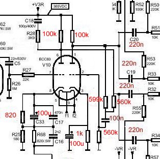

To avoid too many changes, I keep ECC83, move away from the split-load inverter and replace it with a paraphase splitter. The static working point is the same for both triodes, Ia = 1.4mA, Ug = 1.4v (red curve). I lose some gain, estimated gain with R1 in the next stage around 130k is about + 33dBu or a loss of about 6dB compared to the original solution. Umax is designed for 40v RMS with Ub = 365v.
At the same time I change the coupling capacitors from 22nF to 220nF. This will lower the open loop frequency response from around -3dB @ 30Hz down to -3dB @ 3Hz. Hopefully this gives better control in the bass area.
Practical implementation
The practical implementation was easy, as I had prepared by drawing the new components on a copy of the top of the PCB.
After some soldering work, it was time for measurements. The result was above all expectations, about 55v rms before phase splitter clipping. That is, there is plenty of headroom here.
Picture before and after are attached.
Working drawing
Here is the working drawing I worked from. If you want to upgrade the phase inverter in your K4040, it should work well if you follow the following recipe:
1) Remove the following components:
J23
R86, R87, R88, R23
C15, C19, C20, C21, C22
2) Cut the PCB trace between R87 and C19 / C20
3) Fit the following components:
Rg (680k)
R86, R88 (100k)
R87 (1k)
Rf1 (593k 560k + 33k)
Rf2 (560k)
C19, C20, C21, C22 (220nF)
Cf (100nF)
Ck (100uF)
4) Connect R88 and C19 / C20 on the underside of the PCB (yellow line)
5) Do the same for the other channel.
6) Screw the amplifier together and turn up the volume.
