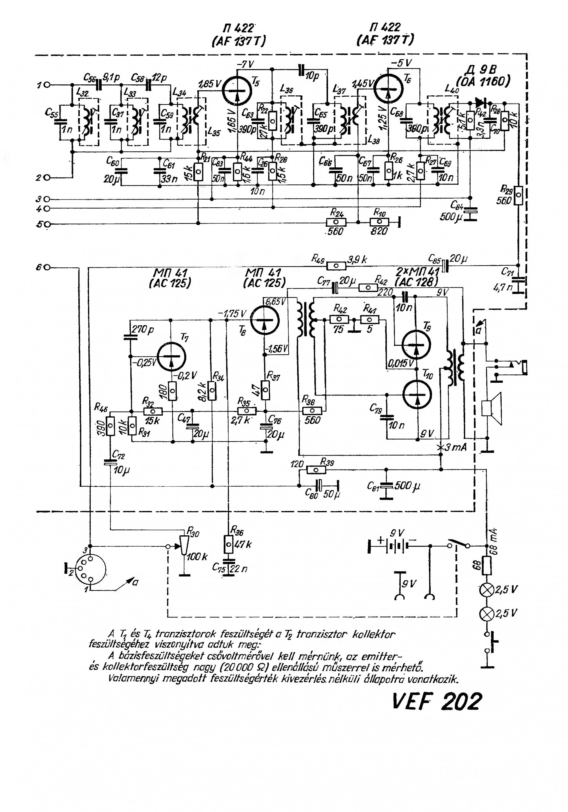

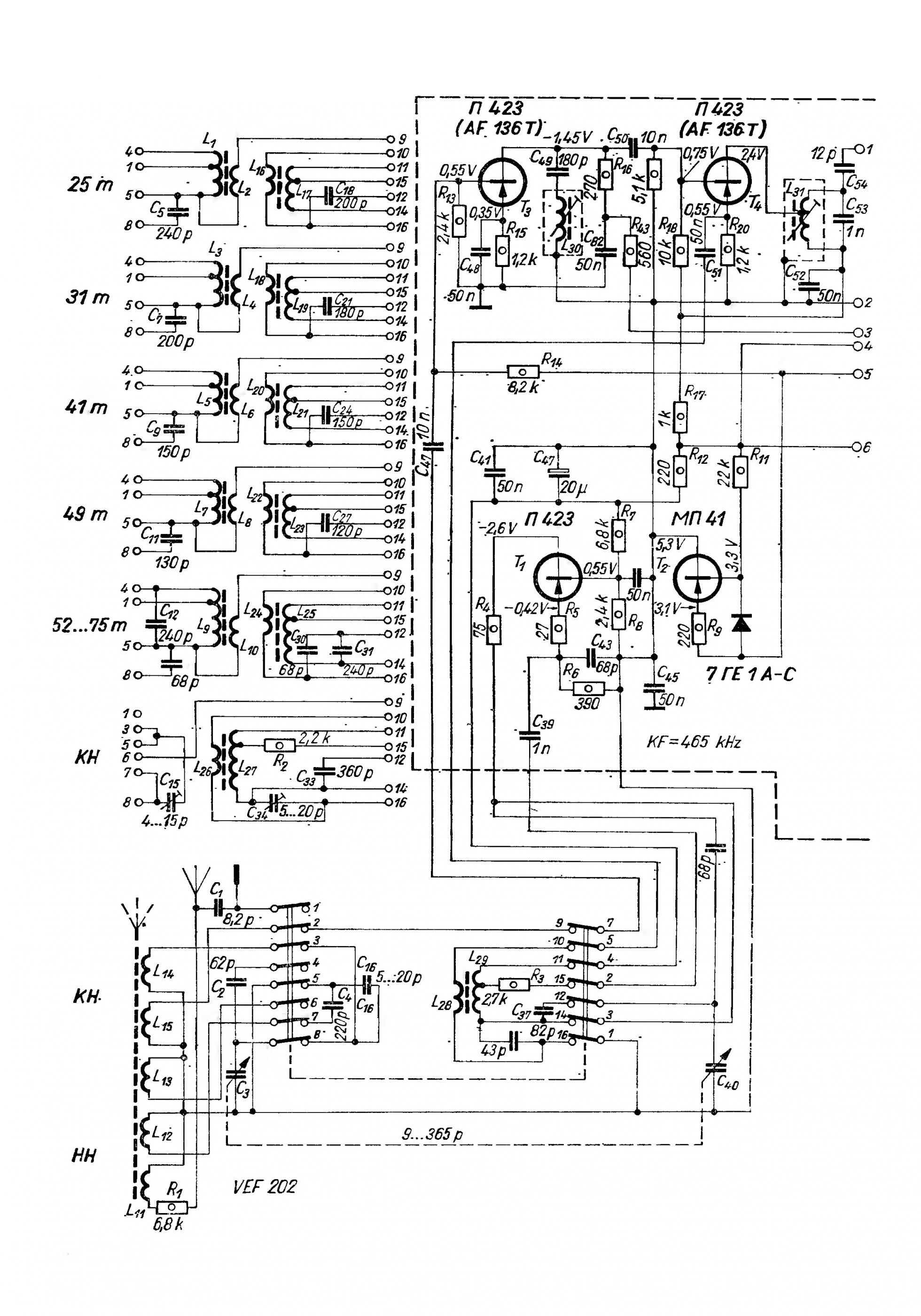

Here is the diagram:

Sounds like modulation noise , this can be attributed to many causes like IF instability due to failure of IF bypass capacitors, excessive gain of IF stage due to failure of the IF bias resistor/capacitor , misaligned IF transformers ( peaked too sharpish ) there is a lot more........ including the IF wavetrap and bad image rejection .
Thats just the start.
Start by concentrating on the IF section .
