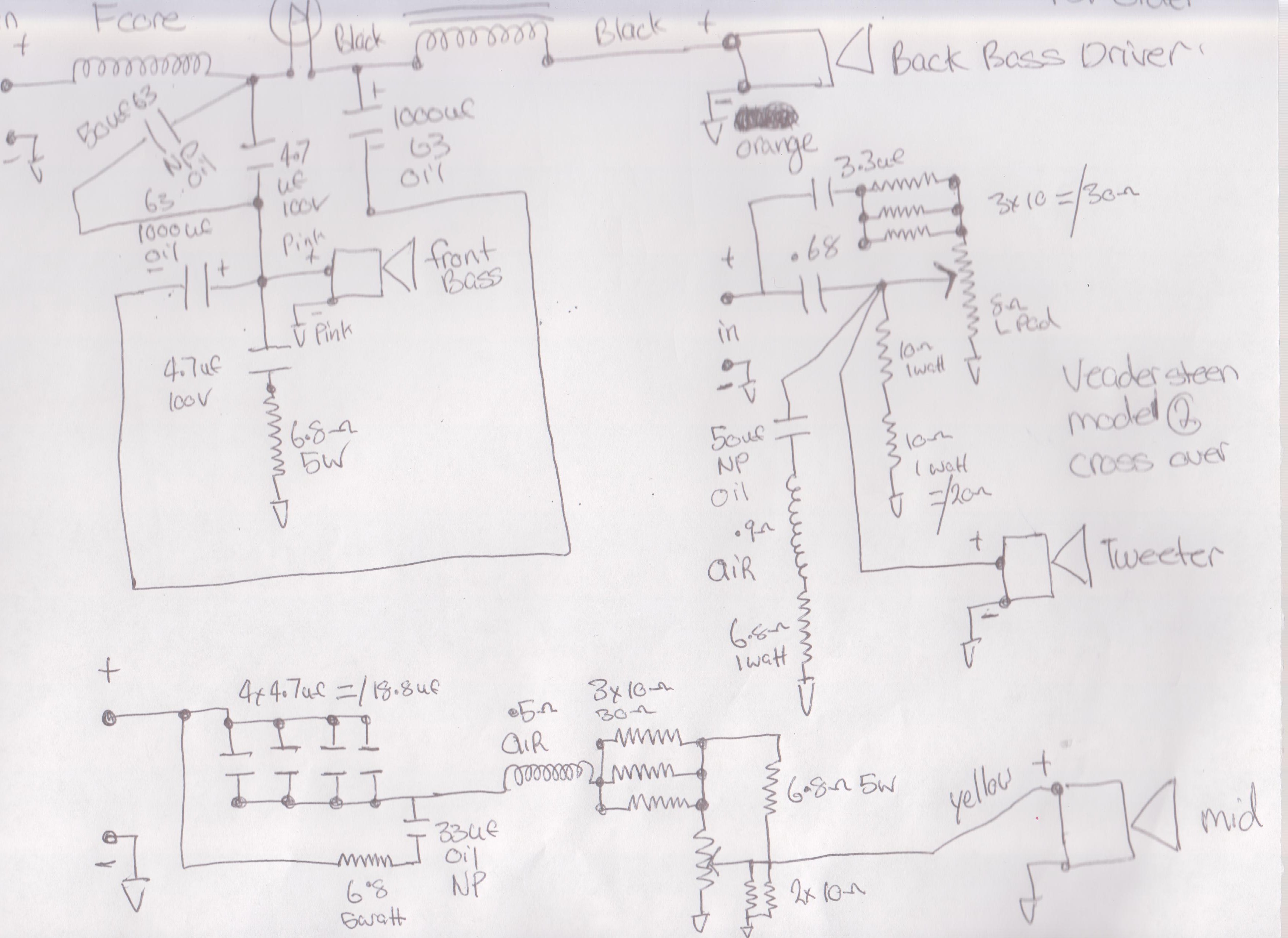

veandersteen 2 crossover drawing
hi guys i have been reading that there have been a few of you out there who have had problems with your veandersteen model 2 speakers me to i bought a pair that had some damge to it so i had to remove the crossover to repair them this is a very hard jub due to the glue use some care must be taken when removing the crossove i have added a circuit with all the info and values 😀😱 so i hope this helps and i to found a replacement tweet witch fits in place
