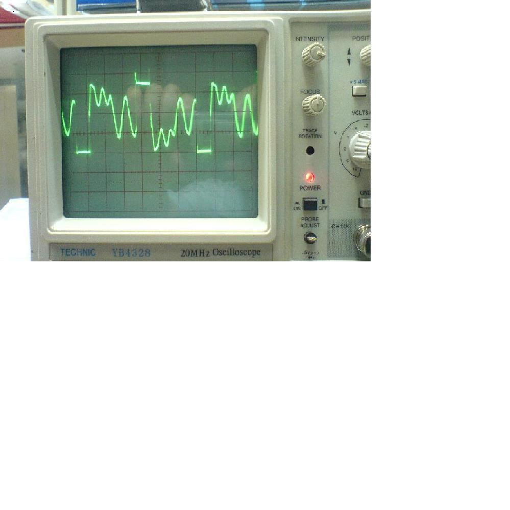

yes, this is what happens. Vds is only well defined when a switch is on. once both switches are off, the stored energy in various inductances and capacitances is allowed to ring.
A different snubber might reduce the ringing if it is causeing EMI issues.
Looks like very high leakage inductance. You can tell by the clamped waveshape right after when the switches turn off. That's the diode conducting in the other FET. Timebase is long so energy is probably high. Capacitance looks high also.

Vds osc.

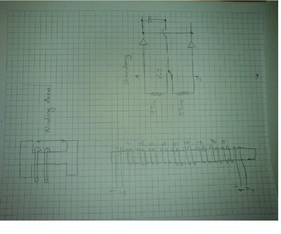

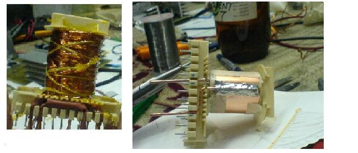

Regarding the power transformer I used copper foil for the primary since the high value of the current. I can not use enamelled copper for 20-25 Amps in the primary. I first wound two copper foils connected as parallel for the 1st primary then the enamelled copper for the secondaries then finally 2nd primary same as the first one. I beleive this is a good way to increase the coupling between primary and secondary. Please check the attached pic.

How many turns on primary/secondary and how did you wind the secondary? Is it one layer? Can you measure leakage inductance? And just curious what is the switching frequency?

1 st. ---Primary is (4) layers of copper foil. (2 foils are soldered together to handle the high current)
2 nd.---My aim was to wound the secondaries as one layer. But the secondaries ((9+9) turns) did not fit on the coil former. Since (7+7) turns covered the available winding area the remaining (2+2) were wound on them.
3 rd.---Again the remaining primary same as the 1st one were wound as (4) layers.

To measure leakage inductance short secondaries and measure primary inductance. In the push pull you want take measurements as 'seen' from the switch during the one cycle. So you want to short the secondary from say 'dot' to ct and measure primary 'dot' to ct.
Most likely the measurements will be low and difficult to measure so measure the secondary by shorting the primary. The leakage inductance reflected to the primary would be the (np/ns)^2 times less.

When the secondary is shorted, the measured primary (L) = 3.6 uH.
When the secondary is open, the measured primary (L) = 14.4 uH.
Snubber ; R=100 ohms, C= 100 nF

What do you mean 9+9? 18 turns with secondary center tapped 9-ct-9? If so, did you take the center tap at the center of the layer?
Do you feel like winding another transformer? Try winding 1 secondary in first layer assuming that the 9 turns is one winding, then all of the foil, then the 2nd secondary. Tie the center tap on the secondary externally.
This should reduce the leakage inductance greatly and to help even more double up on the wires since the 9 turns will not fill up window width now. Go up 1 gauge if it does not fit.
