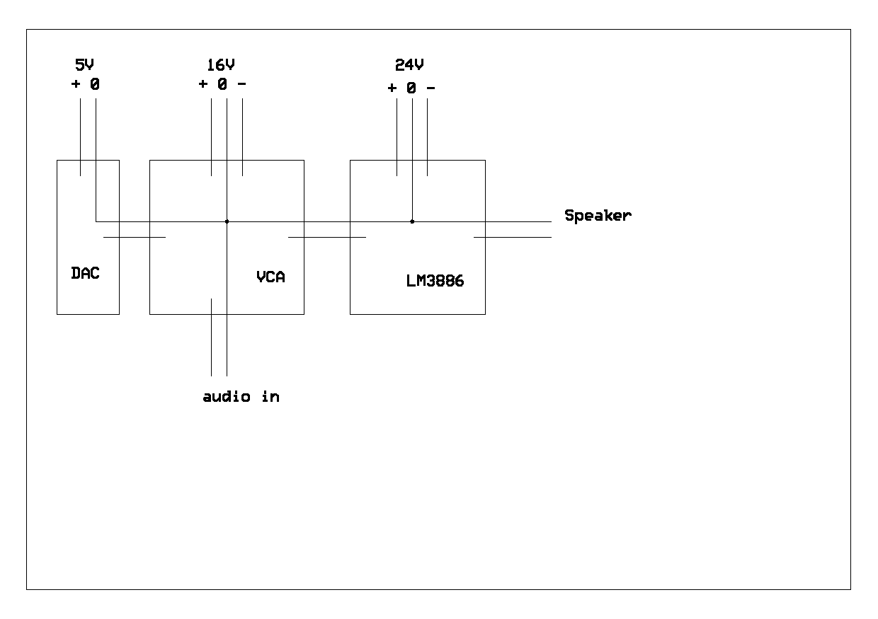

OldJack: If my math is correct, you should have a -334 mV to 0 mV range on the control voltage for a DAC output of 0-5 V. That should give you an attenuation of 60 dB to 0 dB depending on the DAC code.
I'm seeing plenty of opportunities for improvement (see my thread on Bypassing the LM3886 for example). As stated previously, the grounding scheme needs some work to make the parts provide the performance published in the data sheet, but I don't see anything glaringly wrong with the circuit. It should at least function -- if it's indeed connected as shown in the schematic. The only red flag is the 2.2 uF cap on the DAC output. The DAC output buffer may not like that so much. I'd turn that into an RC.
I suggest verifying that you get the expected range on the control voltage to the THAT chip. If that is the good, then start investigating where in the signal chain you loose signal. It would not surprise me if you have to do a complete rip&reroute of the ground net, though.

Tom, I have checked the control voltage to the THAT vca, gives -0 to -352mv.
Control voltage is supplied from a 4525pic at 8bit via a r/2r 1% discrete so I use 16 output ports for the two channels with another 6 for the lcd display and 4 for the ADC. With the crystal and a couple of additions I have 4 spare I/O ports.
I use two pots to provide the analogue signals to the pic and convert to digital outputs with attenuation display on the lcd for each channel. All of this part works fine, have written some anti chatter code to stop jumping between the 8bit output if the pot is between two values.
I am now changing all the earthing but still do not understand the two wire system as mentioned by Andrew. I could do with a bit more help on this part.
As I mentioned before when I built a separate VCA on a breadboard and used a simple 0-5v analogue signal from a pot into the VCA circuit I achieved excellent results, but it was easier to change the earth system.

For testing something like this. The connections between the units are signal and signal-return / ground. Add chassis grounding later.
How did you ground the 5 PSU's or are they all floating?

The forward path from the THAT2181 to the LM3886 is from the THAT pin 8 through the NE5532 and R2 on the LM3886 board. The return path is from the bottom of R1 back to the IN+ pin on the NE5532 and the GND pin of the THAT chip. Any error signal imposed on this connection will be amplified by the LM3886, hence, only signal current must flow here. The best way to guarantee this is to run this "ground" connection as a separate trace and wire between boards. It should, ideally, be tightly coupled with the forward trace as this minimizes parasitic inductance, hence, reduces inductive coupling and EMI. It should connect to the audio ground reference at one point and one point only.
So where is this audio ground reference? Theoretically, the best reference point is the (-) pin of the speaker connector. After all, it's the differential voltage across the speaker that matters. I intend to verify this with measurements one of these days... The local ground at the LM3886 where the bypass caps come together works well as well, but I think connecting the signal ground at the output ground will offer better performance.

The Main Audio Ground should (not must) be at the centroid of all the Audio Circuits that need to make a reference connection.
This "centroid" thing is simply a way of reducing wire lengths.
As I understand it, there should be at least three groups.
1
DAC, VCA and Small signal ground are in the low current group (signal star ground).
2
Speaker Return, Center tap, and power supply 0v are in the high current group (power star ground).
3
Earth cables directly to chassis (chassis ground, literally). Ground loop breaker circuit connects between earth and power supply 0v. The earth cable and the ground loop breaker are the only things bolted to chassis.
Perhaps the DAC grounds onto the VCA and the VCA grounds onto the power amp. Then the high current ground cable connects at only the power amp. If the DAC and/or VCA happen to be split rail then perhaps they can use rail splitters. I would suggest to attempt avoiding plugging the low current small signal devices into the mains transformer 0v since the high current center tap cable is not guaranteed totally clean. So, imagine that the DAC and VCA are not in the same box as the power amp, and build accordingly. For those little guys, you can only ground them once, that is the audio small signal cable, and don't bolt the audio small signal cable to the chassis.

The ground breakers are band-aids. It's better to avoid the ground loops in the first place. The best way to do that is to use differential signaling. That's a project for another day... In this circuit, the best we can do is pseudo-diffential. Minimize the loop area by keeping forward currents and return currents closely coupled. Connecting the signal ground to the chassis maximizes the loop area, hence, the loop inductance. This maximizes EMI and interference. This is exactly what you do NOT want.
The only function of the DAC in this circuit is to provide a control voltage for the VCA to control the gain. The control voltage is differential (sweet!). Hence, the DAC should be on digital ground, the op-amp control circuit should refer to digital ground as well. EC- should connect to digital ground and EC+ should connect to the signal conditioning circuit. That's what I drew up a few pages back.
