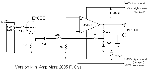

Great! In Franz his threat I could not find a schematics (also for the PSU). Could anyone please profide one here? Makes it easier to search for the parts 🙂
Probably so, but I would like to know what I am building and not just put part A in spot A and so on. You cannot really find substitutions if you don't exactly know what the part does in the circuit.
I will publish the complete schematics by next weekend.
For those, who order just the amps boards: dont forget to implement some 20 to 30 second switch on delay for the powerstage.
While the tube is warming up, you will get full dc output during some seconds, without implementing a delay!

I just added an updated excel sheet, containing the parts-numbering like the psu-pcb.
The parts for the amps board are not numbered, but printed by their value on the boards.
Digi: did you draw any schematics in the meantime? We never had a schematic from the psu, we just worked with the print 🙂
Franz

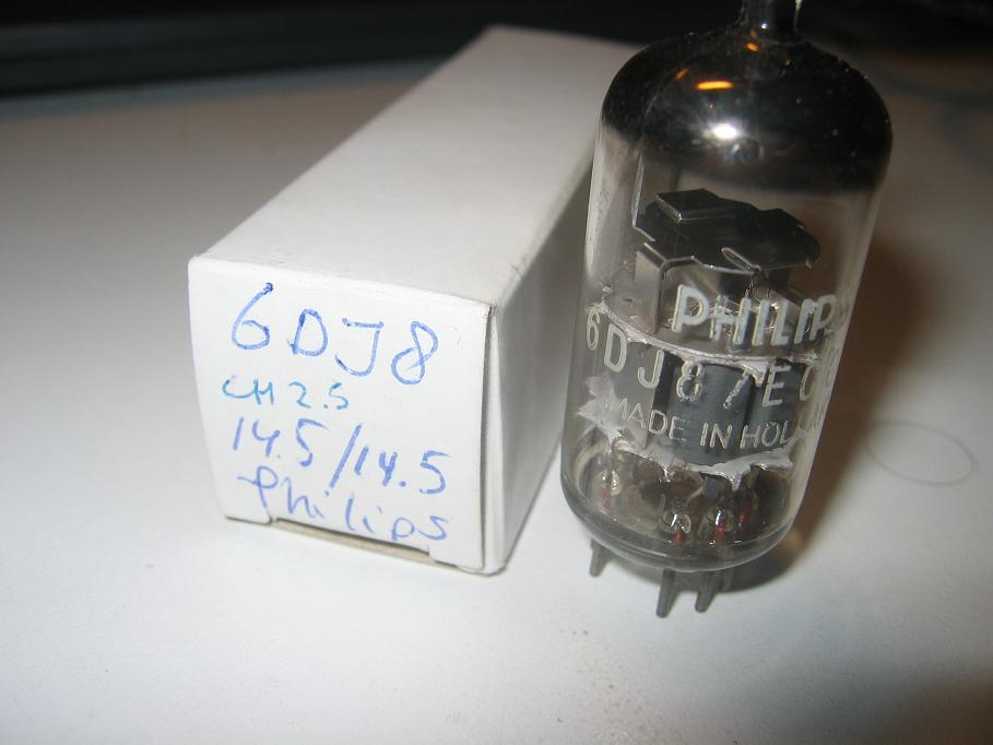

Are there better equivalent valves for this application? maybey the E188CC?
Is the ECC88 (no gold pins? not as good as the E88CC (gold pins) for this application?
That's a ECC88 on your photo Hanzwillem, They have no gold pins and the microphone qualitys are not that good as the E88CC (i read that from internet).
Thats why i alsked for the quality off possible substitutes.
Is the ECC88 in your opinion as good as the E88CC? If so, i use a ECC88 as well (i am a relative nooby with tubes).
