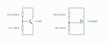

Vbe... Vgs multiplyer with MOSfets?
It is possible to use mosfet as multiplier.
But why do it.
BJT like BD139 does the job. And mount at heatsink it will keep the bias stable.
Nelson Pass have used also TL431 to set the bias of the output mosfets.
Well the typical Vbe multiplier for bias generation is thermally bonded to the devices its biasing so that the temperature coefficients track each other. This makes it a natural fit for BJT output stages - multiply by 2-ish or 4-ish (for darlingtons), and somewhat more if drivers are involved. There are two different multiplication factors you ideally want, one for the tempco, one for the voltage span (CFP v. EF outputs are somewhat different in this).
A MOSFET bias generator would work for a MOSFET output stage fairly naturally perhaps.
But once you know the tempcos you could use either type to bias an output stage, assuming you can multiply by the right factor and adjust for the right voltage span.
Anyway, I think it is rarely (if at all) used in discrete circuits because of the relatively large spread of VGS.
On an IC, it is also unusual, because you would normally just stack the appropriate number of diode-connected NMOS and PMOS transistors.
