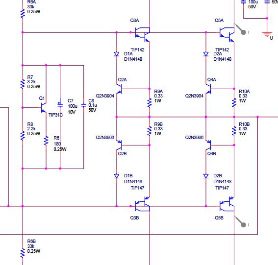

Hi All,
Thread's rather old, but as I came across this just now while designing a biasing for the output stage of a power amp I'm building, I'd like to share my finding on Vbe multiplier sensitivity.
Sensitivity of Vbe multiplier is defined as the change of the quiescent current of the output transistor stage with respect to change in temperature. When Vbe mult transistor is mounted on the heatsink where the output transistor is mounted (as it should be), the bias stability of the OPT will depend also on the Vbe mult transistor bias statbility.
Therefore, to change the sensitivity of the system, we can design the Vbe multiplier to have an emitter leg resistor, just like the normal emitter resistor stabilization technique. Increasing the emitter resistor value will decrease the sensitivity.
I didn't go into the math of the design, so I can't have formulas here.
In my design I use Orcad and on circuit simulation, Iq tends to go down with increasing temperature. The goal is to have no increase or decrease in Iq with temp changes.
I increased the Vbe mult transistor's emitter leg resistor until Iq flatlined.

The 2n3904's, along with the emitter resistors of TIP142/147, are used as active current limiters.
Aside from another important function when placing transistors in parallel, the emitter resistors translate the emitter currents of the TIP142's/147's into voltage. When the current increases such that the voltage drop across the resistors approaches 0.6~0.7V, the 2n3904's turn on and divert the base drive currents of the TIP's, rendering the output current limited.

Hi All,
Since there is almost infinite number of combinations possible for what OP and Vbe multiplier transistors to use during design, a designer is faced with the task of simplifying the design by making circuit bias less dependent on device characteristics across an operating variable, say, temperature, like the original problem question. It also simplifies part replacement, as the design will not be so "much" dependent on device parameters, to some degree.
The solution of placing an emitter resistor in the Vbe mult transistor will correct the quiescent current drift vs temperature of the system.
You can simulate the design or an existing circuit using DC sweep analysis. Then monitor Icq, sweep variable would be temperature. You can see that for certain values of Re placed on the emitter leg of Vbe mult Q, the change of Icq vs temp would be minimal.

Hmmm....
By looking at the schematic of a CS-1000 most carefully, i can see a 120Ù resistor connected in parallel with the last down 1N4003 diode (which of the cathode it is connected at the base of the negative predriver)... probably it plays the same role as the emitter resistor that you propose, and which is a good improvement... even if i had no problem with thermal compensation issues... but this is related also with CCS...
