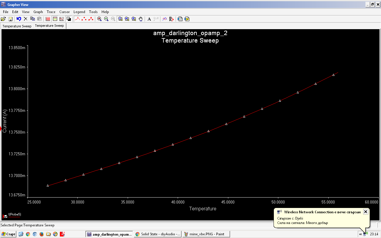

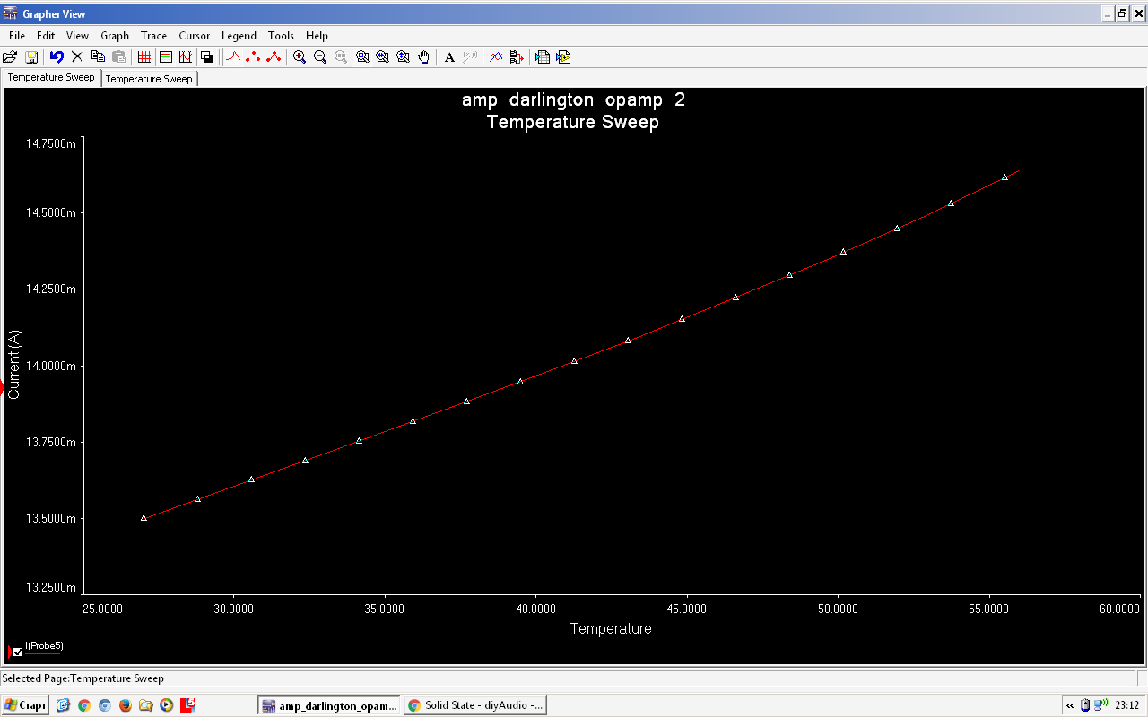

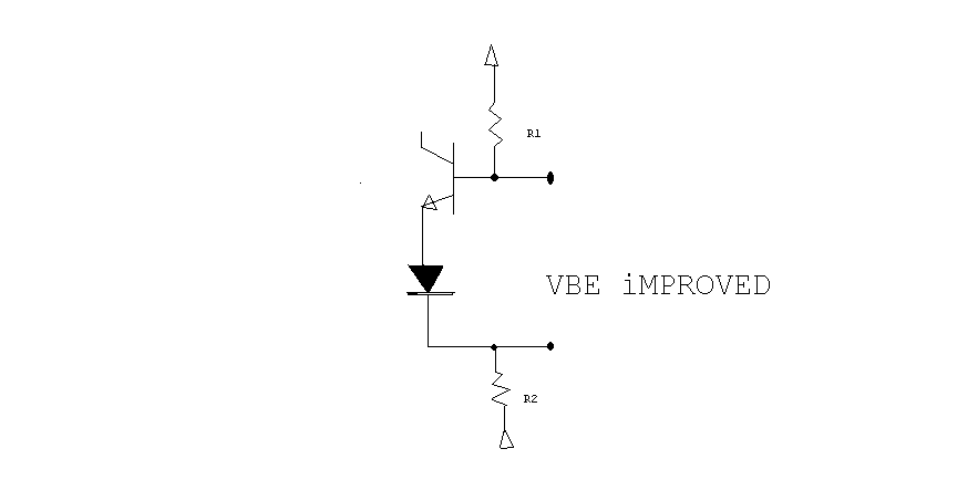

Hello, I present you VBE iMPROVED.
1st attach - VBE iMPOVED
2nd - a standart one
and 3rd - a sch
Note that its less sensitive than a normal Vbe but think about it is VERY ACCEPTABLE DIFFERENCE. 😉
Especially when its about simplicity and easiness. 😛
Im too lazy to solder 2 resistors and connect them to a standart vbe.
Another + is that its adjustable.
For example if want it less sensitive, just connect transistor's colector to its base 🙂
If you want, connect a pot between them. 🙂
Greetings, mosfet54
P.S Why people think you need 4 diodes for darlington ? I dont think they start conduction @ 1.3V. I think they start conduction just like normal transistor.
