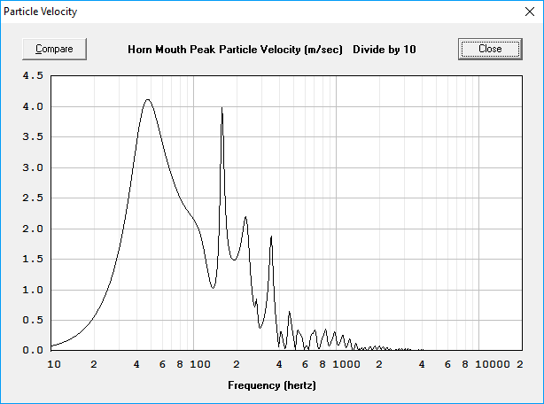

The POC3 actually uses a Dayton PA310 driver, which is pretty cheap - certainly not in the B&C TBX bracket. I'll likely perform the test at different power levels and monitor SPL output. When the change starts to get noticeably non-linear, that would mean that the coil is starting to heat up noticeably.
Particle velocity at the mouth peaks just above where the impedance minimum occurs - an almost perfect relationship 🙂
