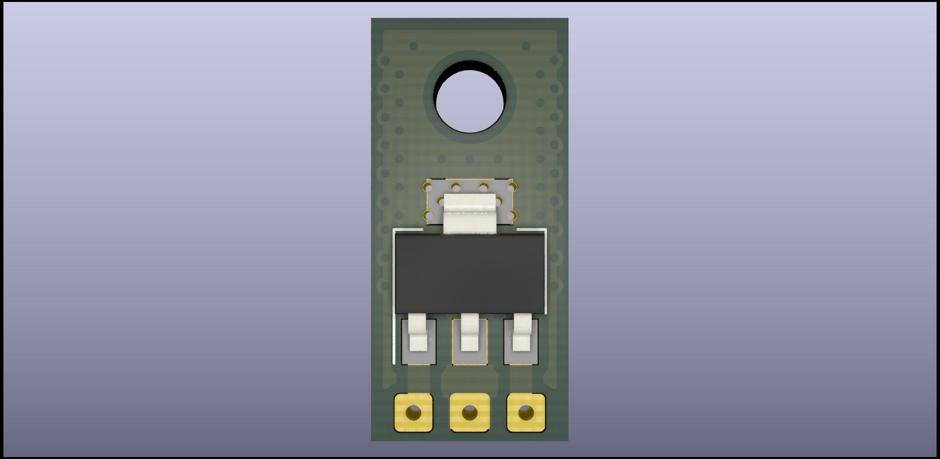

Well, not the biggest problem at all... For most of the pcb houses you might have to order more than one and cut them by yourself because of the minimal area they can process.... But maybe there are more people interessted in.
