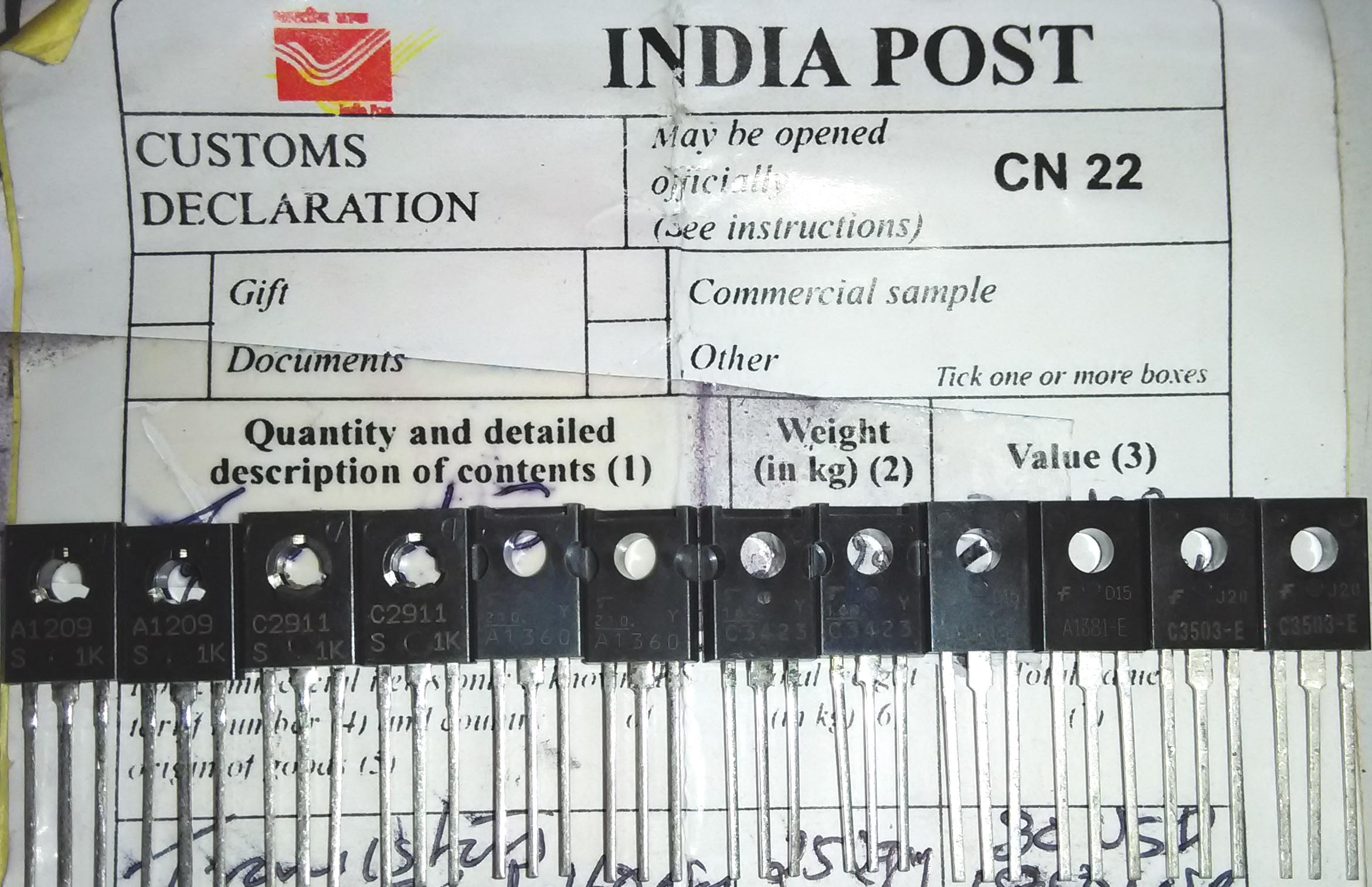

Hi Joshvi,
Here they are...
I'm glad I have the last A1381-C3503 😀
The A1209-C2911 is the highest hFE(best matched),
then the A1360-C3423 it is also better hFE,
the A1381-C3503 is a bit difficult to find matched hFE ... 🙂
note : I randomly pick two pieces of them.
My best option to buy is the A1360-C3423 ...
if you need higher hFE go for A1209-C2911 (range of 200)

Hi Joshvi,
Here they are...
