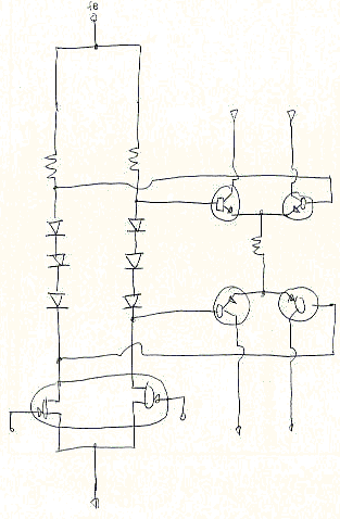

Suzy,
I have had a bit better look at your schematic.
The circuit appears to be highly sensitive to VAS thermal VBE
modulation and 1st stage CM variation.
Starting at IP dif pair, you are running each device at about 0.7mA.
This, through the 1k2 collector load R's, will set the VAS current at
approx 1.5mA / side.
This is way too low for the size of R33 and R34.
Consider a thermally induced VBE change of just 0.05V in the VAS
transistor(s) which will result in a huge change in that small 1.5mA
/device.
It's worth trying the following:
- Delete ground conn between R17 / R18. This will allow dif pairs
to track more closely
- Run IP dif pair at 2.0mA / device.
- Change R27/28/29/30 to 860 ohms.
- Increase R33/34 to75R
- Increase R51/52/53/54 to 20 or 30R
- Thermally join (or keep very close) VAS pairs.
This should set up VAS at around 6mA / device which, in conjunction
with added degeneration, will keep them in a much more linear operating region.
cheers
Terry

Looking at this again, it seems fairly clear that, roughly, D3 should be thermally coupled to Q9, and D1 and D2 to Q17 and Q18, for example. Similarly with the other side.
I agree that the design is too sensitive to thermal drift and component matching in general. I would not be surprised if the design works well when the diff pair devices (Q15-16, Q17-18)come from the same lot, or wafer, and very poorly when not. A prototype does not prove out a design unless mismatched semis are deliberately used to represent the expected allowable spread in tolerance, when selected/matched devices are not used. Simulation and/or analysis should be done with mismatched devices representing the allowable spread in the design. Really, we should step back and consider if the diff amp VAS makes sense? I think not since the design cannot afford significant drop in the emitter path to provide a good current source, and it is far too sensitive to device matching as Terry pointed out.
