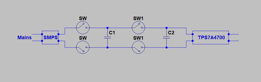

But finally the choice was made to simulate batteries with large caps, just like batteries not connected to mains, to be recharged in a subsonic frequency of 10Hz to avoid possible interactions with the audio signal.
The idea was to start with an commercially available external SMPS or Wall Wart supply that should load C1. After49msec this cap would have to be completely isolated from the external supply and left alone for 1 msec to recover.
Then as a next step this cap had to be connected with both sides to C2 to transfer a charge.
This floating Cap2 should be the one to fulfill the virtual battery function to be followed by a low noise voltage regulator giving a stable very low ohmic supply to the outside world.
After 49msec C1 should be disconnected again from C2, left alone for 1 msec to stabilise and then again reconnected to the supply from the external SMPS supply where the whole cycle starts again.
Fig 1, the basic concept behind the VAS.​

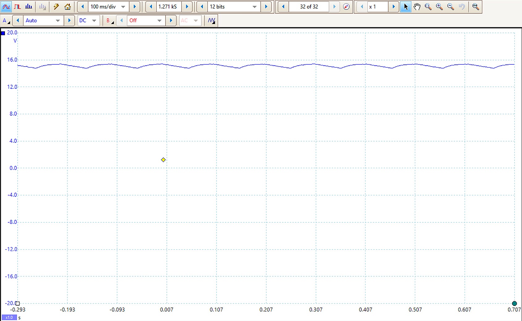

Measuring after having built the circuit, gave the following images on C2.
Fig 2, Voltage on C2 with the D/A converter connected to the TPS7A4700
As can be seen in Fig2, the average voltage on C2 is ca. 15Volt, more as needed for a TPS7A4700 LDO regulator, where in this case 13 Volt would have been enough.

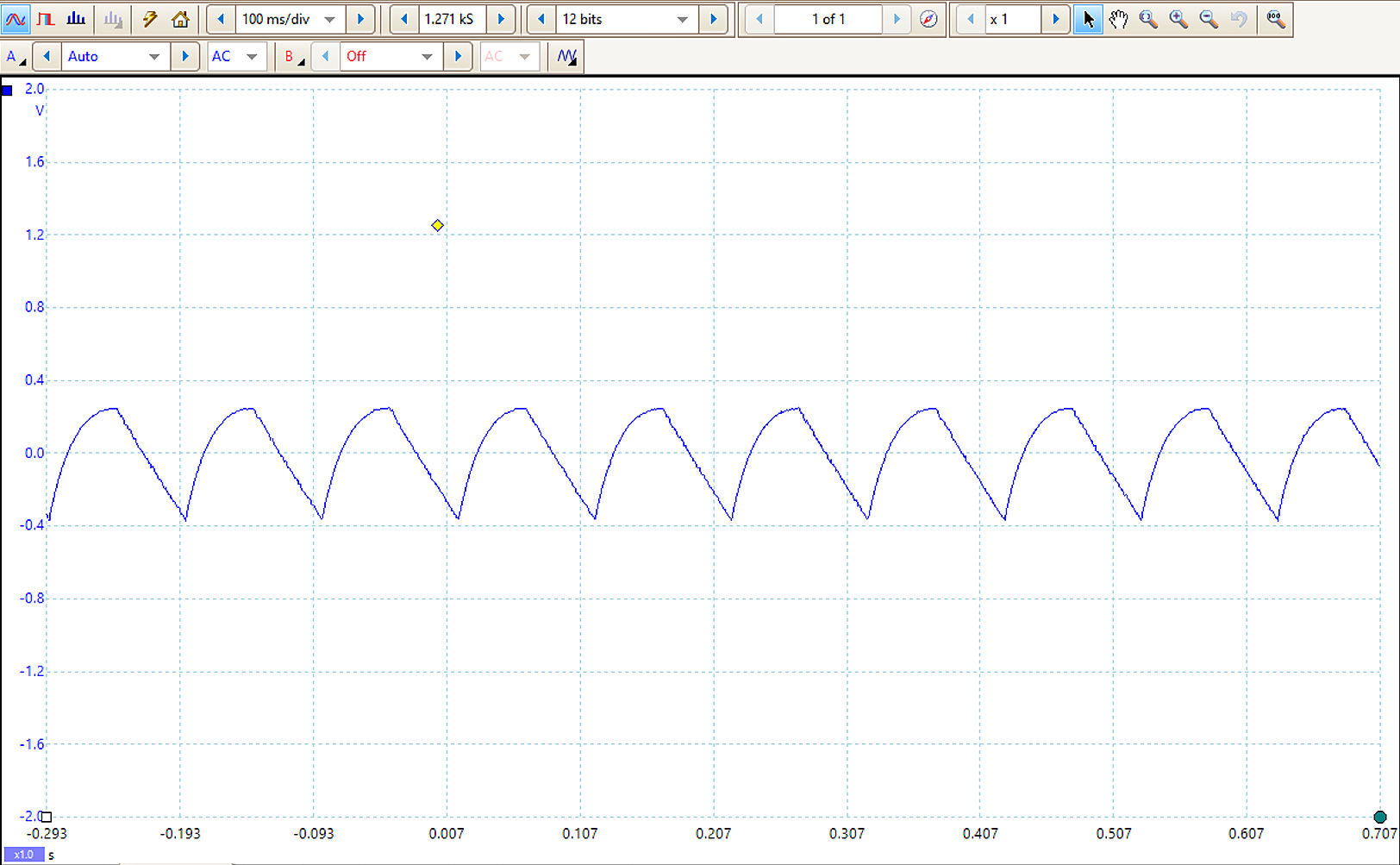

Magnifying the ripple resulted in Fig 3.
Fig 3, showing the AC ripple on C2.
Ripple on C2 is ca. 600mV, where from the down going slope it can be calculated that the current supplied to the DAC is C*du/dt or 47mF*0.6V/50msec = 560mA, much less as the expected 850mA.
After all C1 and C2 could have been three times smaller to still stay above the voltage regulator’s drop out voltage. But apart from a rather harmless additional dissipation in the voltage regulator, the bigger caps didn’t do any harm, so I left them in place.

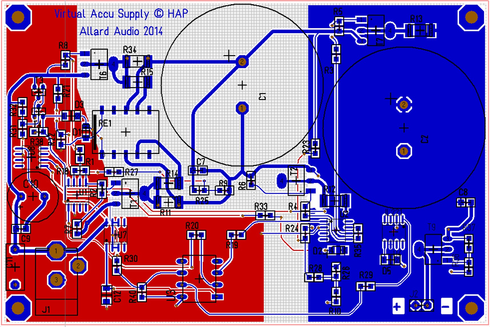

The final result is visible in both PDF’s attachments, one for the 12Volt Out with TPS7A400 and the second for a 18Volt Out without voltage regulator, but instead equipped with an extra Mosfet to isolate the external load in the start-up phase. The TPS7A4700 has an enable pin to do the isolation and therefore doesn’t need this additional Mosfet.
Input voltage for the 12Volt Out version has to be 18Volt In and for the 18Volt Out version 24Volt In.
Of course the 12 Volt version with TPS7A4700 can also be configured for 18 Volt or whatever voltage you need, and the one without voltage regulator has the same flexibility.
It’s just a matter of changing a few resistors, but the MCU is the same for all occasions.

Ad 1. I made a selection of SOT-223 Mosfets with less than 0.1R resistance, 4Amp continuous current although still having a Cds of several hundred picofarad when off. Quite likely after so many years their may be better alternatives for the used Mosfets with an even lower Cds, an important parameter to exclude noise from mains to feedthrough.
And because the floating SMPS supply has some capacitive coupling to mains resulting in a undefined state, it had to be prevented that large potentials could build up over the Mosfets because of that.
Looking at the 12 Volt PDF, that’s why around both caps C1 and C2 a network is added.
Around the first 47mF cap C1 this is R21, R22, R27, R25, R9 and C7. Around C2 the same network is added. Keeping all voltages now within controlled range, this keeps the noise rejection from the SMPS and from Mains well below 120dB, almost like isolated.

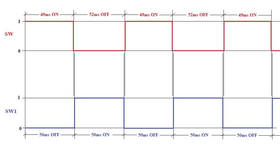

I would be satisfied with just a simple timing diagram of your idea.
Speaking of which I drew one just to know if I understood correctly your idea of the two switches never overlapping (this is based on the numbers in your description)

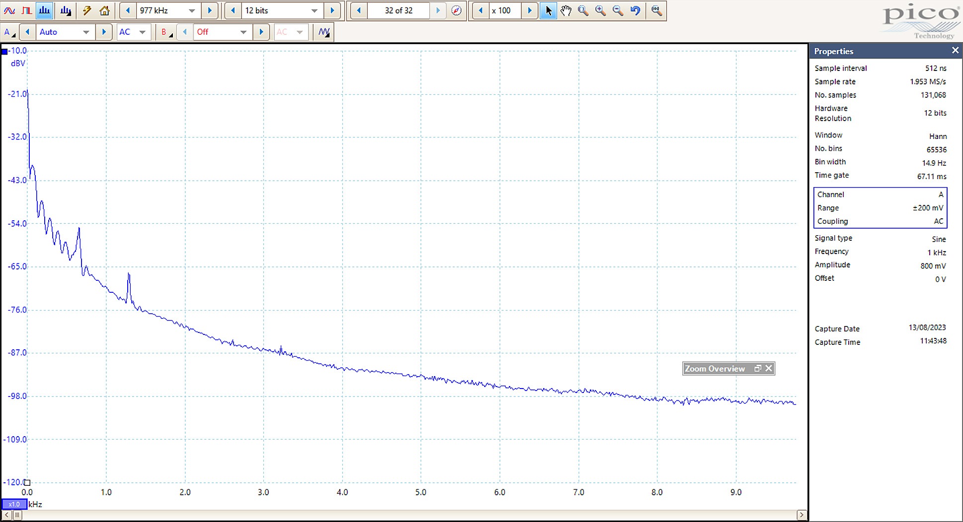

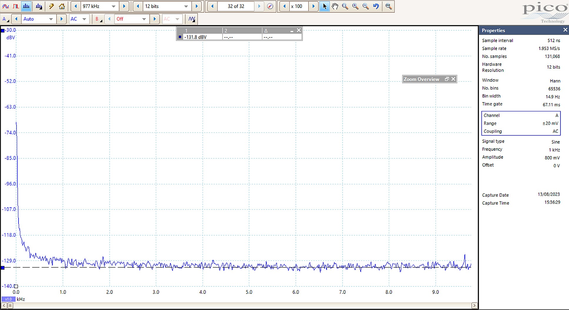

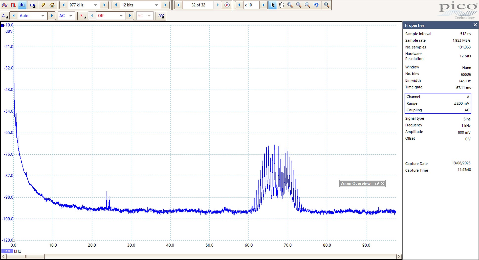

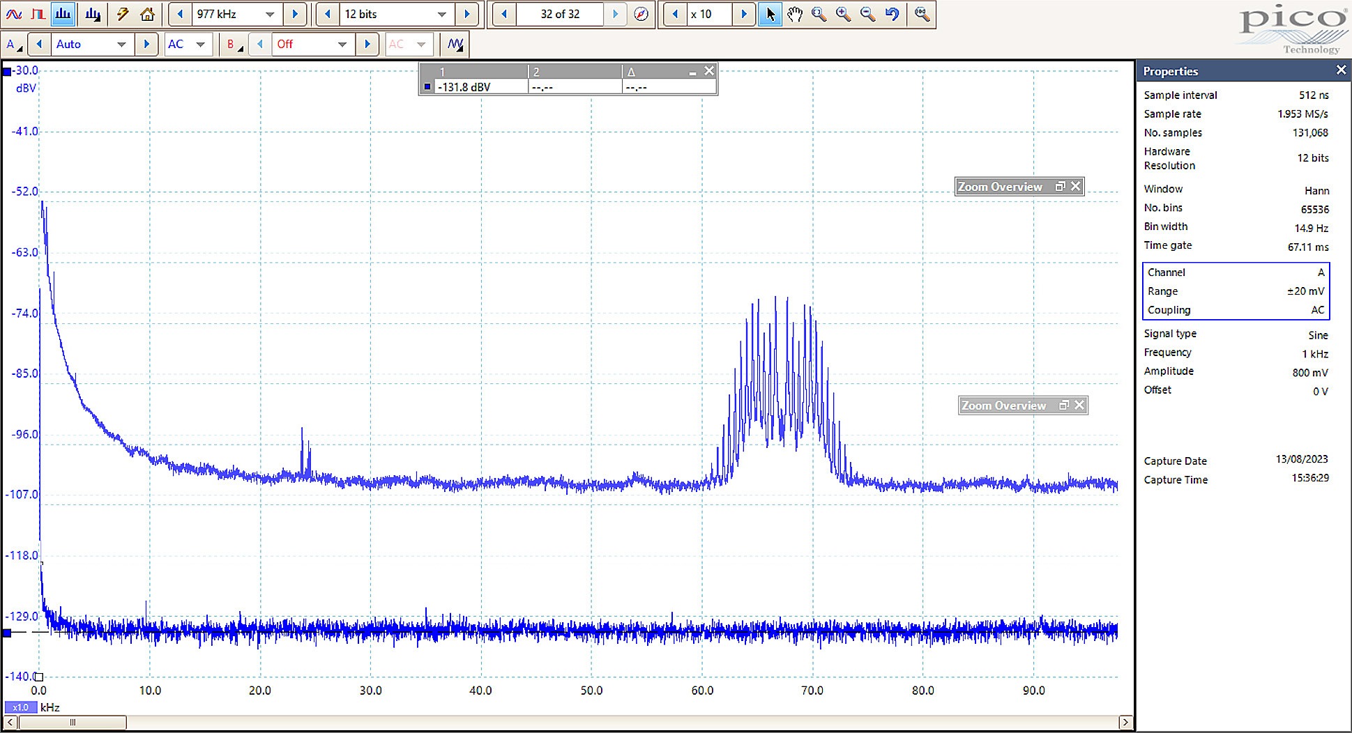

As for the feedthrough from the SMPS through the Cds, I have attached a few spectra taken from the SMPS entering the VAS, at resp. a 100Khz BW and a further magnified spectrum to show 50Hz and its harmonics.
Now look ate the same spectra from the 12Volt where leaving the VAS.
There is no sign of 50Hz and the horrible spectrum from the SMPS is also completely rejected.
Taking the -131.8dB noise level at the 14.9 Hz Bin width calculates into a 21uV noise level over 100Khz, a bit higher as the TPS7A47xx specified 4uV noise level, but this is because the scope's own noise is interfering and most likely the DAC is also backfiring some noise.

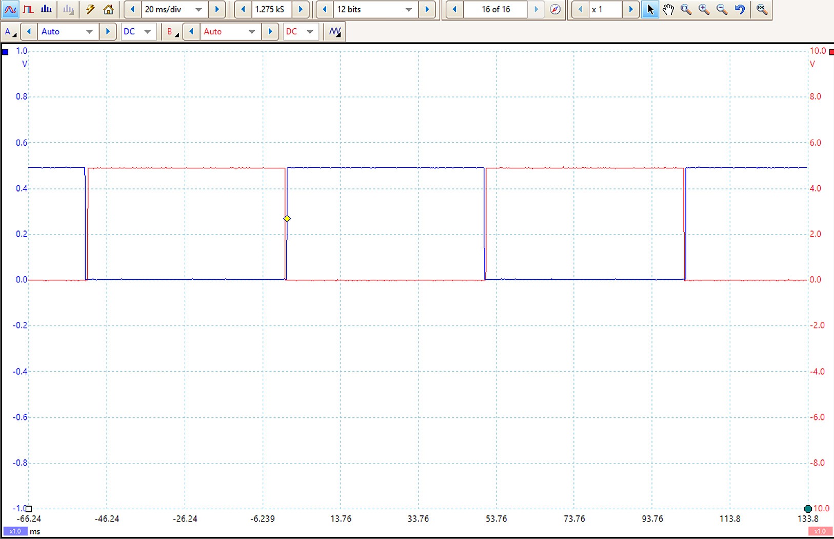

Hi George,

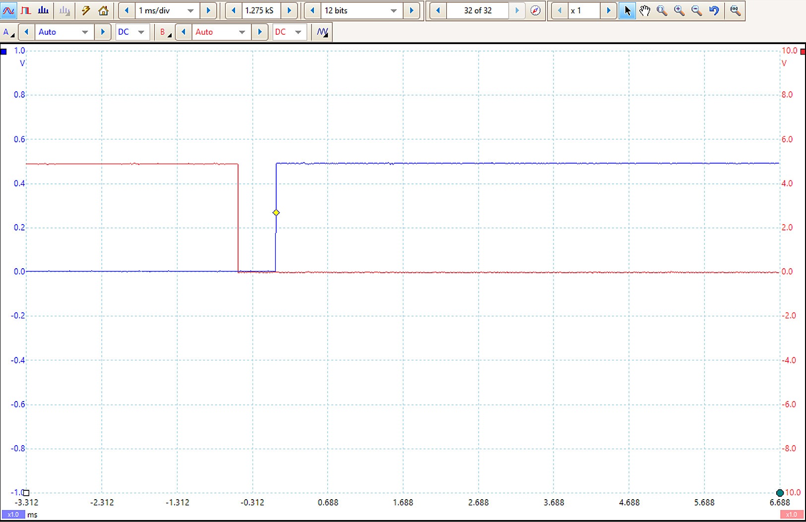

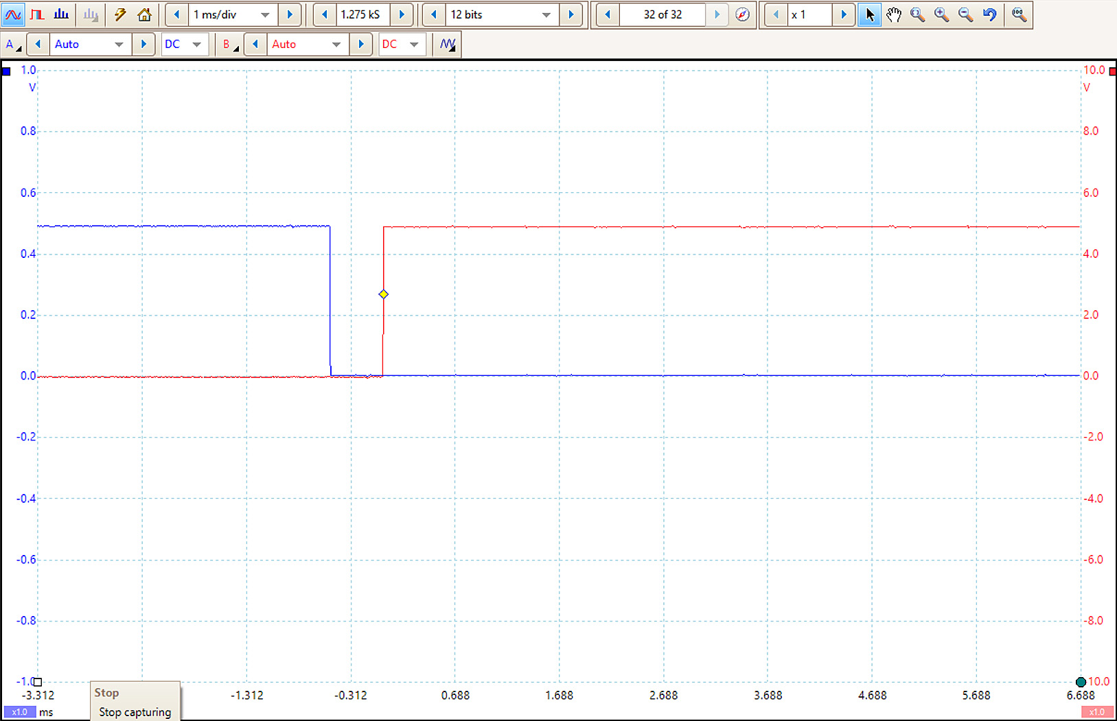

Here you see the combined phase1 and phase2 signals in the first image.
Because the gaps between the two are hard to see, I have magnified bot gaps.
Hans

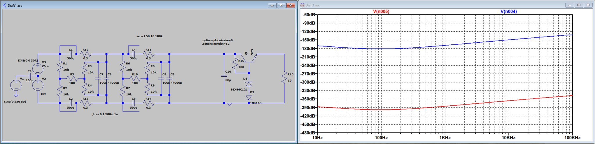

Us monolithic CMOS chaps would build a test vehicle / prototype and measure it. After, of course, running tons of circuit simulations to optimize the test prototype's (simulated) performance.
Hi Mark,
That’s exactly what I did, simulate the circuit trying to find the sensitivities.
I found a suppression of at least 120dB up to 100Khz before the the voltage regulator on Q1's collector in blue.
Mind you, IMO this is not a switched capacitor filter, it's a DC transfer circuit.
Hans

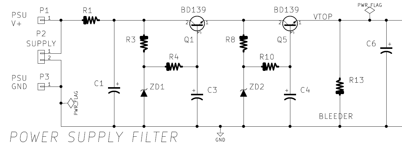

I use similar circuits myself, to smooth the DC applied to power amp front end circuits. I prefer a (R+ZD+R+C+Q) version as shown below. This schematic happens to put two of them in cascade for extra attenuation. BTW if your voltage headroom budget can deal with it, installing a shielded inductor in series with R1 is helpful too. Just be sure to choose an L such that SQRT(L/C1) < 1.5*R1 so the LC resonant circuit is well damped.
I wonder whether your "generic NPN" transistor has any Early effect (dIce/dVce > 0) in its SPICE model. Early effect is one of the limiting factors in these circuits.
_

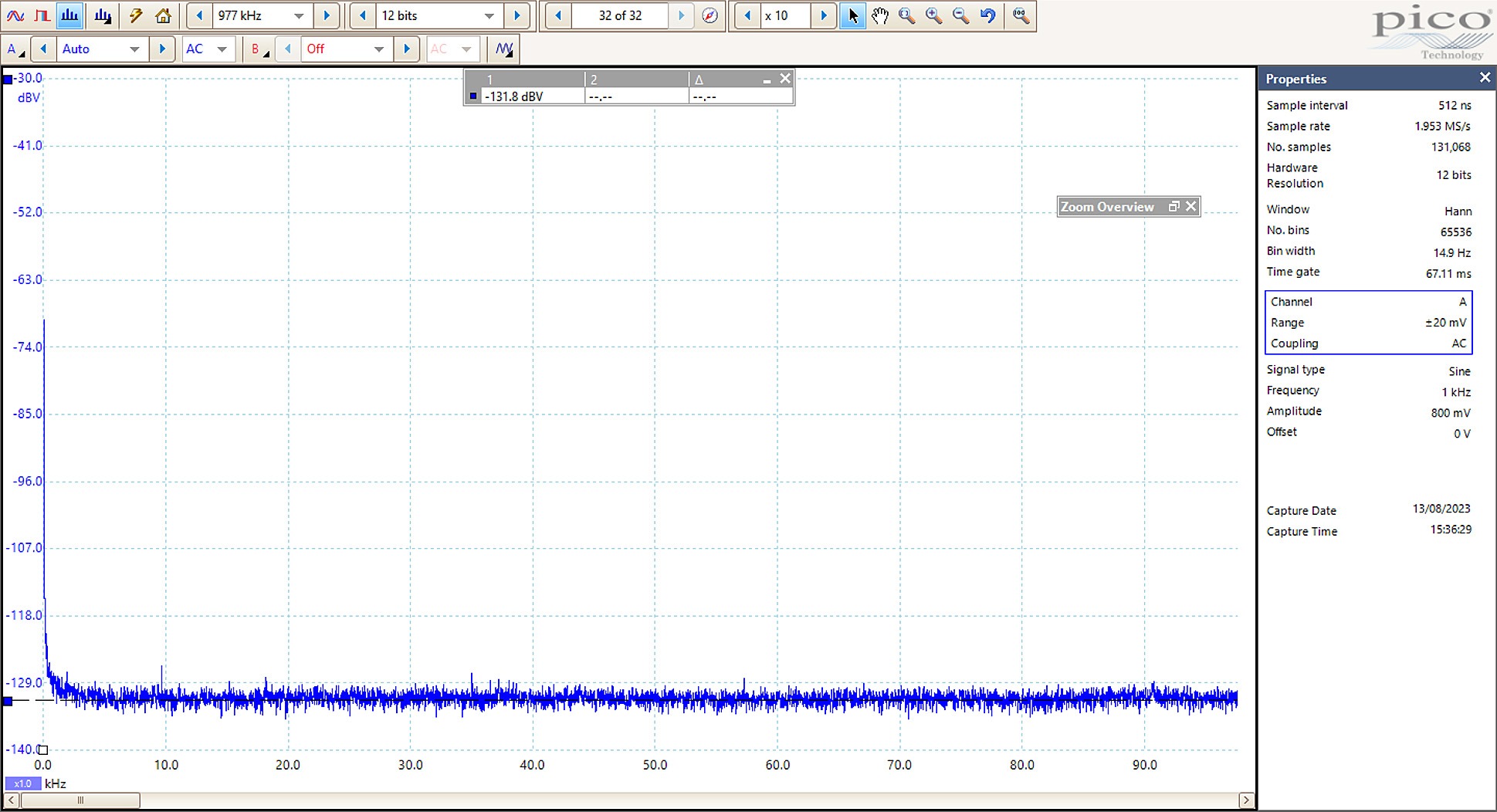

To make things probably even more clear, I have added the measured SPMS input voltage and the 12Volt output voltage in one image at exactly the same scale.
No early effect or whatever as a limiting factor, this it the real world.
The Scope's noise is at -136.7dB, so in fact the 12 volt has a noise at -133.5dB @ 14.9 bin-width or 55nV/rtHz.
