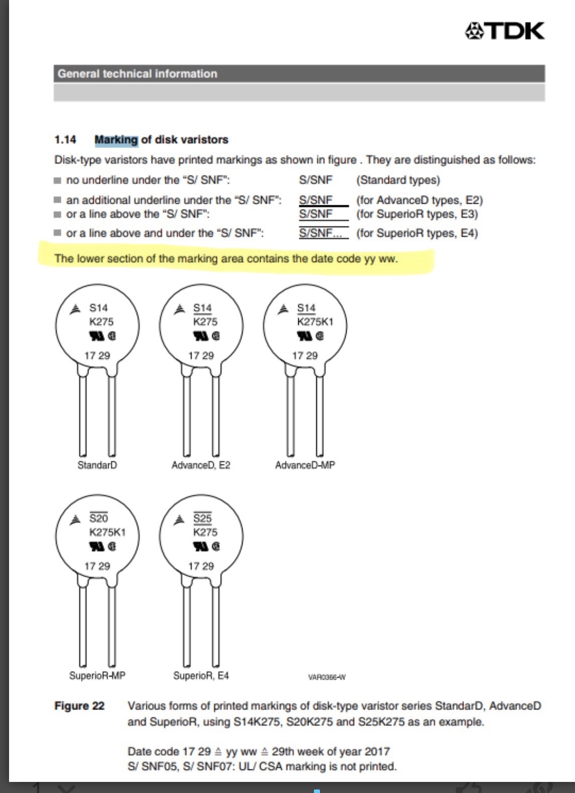

Looking to confirm the specs/code on a leaded disc varistor. I’ve been able to figure the following:
S = leaded
10 = size (10mm)
K = Tolerance +/- 10%
275 = Max VAC (275v)
Not sure what the last line of digits represent, best I can tell it’s a date code?
This what I need to replace:
Here is the replacement I ordered:
Are they the same rating? Can’t find any reference to the last line anywhere or on the TDK spec sheets. (Again, assuming it’s a date/batch code..?)
Appreciate any help!!
