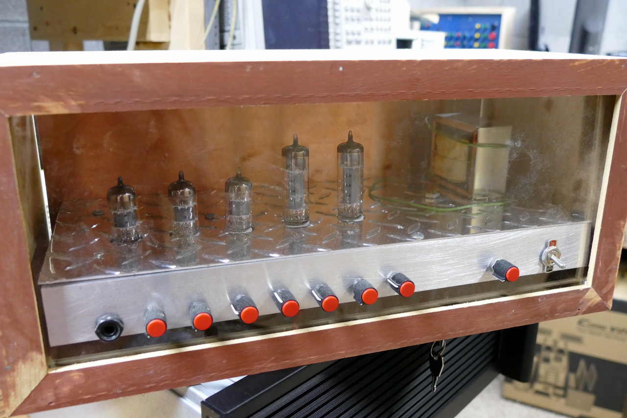

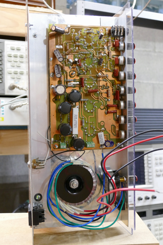

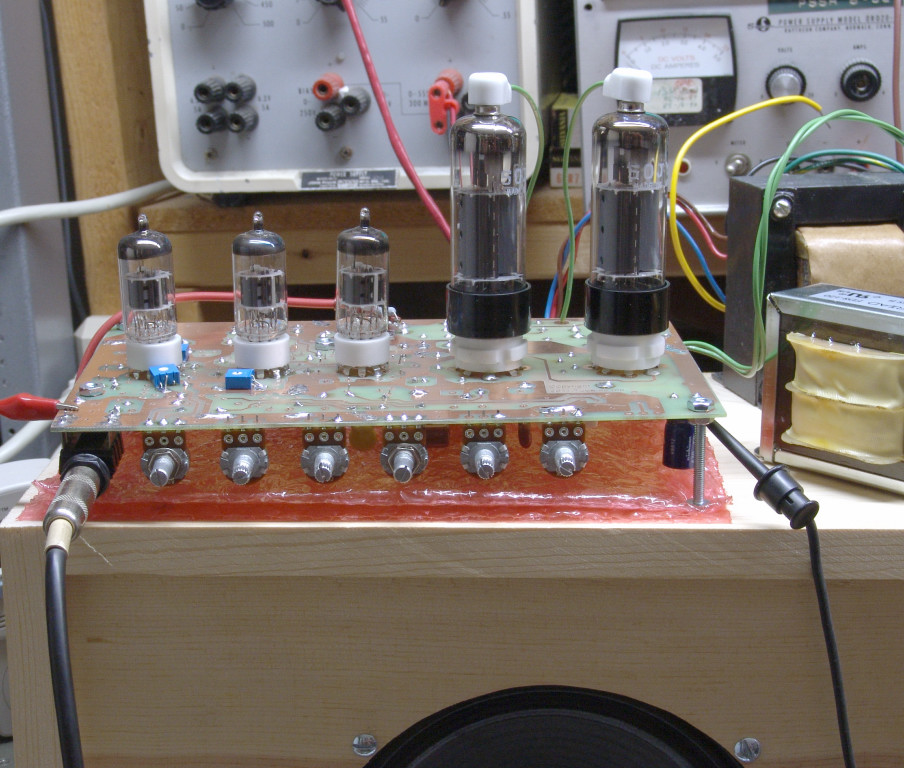

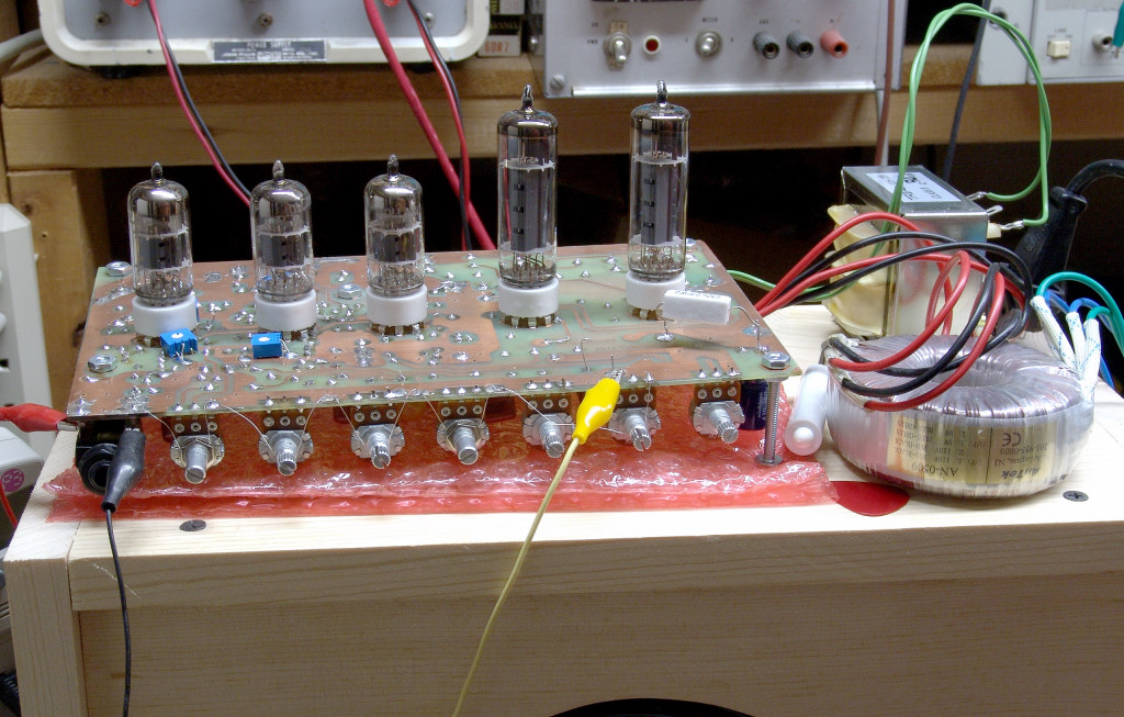

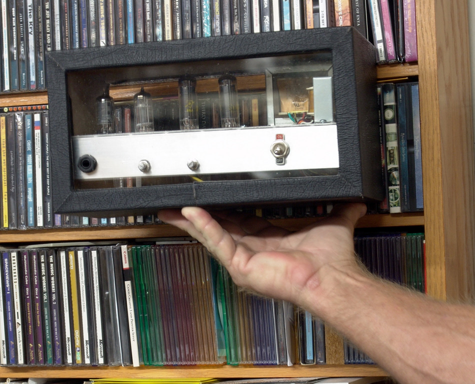

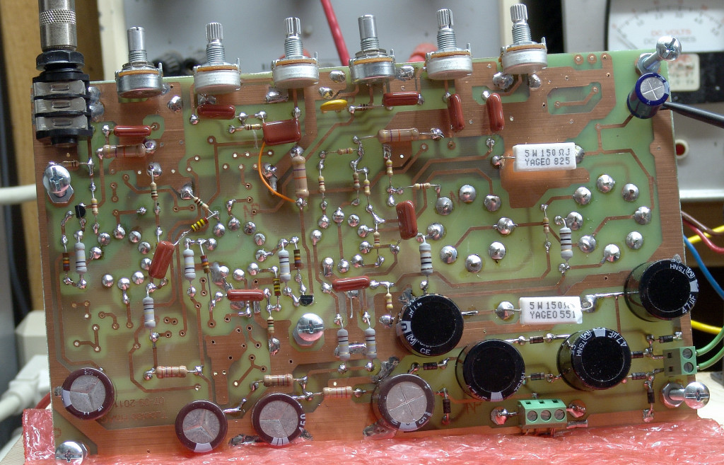

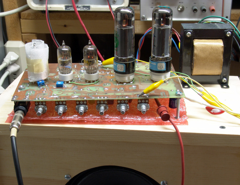

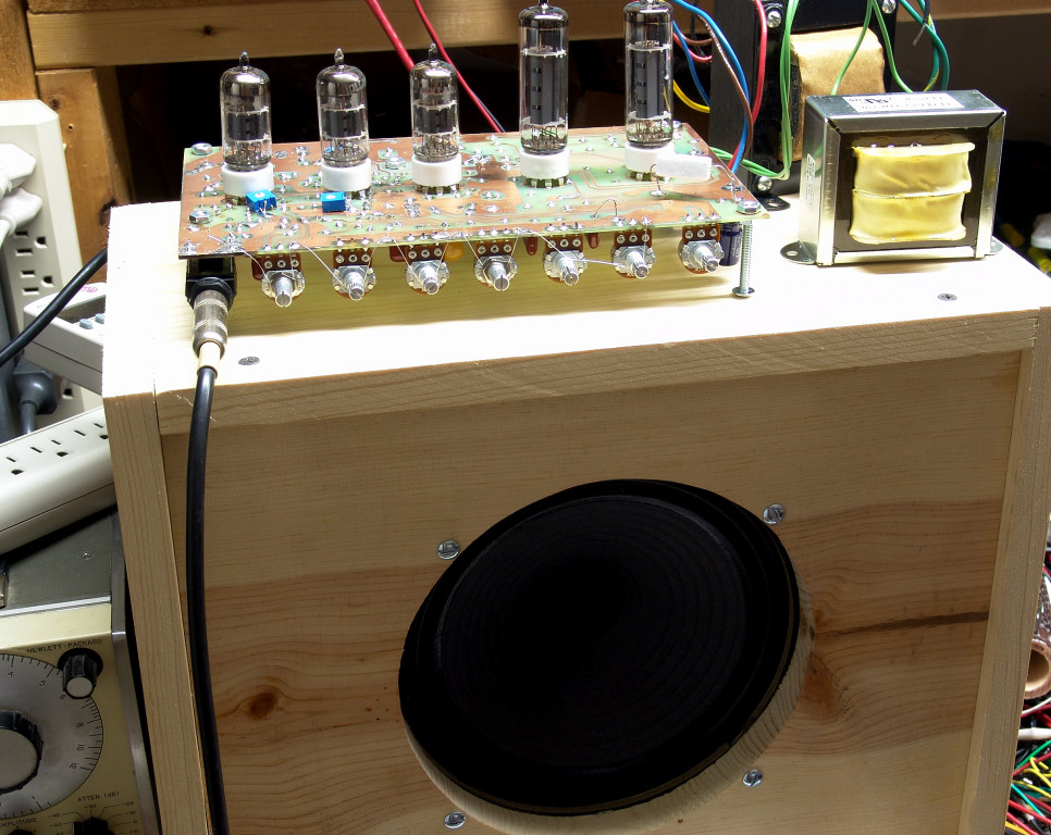

I built this little screamer, mentioned in post #3 based loosely on a "Marshall 18 watt" schematic. It runs UCC85/26AQ8 tubes in the preamp, and UL84/45B5 tubes in the power amp. Power output is just under 20 watts clean (3%THD) and nearly 30 watts cranked. The UL84's get 170 volts on their screens and 340 volts on the plates. The little isolation transformer on top of the chassis is the power transformer. The Antek toroid under the deck is the OPT. It puts about 3500 ohms load on the tubes.
The "in cabinet" pictures were taken before the amp was completely finished.
The schematic shows what was laid out on the PC board, which was intended as an experiment. The amp turned out to have way too much gain, so one gain stage was bypassed and the Mosfet buffers were eliminated except for the one feeding the tone stack. All the mosfet stuff in the cathodes for variable gain sucked, and was likewise eliminated.
This amp was done during the Hundred Buck Amp Challenge, and more details are scattered throughout that thread. The HBAC thread (the sticky at the top of this forum) is an interesting read to see what several builders did to make an amp with low budget parts. The budget was set to exclude the use of common guitar amp tubes.
It was my attempt to squeeze the most possible power and sound out of exactly $100 (8 years ago). I included a picture of the bottom side. The flying resistor and cap in series bypasses a stage and sheds some gain as well. Even with TV sweep tubes capable of 60+ watts, FIVE gain stages was far to many, but three weren't enough with the UCC85's.
It has a bigger brother that also squeaked in at under $100 using TV sweep tubes. It needed a bigger OPT to really scream, which broke the $100 budget. Since the $100 budget was busted, I hacked the board to fit some "real guitar tubes." The EL34's through a real guitar OPT just flat rocked!
I also made an "ultimate cheapness" amp to see just how cheap I could build a good sounding amp for. It came in at under $50 and a slightly modified version of that amp is the one that still gets daily playing time today.
The pictures of the bare board sitting on top of a speaker were taken during design and test. Various combinations of tubes and transformers were tried with 4 or 5 different guitars and speakers.
The big brother and its EL34 variant are also pictured.
So is the little cheap one in its case. It has since been rebuilt although the original is still around here somewhere.

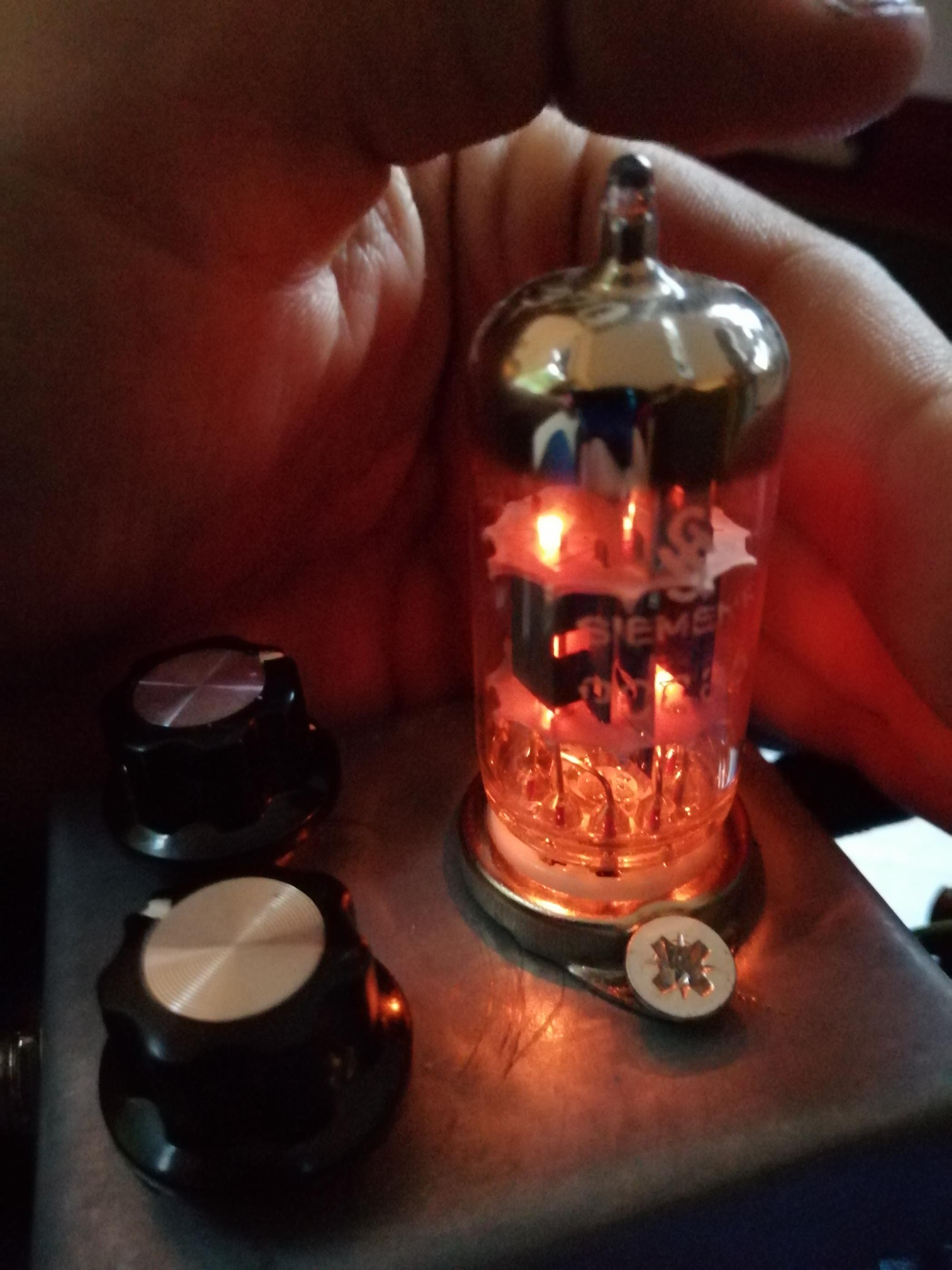

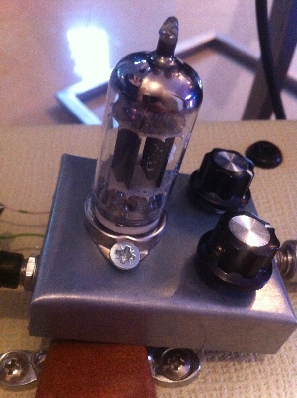

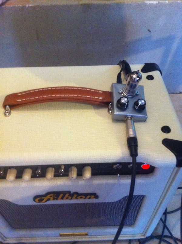

[] I am using ECC/PCC189 for a very tubey (all the second harmonic you can eat 😉 ) "Valvulizer" stage to be inserted between SS preamp and power stage in Guitar amps, go figure.
Wave assymetry is very visible (you can also hear it 😉 ) with even moderate drive levels 🙂
I just made such a "harmonizer" with the PCC189, very excellent results. I am wary of the digital sound, want to have some 2ndH to get a good soundstage (like Nelson Pass argues, but his harmonizer is very tricky to set up with finding the right spot on the knee of a FET).
I used to have something like this with EC90CC and 6J6, excellent sound and predominant 2ndH but the 6J6 gave severe ringing as they aged.

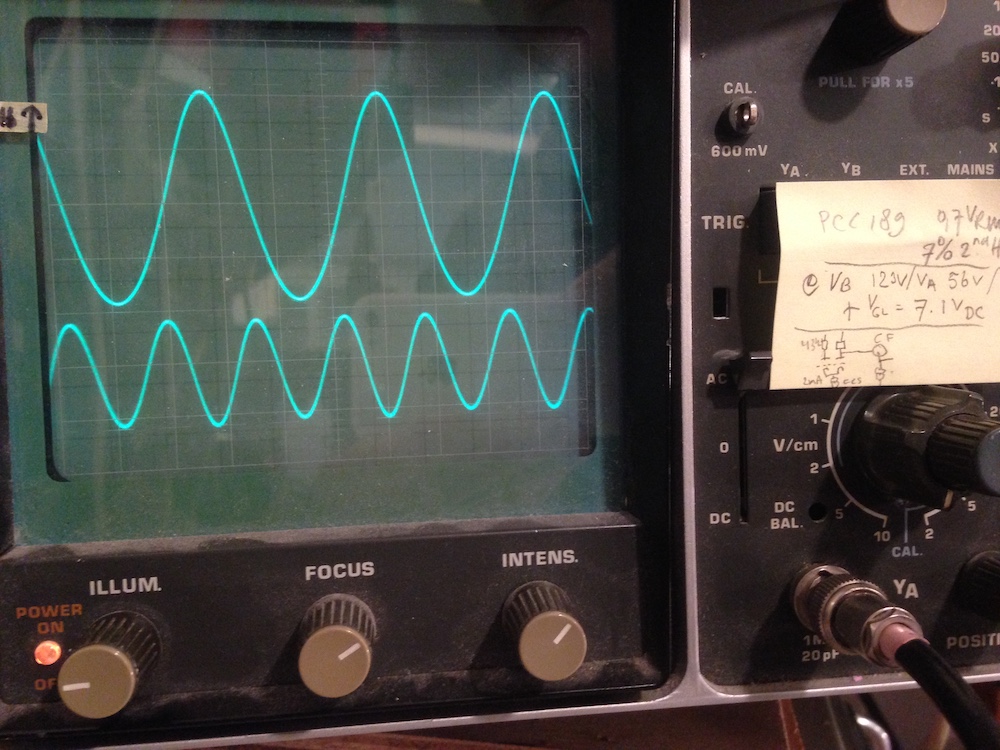

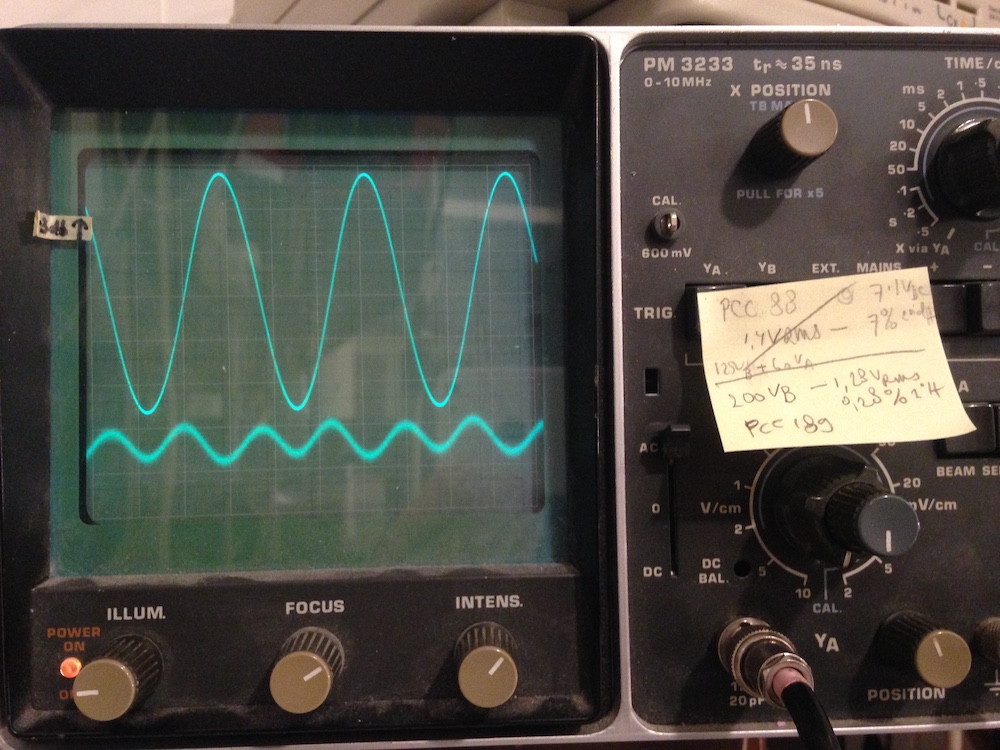

Depending on the power supply the harmonics vary between 0,28% 2ndH and 7-15% 2ndH. [results are almost lineair in relation to output rms. So I will make a knob that changes the Vb so I can find the sweet spot in my room and for a specific source. I will also incorporate the concept in a 'distortion box' for the guitar.
Just two pictures. Base concept: Broskie non-inverting stage - CF in, CCS about 3 mA, Grid follower out, CF buffer. Some 4.5-6 dB feedback. I used 7,2, 7,6 and 6.3, the latter has the lowest distortion.
The pictures say it all, first low distortion at 200Vb/6.3Vheater; then 125Vb & 7.2V Vh
