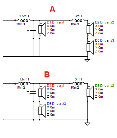

The original design is a conventional 3-way system with two 8-Ohm woofers in parallel. What I was thinking is to adding the third woofer to the system. But, since this is a DIY project, I‘d like to try something challenging. So I wouldn’t go for a 4-way, but a 3.5-way. In my thought, the third woofer will be paralleled to one existing woofer, I’d call it the second woofer, and the impedance there might go lower. Then, these two drivers will be connected in series to a large inductor after the first woofer. It may help the low impedance increases now, unfortunately, not for the deep bass region (about below 100Hz) where I think it could be out of crossover region. That was what I found from the simulations. This’s still be the remaining problem to be solved.
Well one way is to keep the two wired in parallel and insert that third woofer in series with a large inductor, make the third woofer a 4Ohm and the amp sees an 8Ohm load but you would then need to rework the XO and recalculate box sizes so not really worthwhile IMO as a reworking project. Making a second box and adding the .5 woofer as a secondary may work but it may depend on how comfortable you amplifier is with the final load. However if you can find the same woofers but in 4R the result of using the .5 in series may be a reasonable 6R load. All this could be simulated.

Ok, I see. There are two configurations which will produce total impedance presenting to the amplifier at about 5.3 Ohms and they differ in the location of the third woofer.
Which one would you recommend?
