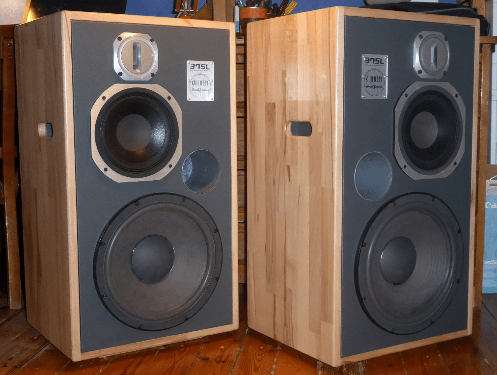

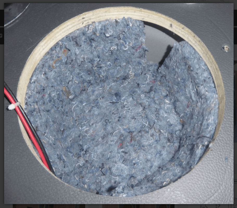

I also use Cotton wool for the 8" sealed 7.5L midrange enclosure of my 375L speakers :
Fiberglass, Rockwool are "phisically unpleasant" materials to my taste... That's why I discard them ! The Cotton wool I use is made from recycled Cotton cloth and fiber, and is harmless to handle and work.

Your midrange is 8" ???? Now I understand why my 4" midrange was giving 3 liters of sealed box in winISDPersonally; I use Cotton Wool, in Sealed or Bass-Reflex enclosures :

Yes, this Midrange is the Beyma 8M60N - unfrotunately now discontinued, like the 12B100R Woofer :

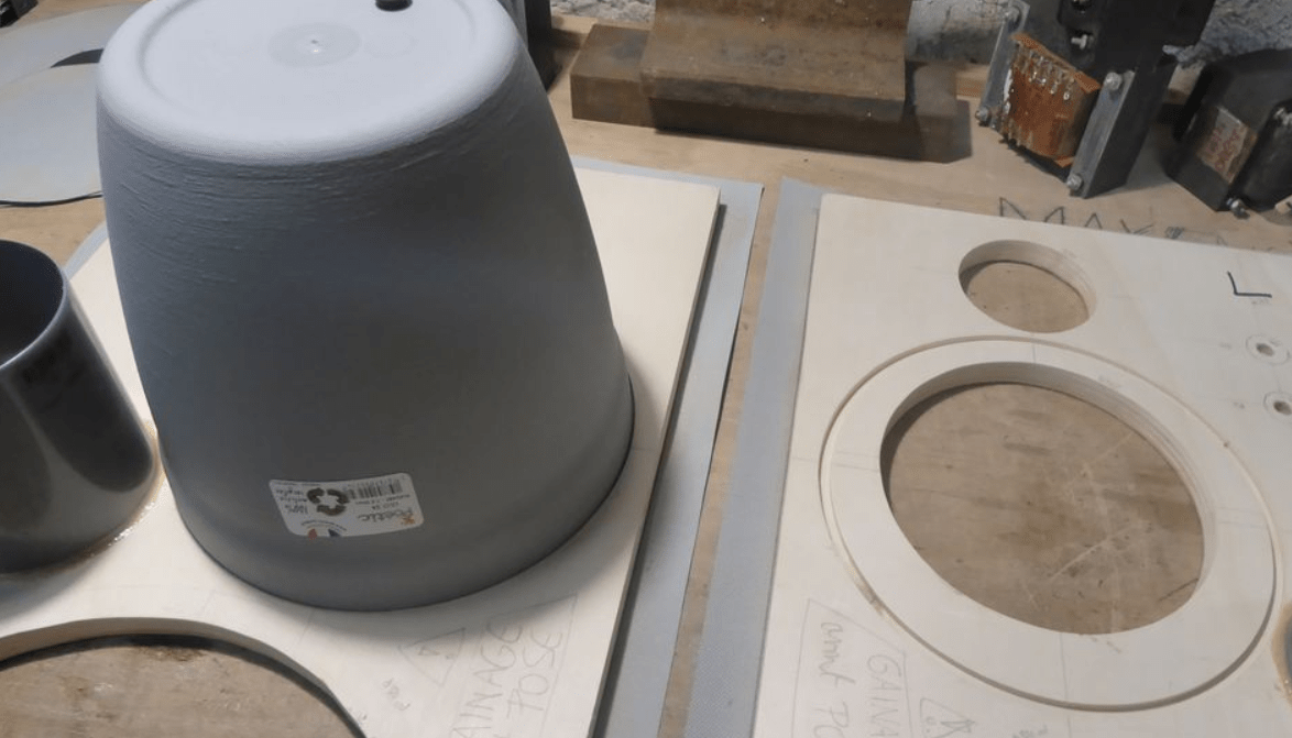

The sealed enclosure of 7.5L allow a 110Hz -3dB low response, fine for a transistion frequency at 400Hz with the Woofer. I use my "patented resin flowerpot enclosure" technique 😀 😉 :

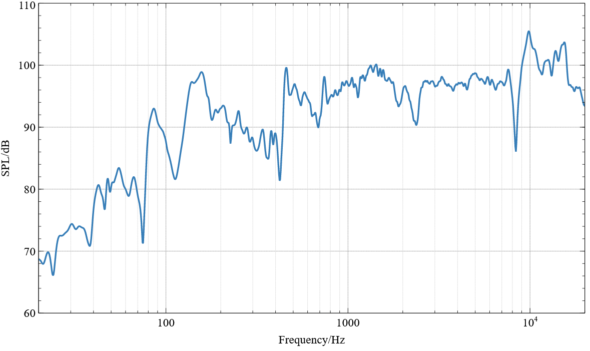

Here's a demonstration of why you need something inside a sealed box. This is the frequency response of a speaker with a cylidrical enclosure. The frequency response is really uneven because the enclosure shape resonates badly, just like a pipe organ.Do sealed boxes really need internal lining?

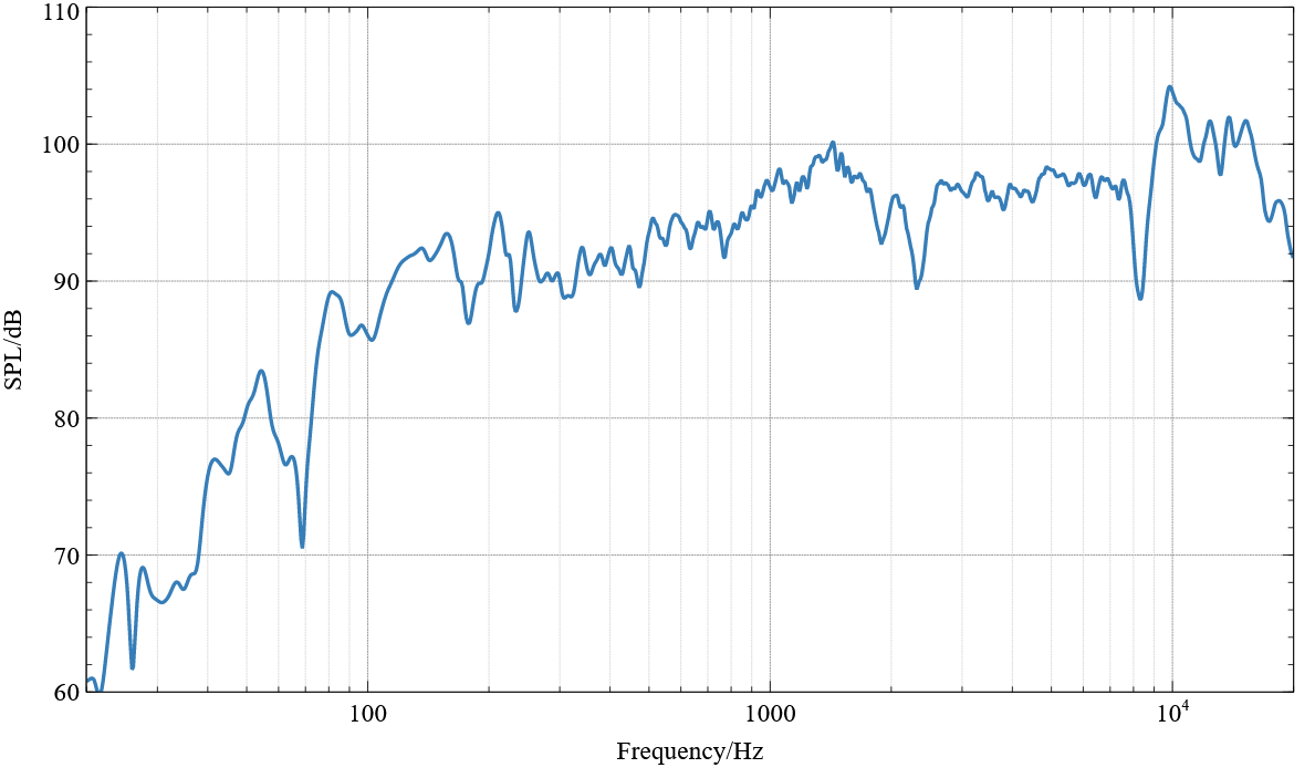

And here it is again, but filled with a polyester fleece jacket (I'm not endorsing the use of clothing as stuffing, it's just what I had available at the time).
Much better.
A less regular shaped enclosure would help of course, but even then, the energy inside the box can only be spread over a wider range of frequencies so it's less audible, whereas stuffing can absorb the energy so there's nothing to hear.
