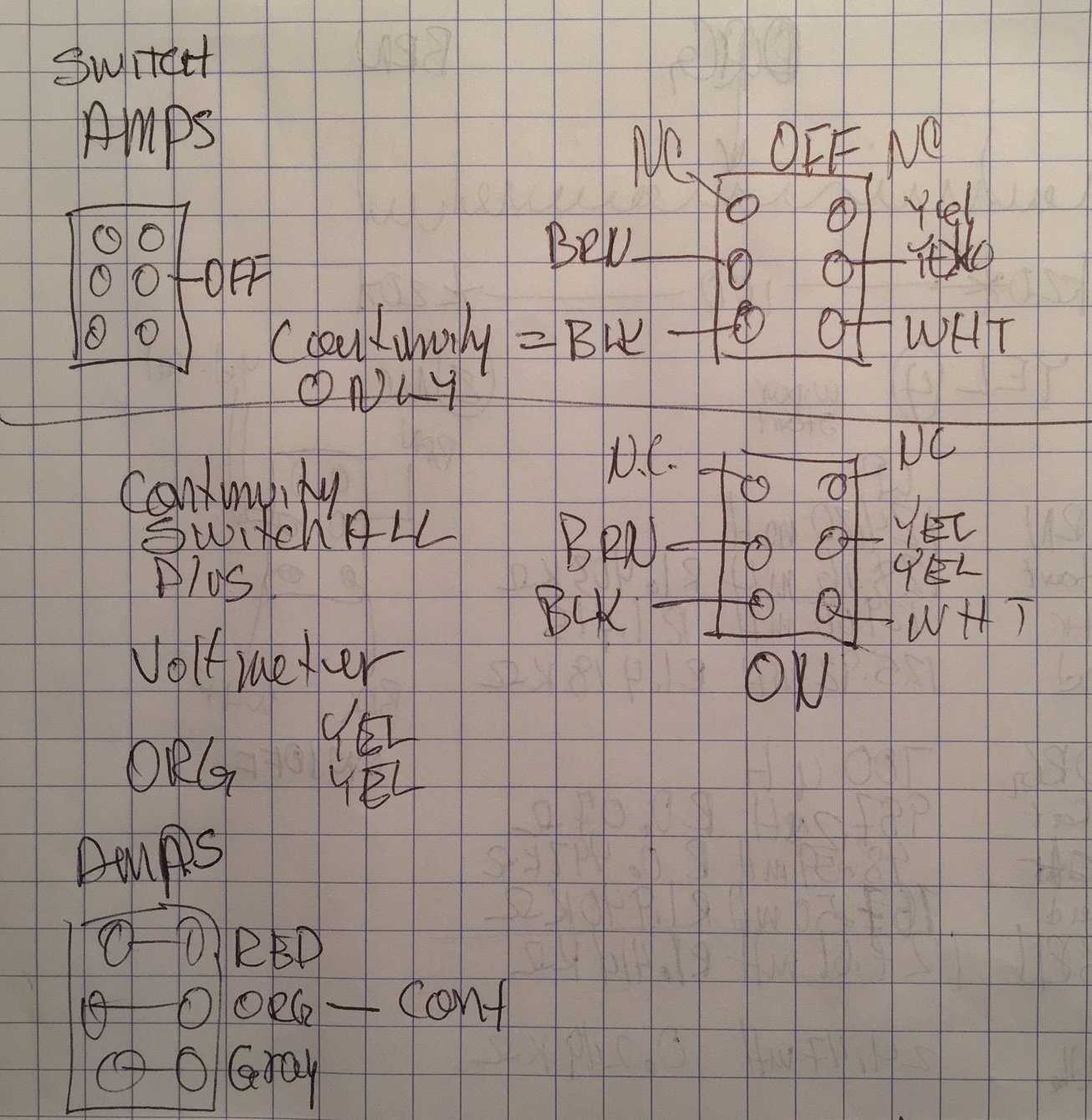

Before doing anything after unplugging my Variac W10 from General Radio,
I took the back cover off to examine the unit. I see nothing out of the ordinary.
Then I figured I would check continuity, seeing if anything arched or burned out.
With on/off in OFF position everything checks normal.
With on/off in ON position, and with the amp fuse set for either 2A or 10A,
every wire in the variac has continuity with line in wire,
that is everything in the variac is hot. ?
Now, I added and ON-OFF-ON switch to the 2A/10A fuses after I rebuilt
the Variac because it started making shoring noises internally. After replacing
the amp fuse switch the noises went away and the Variac work flawlessly.
I thought the ON-OFF-ON switch would come in handy.
With the Amp switch in the OFF position only some of the wires
have continuity.
This leads me to think the main ON/OFF switch became faulty.
When power is applied and the Variac power switch is ON,
and when the dial is turned up from Zero, there is no indication
on the Voltage meter, when the amp switch is in any position.
Again this leads me to think the problem is the main ON/OFF Switch.

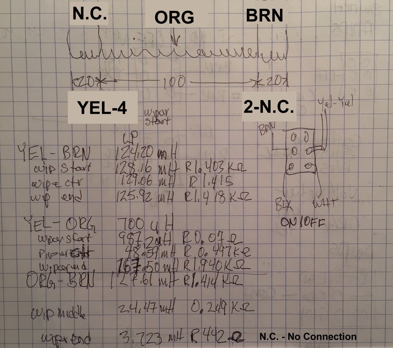

When I measured the inductor and it's various connections they appear
to give correct readings on DER DE5000 LCR meter.
Because the inductor winding is offset:
|<--20V-->|<----------100V---------->|<--20V-->|
The measurements are symmetrical when the offset
connection is accounted for. And it includes measurements
that include the brush at start, physically centered, at end.
So that is still puzzling to me.

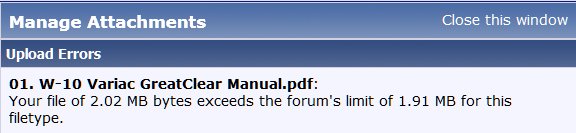

I've attached 3 pics and a clear pdf of the manual.
Nope, not the manual as it is.2KB too large, bummer.

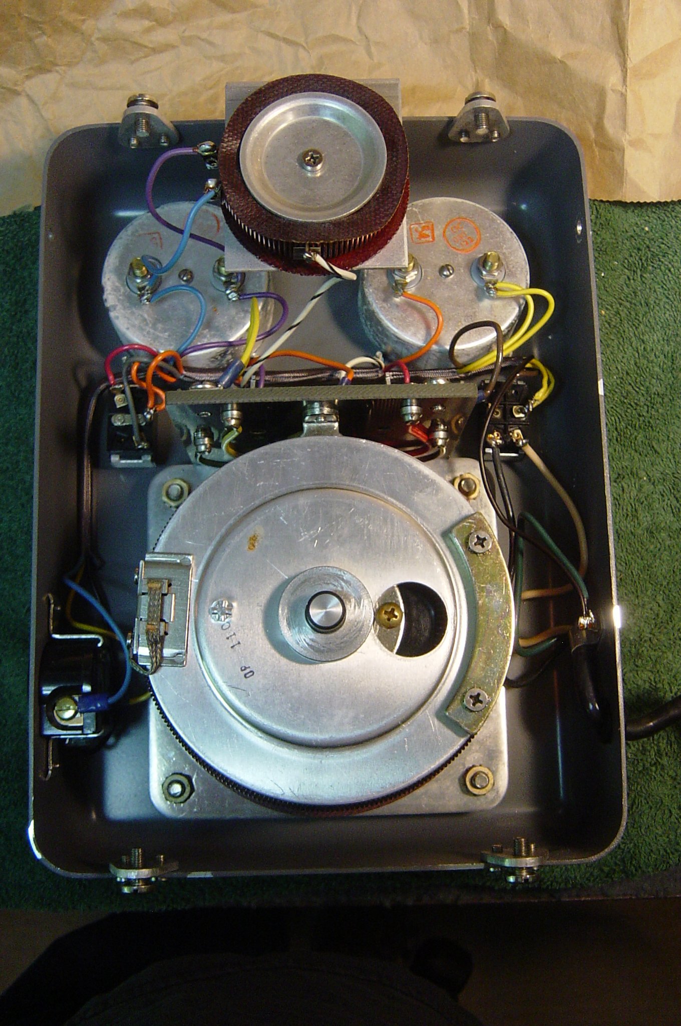

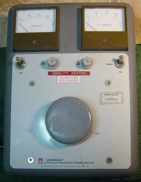

Here is a pic of the Variac's front panel:
415010d1398543185-electronics-tools-equipment-variac-repair-005-frontvariac-jpg

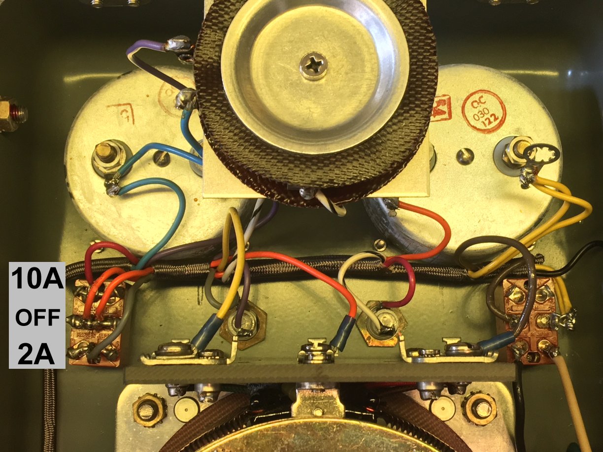

Here is a pic of the Variac's innerworkings:
The left "Range" switch is the onOFFon switch while the right switch is just .......................................................................................ON/OFF
415011d1398543335-electronics-tools-equipment-variac-repair-05-insidevariac-jpg
Here are both the onOFFon switch and the ON/OFF Switchs.
The onOFFon switch was wired with both contacts for longevity
while the ON/OFF switch was wired the same as the broken original.
When you look at the wiki, you can see that I just had to pull the wiring
and the switch just came apart.
The left hand switch was replaced a few years after the ON/OFF switch with the same brand a very high quality
20 amp switch. When in use I could still hear arching inside the variac, which at first I attributed to the inductor.
Then the on/off switch came apart as shown in the wiki link (LINK [linked here again for convenience]).
The Range switch was arching also, so I replaced it with the only high quality switch I had left, of the onOFFon, which is
acceptable in this case as the range switch is set before energizing the Variac, or when dialed back down to zero.
