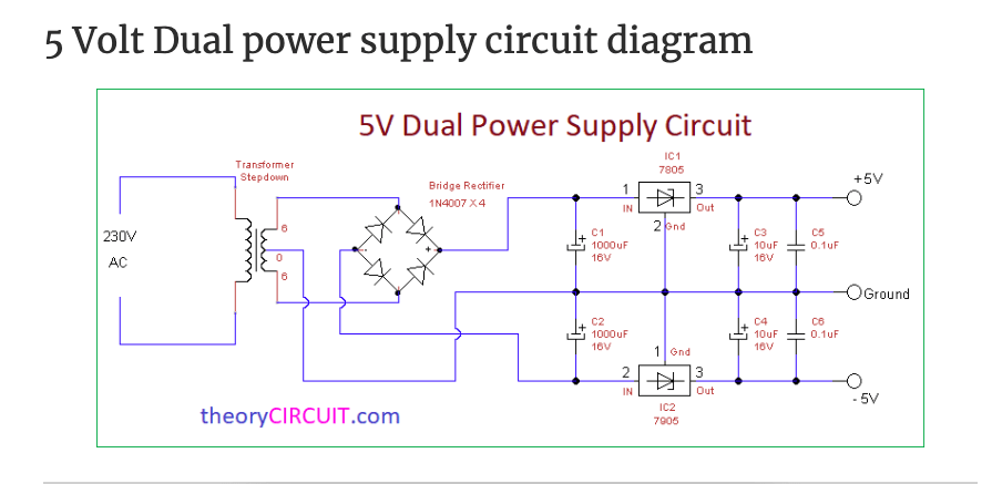

Thanks. I asked because when I wired it up that way, I don't seem to get much of a transformation from the ac to the dc output even though there is a significant transformer between the ac mains and the recitfier: 750-0-750. (Mind you, I don't turn up the variac all the way out of concern that it will short somewhere). Is there a threshold point where the transformer has to reach a "critical inductance" in order to show its true output voltage? I even checked the a/c going in and out of the transformer and found that there was not much in the way of a transformation. This btw, is using the variac at 1/2 voltage.
Perhaps start with an accurate schematic sketch of the parts you have connected, as your first 'schematic' showed a low voltage power supply, but now you are referring to 750-0-750. You are also making measurements on high voltage levels, so the meter, and your experience, and aspects of safety are all concerns.

Please find attached. thanks.
