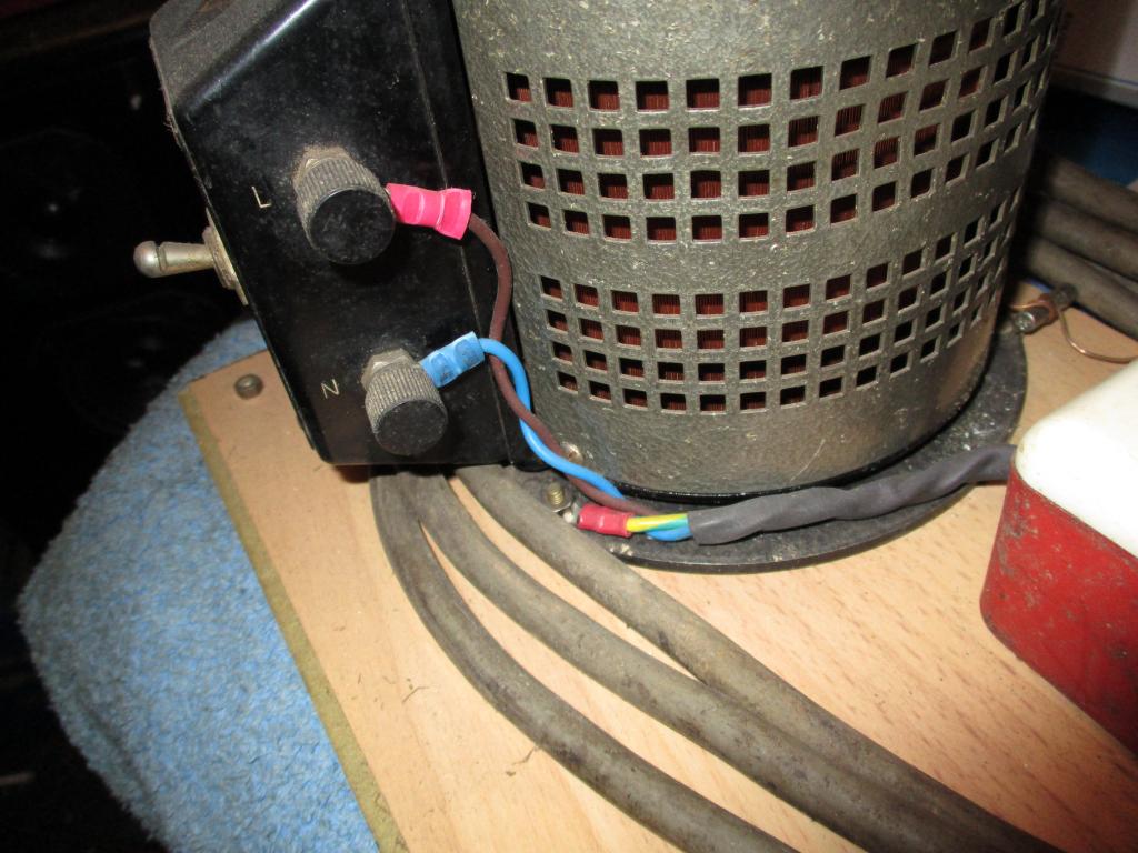

I have two free standing units one being an isolating transformer and the other being the original they copied and painted red for the first post in this thread.
The input is hard wired like the bigger red one on mine.
