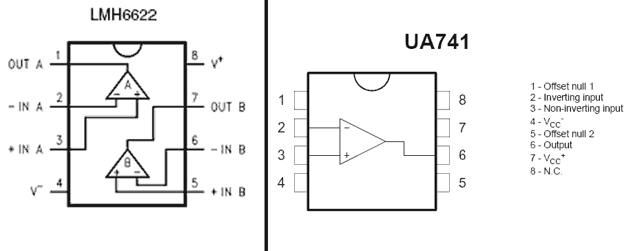

So I don’t know how to fix this one. I’m getting the idea the 714 op-amp wants to work different than the LMH6622

the type of op amp should make absolutely no difference, as long as the pin-out is the same. especially for this application.

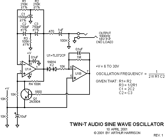

Here's a different article and a different circuit. For crissakes, I'm sure this one works, although I continue to suspect your problem is your power supply, Jacquesl.
A very nice feature of this circuit is it needs only a positive rail and ground, it doesn't need two rails plus neutral. It can run off 12 V or 24 V. Also, the author gives the equation for determining the frequency, and it's pretty straight-forward.
Twin-T Audio Sine Wave Oscillator
This circuit produces a clean sine wave signal ideal for audio testing, or wherever a good-quality sine voltage source is required. It uses only one integrated circuit which is a common dual operational amplifier, the Texas Instruments TL072CP. The values shown provide an output frequency of about 1000 Hertz. This frequency may be varied over a wide range, using the formula shown in the schematic. For most audio frequencies, the oscillation rate is almost exclusively determined by the twin-T network in U1A's feedback loop, provided that the gain-bandwidth product and slew rate specifications for the op amp are sufficiently high. For frequencies exceeding 10kHz, an faster op-amp in the U1A position is recommended.
The ratios of the resistors and capacitors in the twin-T network must be accurate to ensure oscillation. For that reason, ±1% components are indicated. The resistors in the twin-T network should be metal film, and the capacitors mica (best), polystyrene (good), or C0G ceramic (sufficient). Polyester capacitors may be used for economy if large C1, C2, and C3 values, such as those exceeding 10,000pF, are required. Note that the capacitor ratio of 2:1 is most conveniently obtained with the standard values that have this nominal relationship, e.g., 750pF and 1500pF, as shown in the schematic. Other useful combinations include 1000pF and 2000pF, 1100pF and 2200pF, 1500pF and 3000pF, and 1800 and 3600pF. Alternatively, four equivalent capacitors may be used, with two of them paralleled to make C1. This technique has the advantage that capacitors from the same lot are more likely to be closer in value. The same technique is also applicable for the three resistors, especially when an exact 2:1 ratio of resistance values is not available.
Operation of this oscillator is unconventional, in that the frequency-selective network is in the negative feedback path of the operational amplifier. The positive feedback required for oscillation is provided by R4. Transistor Q1 is part of an automatic gain control (AGC) servo that regulates the positive feedback to keep the sine wave output at a consistent amplitude.
With transistor Q1 and resistor R4 omitted, U1A's transfer function from its positive input to output is a notch filter with a frequency and depth determined by the twin-T component values. The addition of Q1 and R4 provides U1A positive feedback with zero degrees of phase shift at the notch frequency. The circuit will therefore oscillate at this frequency when Q1's emitter-to-collector resistance (Rec) is such that:
(R4 + Rec) / Rec (expressed in dB) =
U1A's open-loop gain (expressed in dB) -
the magnitude of the notch depth (expressed in dB)
U1B and its associated components complete the AGC servo. The series-connected diodes provide negative peak-level detection of the sine wave voltage and also determine the amplitude of the output. Q1 is operated close to maximum conduction, so the small voltage from its emitter to collector contributes negligible distortion to the sine wave. The 0.1uF integrating capacitor in U1B's feedback path was chosen to provide adequate AGC-loop stability for the selected oscillation frequency. The 10K resistor in parallel with Q1 ensures start-up.
The oscillator's amplitude, as well as frequency, is essentially independent of the power supply voltage. An output amplitude of 1.6 volts, peak-to-peak, was chosen to accommodate power supply voltages as low as 6 volts. Replacing the TL072CP with a rail-to-rail dual operational amplifier such as the Analog Devices type AD823AN will permit operation from even lower supply voltages, such as 4 volts. The oscillator will operate conveniently from a single 9-volt battery, and consumes less than 5 milliamperes of current when using the TL072CP. The 470 ohm resistor in the output prevents instabilities from capacitive loads such as long cables, and the 1uF capacitor removes the DC term at U1A. The output's 100K resistor discharges the 1uF capacitor to prevent voltage transients when connecting a load.

My op-amps is not responding in any way, it doesn’t even seem to be connected if using it.
This is not going to work, the LMH6622 have two Inputs Input A and input B and no other stuff so by using a 741 op-amp that only have one input and some weird pins that I have no idea what to do with. Offset null 1 and Offset null 2 is probably not going to work on the same principle, so I’m a bit confused about this stuff it’s not working like it should. I have no idea how to use the Offset null pins on the chip
Don't connect them, offset trim is optional. (If you needed to, you'd add a 10k trimpot, connect both ends to the offset pins and the wiper to positive supply).
Note the 741 is a SINGLE opamp, the LMH6622 is double = two opamps on one chip. You need TWO 741s. One of them will be amp A, the other B. The 6622's pins 3,2 and 1 correspond to 3, 2 and 6 on amp A; pins 5, 6 and 7 to 3, 2 and 6 on amp B. Positive supply goes to pin 7 on amp A and B, negative or ground to pin 4.

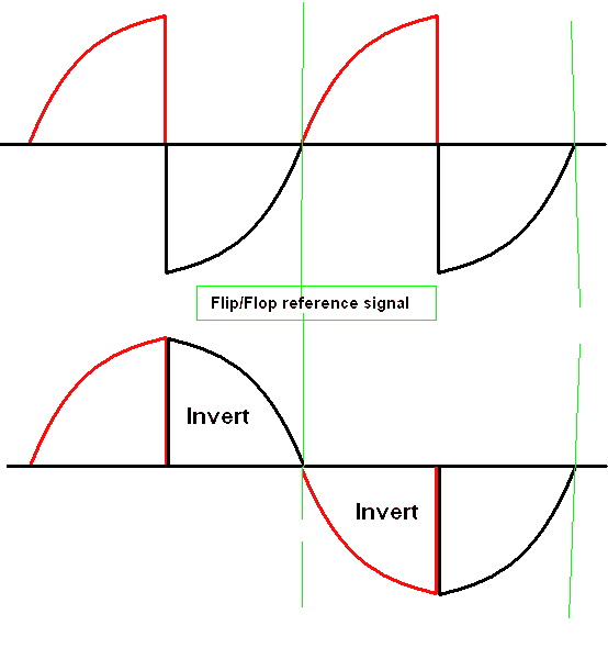

I had this idea for a week long now, to make this sine wave with a 555 timer and with a inverted op-amp and some transistor to switch the wave if necessary.
Here you can check out some info about the 555 timer stuff:
http://www.uoguelph.ca/~antoon/gadgets/555/555.html
My crazy idea no.1: To take the 555 timer and to make the wave curve by putting a capacitor in the circuit like described in the link, and use the last negative curve and invert the signal to positive my using the 741 op-amp invert function or an inverted transistor circuit, and then to use the positive curve to flip the entire signal to negative again. So the 555 timer will control your timing and will create your signal flip-flop reference signal for the positive curve fade in and fade out and will reset the thing to negative again. So this will probably need some homemade SRC’s to operate at the activation and reset of the wave. Yea and another thing you can use your 555 to generate your negative power supply, you will only need to adjust the frequency if needed.
I know this crazy idea no.1 will be some major stupid design and time wasting, but I think you might not disagree with me that this might be interesting, how it all works.
