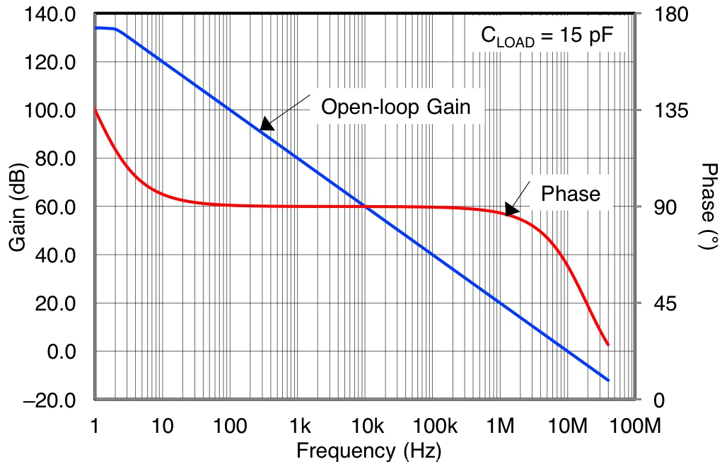

An integrator has a 90 degree phase shift throughout its useful range.
There also is a polarity inversion due to the circuit topology.
Op amps (open loop) pretty much do the same thing due to their internal compensation.

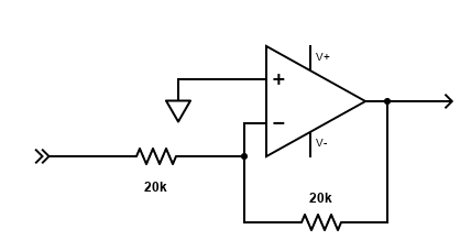

However this won't help you, since you need a noninverting filter circuit.
That is, one with does not change the source polarity, so you can fade the
source out and the filtered version in (or vice versa).
Just add an inverting stage at the input of the filter circuit.

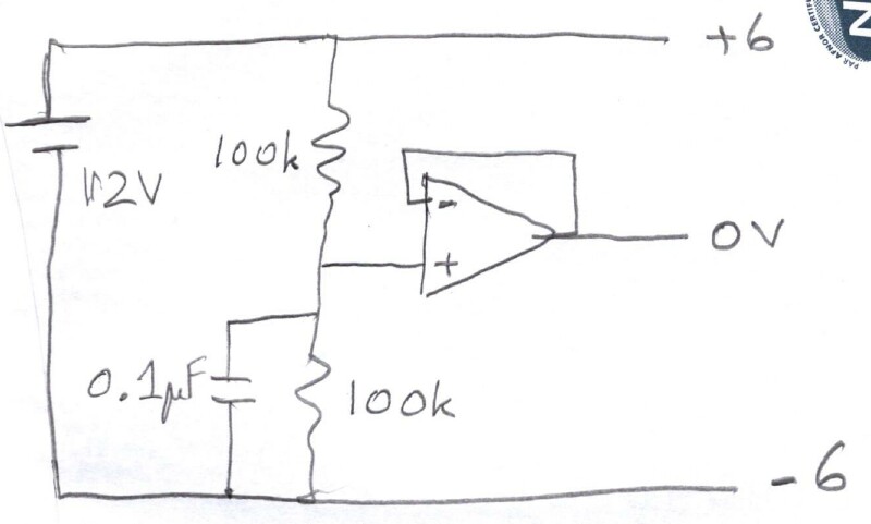

I'm using batteries (4 x 3.6v) in series and getting dual rail from them (+5.8/-5.8) using an opamp with a few resistors, as power supply.
Thanks a lot for the diagram. Would you place the extra inverting opamp right after the 10u source coupling capacitor?
Why do you need an op amp in the power supply? You can just use the batteries directly,
with one series pair per polarity. No virtual center tap is needed, since there's a real one available.
I'd also bypass the batteries with 100uF per series pair, but after the power switch so that any
capacitor leakage does not drain the batteries in storage.
Add the inverting stage before the input coupling capacitor. The source probably has an
output coupling capacitor, right?

Sorry, sunday distraction 🙂. My power source is 3 x 3.6v 14500 lithium batteries, which splits into 5,4v+/- with the opamp. Right at the limit of the opamps minimum but this is for space reasons and because I'm powering in parallel electrets that are happy with the series at 10.8v. Attached goes the dual rail circuit in use. Should I increase the value of the by pass cap in your opinion? Or an extra 100uF be added on the positive pole, for example?
Yes the source is a simple transistor CE preamp with an output cap. I'll include the inverting opamp in between as suggested.
