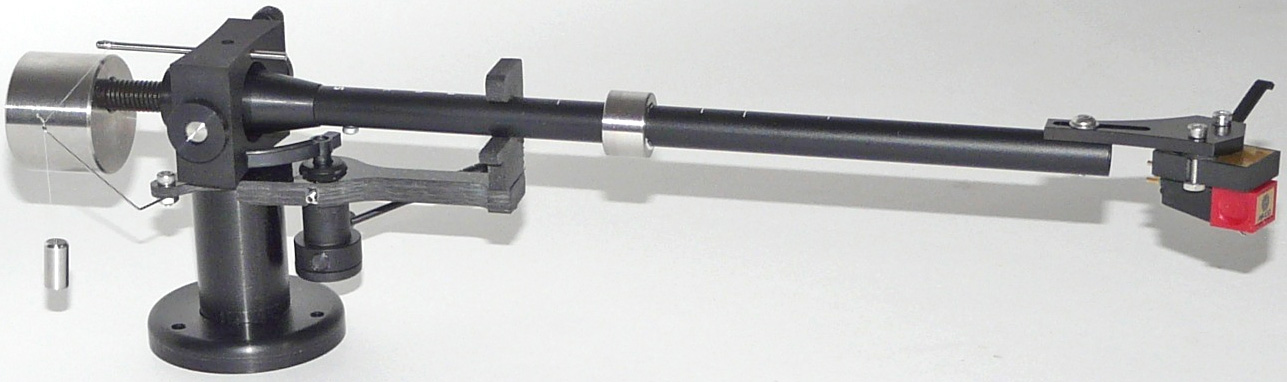

Something like this?
Tonearm with sliding weight on armwand, Abis.
Funk Firm F5 tonearm
Old school tonearm, Audio Technica AT-1005.
