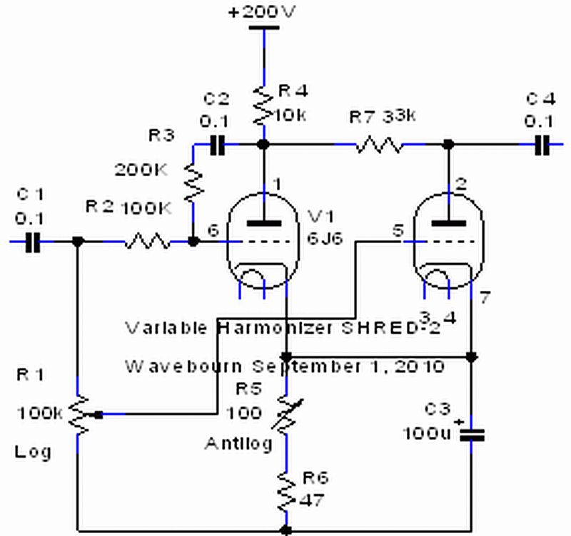

It is just an idea, I posted it for fun. I used it long time ago in a guitar pedal as a volume control, but with SS devices. JFET worked with zero D-S DC.

What a novel idea, "tubeness squared" 🙂 The really cool part is that by adding just one more stage (one tube conencted like the right one in schematic) you get the tubeness cubed and each successive stage increases tubeness output exponentially ! Tubeness doesn't merely add up as it happens in most cases with to audio devices.
If you put infinite number of reactive tubes to get exponential tubiness, one by one, the result will be as a single transistor stage distortions-wise, but with much lower gain. 😀
Take a single transistor instead, with no feedback by AC. Or just a P-N junction. 😉

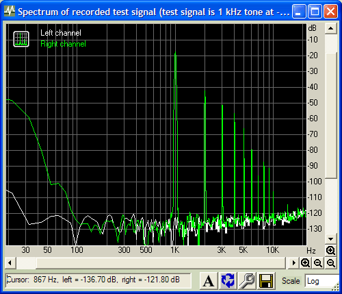

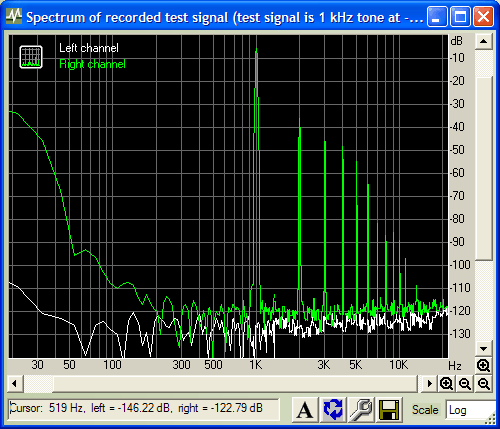

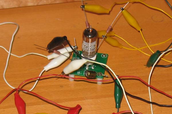

I put one of these together on breadboard (first picture). In order to keep the volume under control and not damage my soundcard, I ran the output through a 10K:150 parafeed transformer. I also used a 150V regulated supply as there were no 200V supplies within arm's length. And I used 1K grid stoppers on both grids. Otherwise, it was constructed as per the schematic.
First measurement is with the volume turned all the way up, second is with it turned all the way down with no other adjustments made.

In which position was the pot on the schematic? What DC voltages did you have on anodes? Am I right (reading from your graphs) that the difference between "all the way up" and "all the way down" was only 10 dB?

Try this:
1. Adjust R5 for the minimum of higher order harmonics when 100K pot on the lower position (zero signal on the grid of the 2'nd triode),
2. Increase signal to the 2'nd triode's grid and see if harmonics go up on higher input signal.
3. If increase of distortions is not significant with input level try R3 of a bigger value.
4. If it does not work as intended discard it and wait until I experiment and find something better.
Unfortunately, I took it apart already, and did not think ahead enough to record any voltages 🙁 But yes, about 12dB difference.

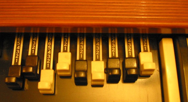

How about controls that work like these 😎

That means, it may be worked as intended: difference is visible. On lower levels higher harmonics should go away. I will experiment later with better amplification stage, but the similar reactive tube, to make it more variable.
Too much. 😀
