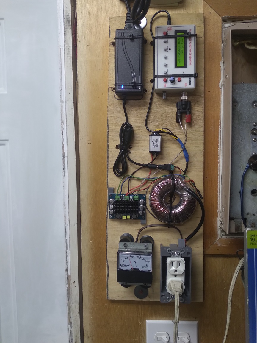

Here's the AC power supply. It's a bit ugly but it works. That function generator is only temporary until I find one that can store frequencies like the function generator I use in my other AC supply does.

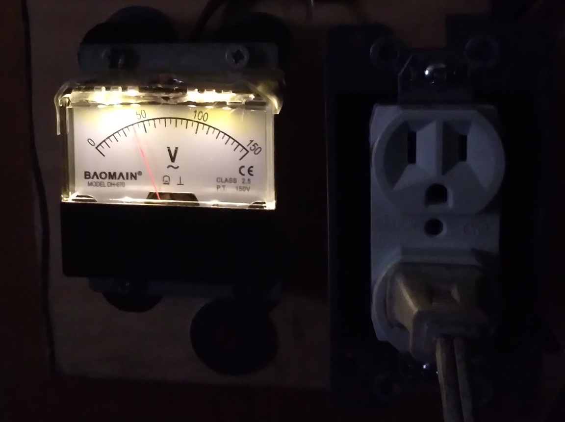

The mirror balls all start up fine on 30Hz at 40Vrms. The amp heatsink just does get a little warm.

The motors are permanent magnet synchronous and their speed is determined by the frequency of the AC.
