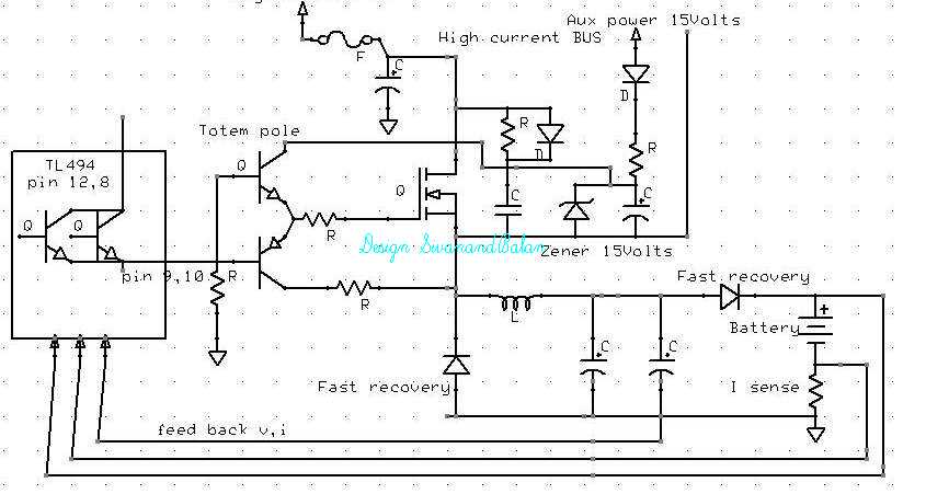

Designing a Variable 10-14Volt 10-15A BUCK requlator
Application: Lead acid battery charger/HAM psu
TL494 PWM o/p volts and current limit>> high side driver > high side n-ch power mosfet Z44/48 high current torroid inductor/ fast recovery diode...
all inputs welcome...

I wish to DIY...
looking for a high side driver for the MOSFET..even though i have IR2110 i don't want to waste it (the low side driver will not be utilised.)...

A 15Volts/15amp mains transformer is used to get 15 volts from 230V..which is rectified and filtered @1000mfd/ampere...

sivan_and said:Design so far....
Hey there
I tried to download your zip file but it just saves as "battery" .. I add the .zip extention and I still can't open it. Is it just a schematic? Could you perhaps post a picture? I'd like to give advice perhaps.
