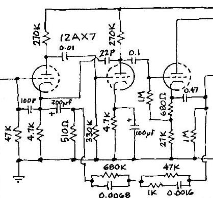

Dare I press my luck and ask how it would be done for feedback eq, such as the attached schematic for the Marantz 7C phono stage?
LB,
The Marantz circuit uses filters in a NFB loop to achieve the goal. That's active EQ. In circuits with loop NFB, the feedback network dominates behavior, as long as open loop gain is sufficient.
You said you wanted to use a type with lower Miller capacitance in the 1st gain block. The 6GK5 should fill the requirement. Stage gain will easily be equivalent, even though 6GK5 mu is lower than 12AX7 mu. The 6GK5 is high mu, high gm, and low Rp. The smaller Rp makes up for the lower mu.
The use of a 12AX7 section in cathode follower leaves (IMO) much to be desired. Inside a full function preamp that included at line stage, the 'X7 CF was tolerable. No way is it going to drive both the NFB loop and a downstream external load that includes cable capacitance. Point blank, the 12AX7 is a WIMP. DC couple a ZVN0545A enhancement MOSFET to the 2nd gain triode's anode as the voltage follower. You eliminate a coupling cap. and improve drive capability. Id = 2 mA. should get the job done.
BTW, the O/P coupling cap. needs to be at least 3.3 muF., if you are going to drive the IHF "standard" load of 10 KOhms.
A feedback RIAA is devilishly hard to do properly. It will take a much more complex circuit than that and unless you really know what you're doing, it will be difficult to stabilize and provide adequate overload margins. With all due respect to tradition and my elders, the Marantz phono circuit was mediocre at best.

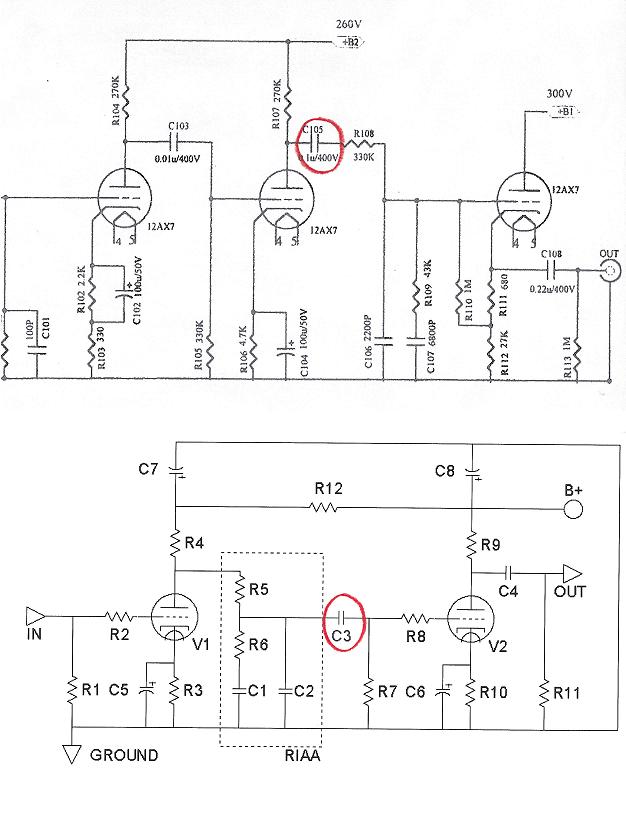

OK, I have a follow up question, does the position of the DC blocking cap in a passive preamp affect the eq?
To explain what I mean, I have attached 2 examples, with the DC blocking caps circled in red. Are the two equivalent, or does placing the cap in front of the passive RIAA components affect the eq?
SY said:
To be sure, place it after the eq. That will also allow you to make it smaller since the input Z of the last stage of your circuit is bootstrapped.
Geez, that's a problem. What my plan actually is, is to build a preamp with cheap PCB's I got on eBay. The schematic for those PCB's is the upper half of the file I attached. I am thinking I would like to build it as a hybrid, with a JFET replacing the first triode stage, a Russian 6922 for the 2nd stage, and a Russian 6N6P for the CF. So the blocking cap needs to be before the RIAA section.
