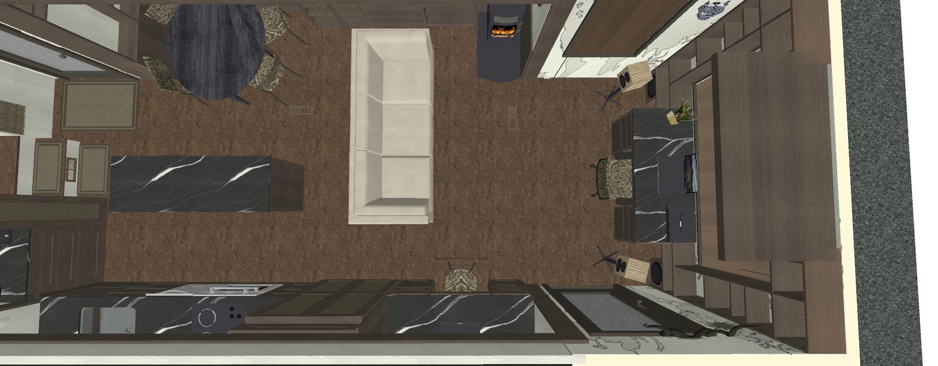

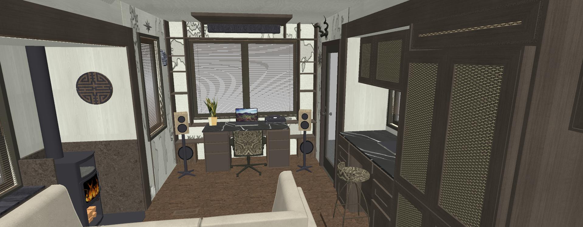

With dual sealed 10" subs, "Warp 1 and E70 Velvet on desk, sofa moved for one seat centered, can move as needed for movies, etc.
DIY fold down TV on ceiling, Martin Logan Vision X soundbar for general listening, Laptop for streaming Qobuz. BDP under desk, sub amp behind desk.
Sofa is triple recliner Ekhornes, super comfy, compact, cost $7k, bought mint for $700.
I think this would look dang fine, sound damn fine and lead to a more open space feeling.
I apologize for getting a bit off track on this thread, just get excited about things acting like I am still a kid at 70.....

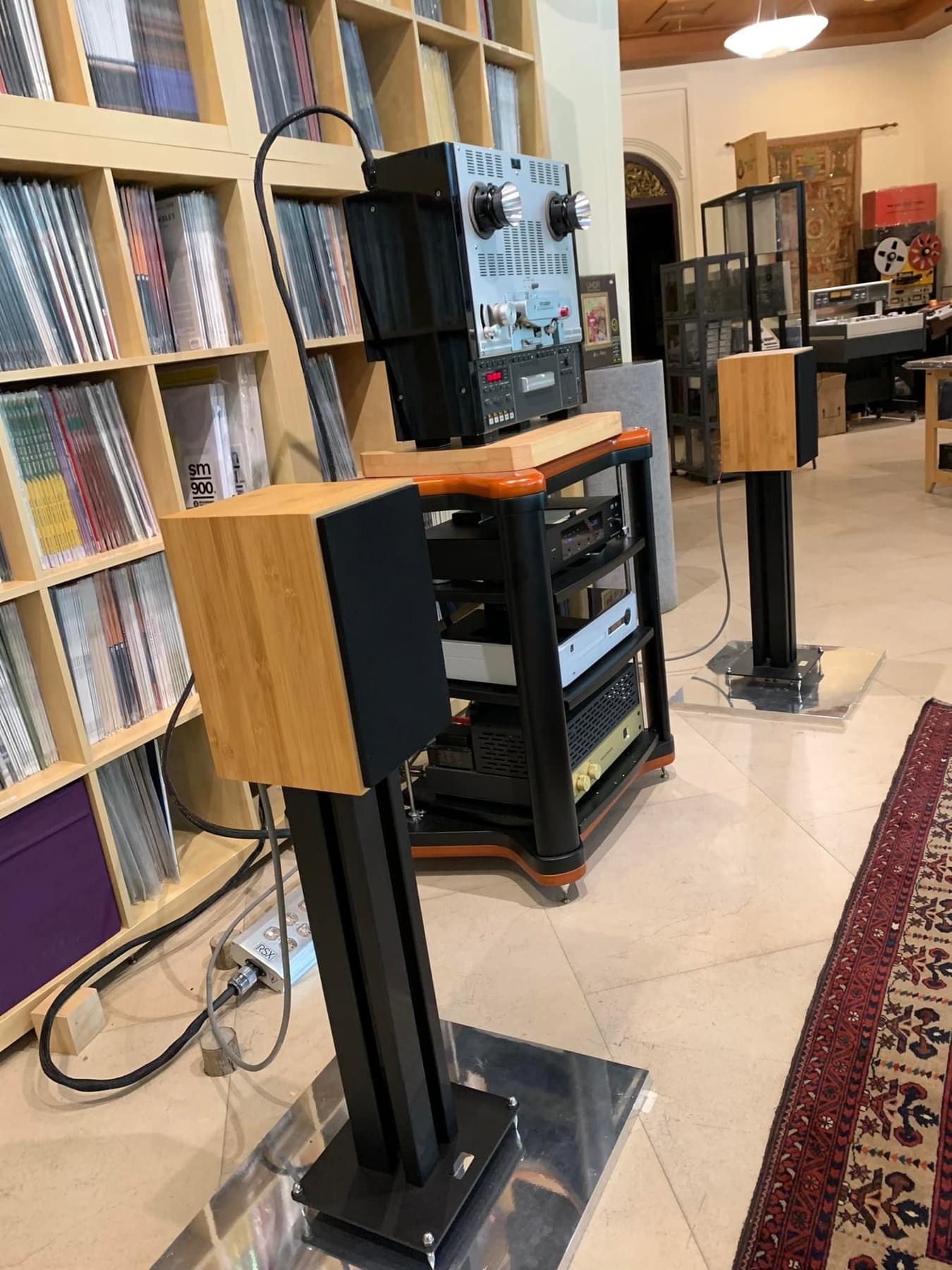

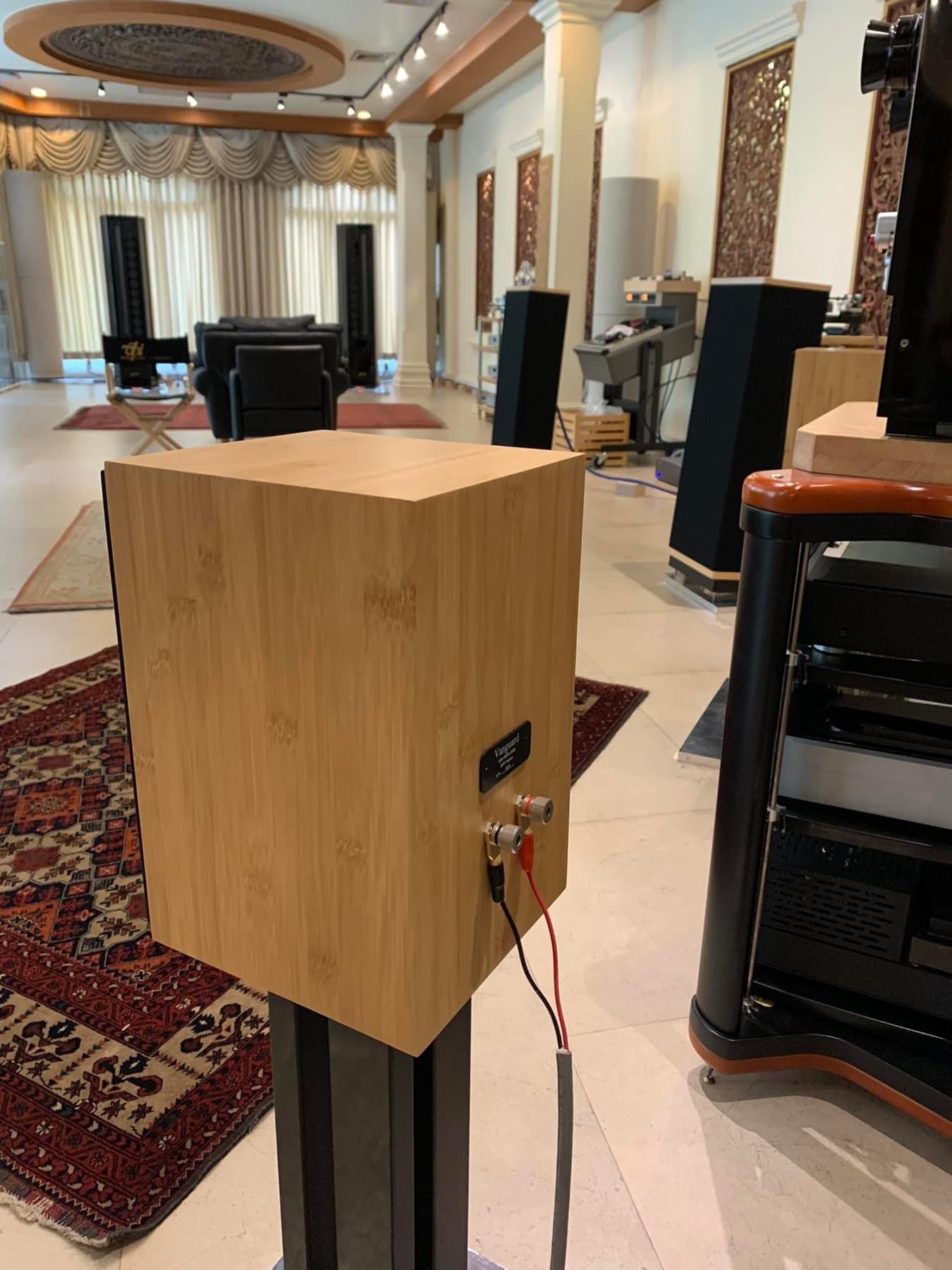

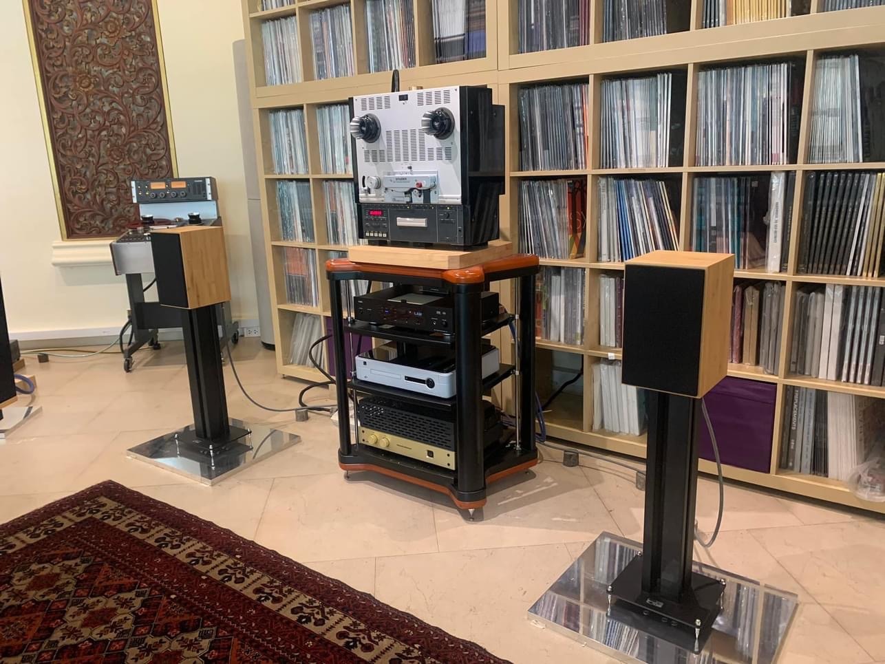

Vanguards are now in Thailand!
This is very nice rig complete with reel to reel and palace to go with it. 🙂

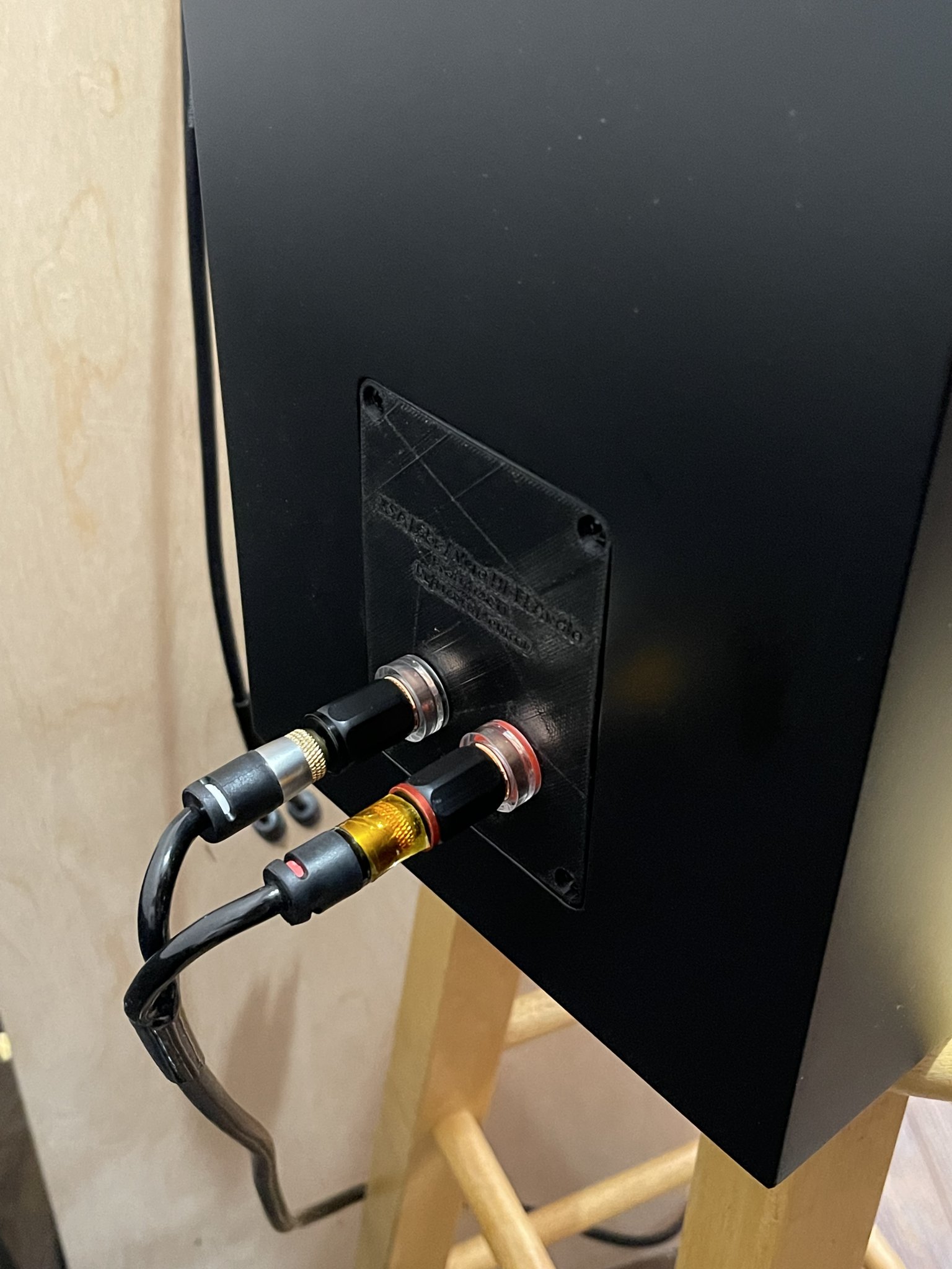

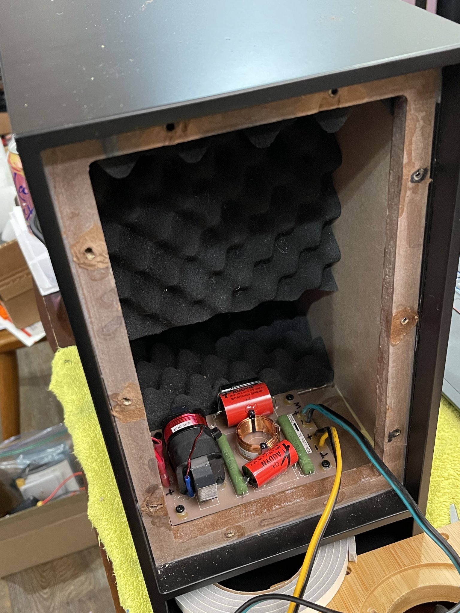

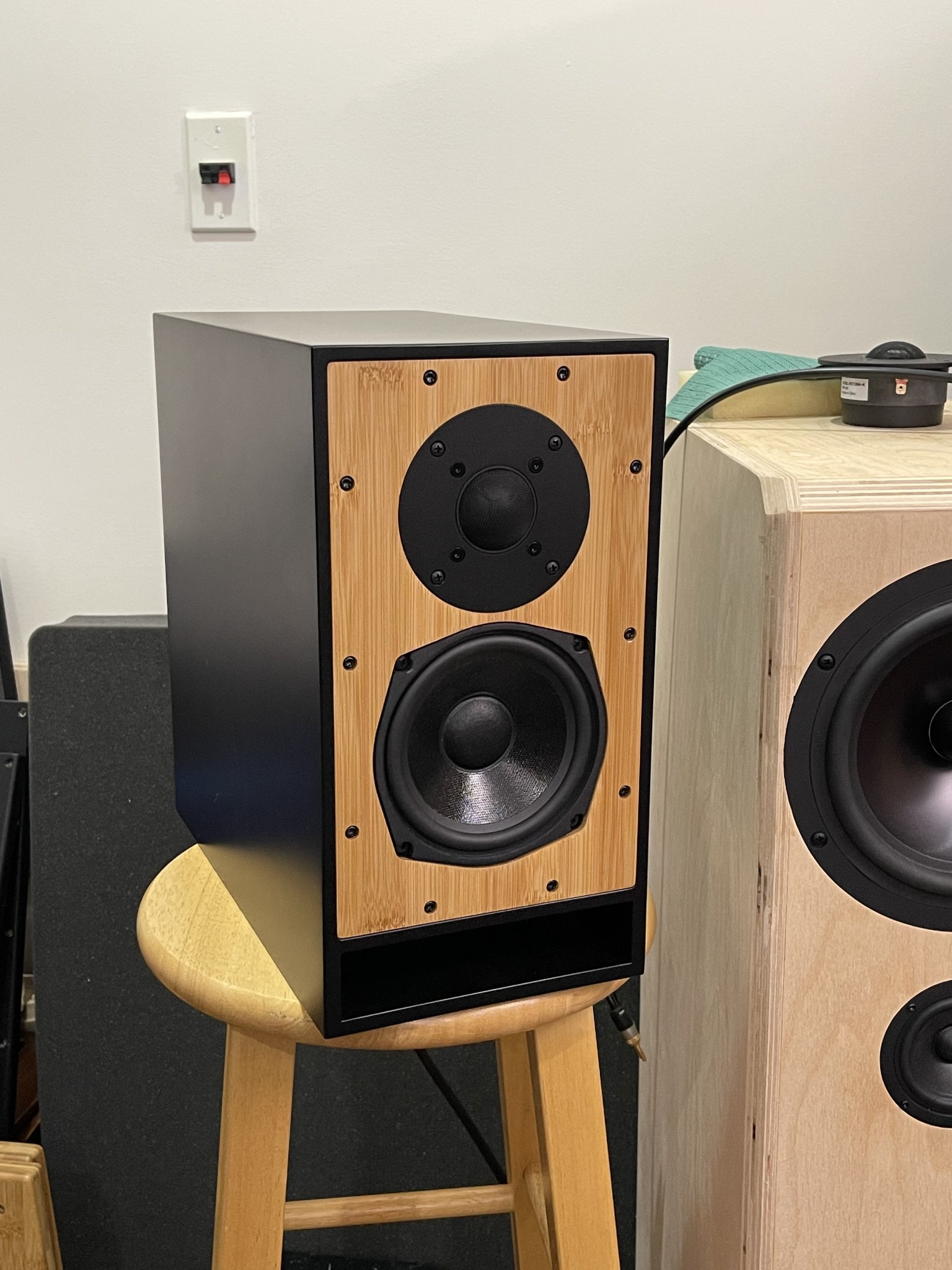

Vanguard TL just assembled. Assembling XO for second channel now so will be in stereo soon. I swapped out the baffle with the SB13PFC to one cut for DC130A. I had to 3D print a new binding post panel as I ran out of the CNC’d aluminum ones.

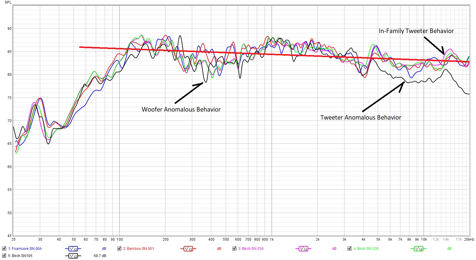

Amir is about great flat measurements. How do BBC LS3/5A’s measure? The Vanguard was designed to have a similar step function to the LS3/5A but with a bit more bass and smoother impedance using a different crossover philosophy: higher crossover frequency near 5kHz and using an inverted passive Harsch (4th order on woofer and 2nd order on tweeter with a quasi transient perfect step response).
The 700Hz to 3kHz hump he measured is strange and should not be like that if you look at my measurements posted on post 1.
For background, here is Sterling LS3/5A (BBC licensed) - would ASR call this a good neutral response?:
https://www.stereophile.com/content/bbc-ls35a-loudspeaker-stirling-measurements

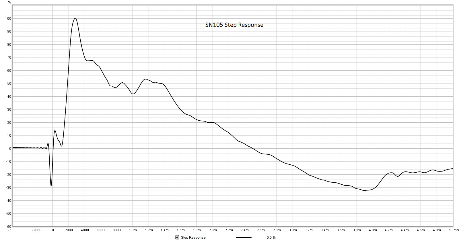

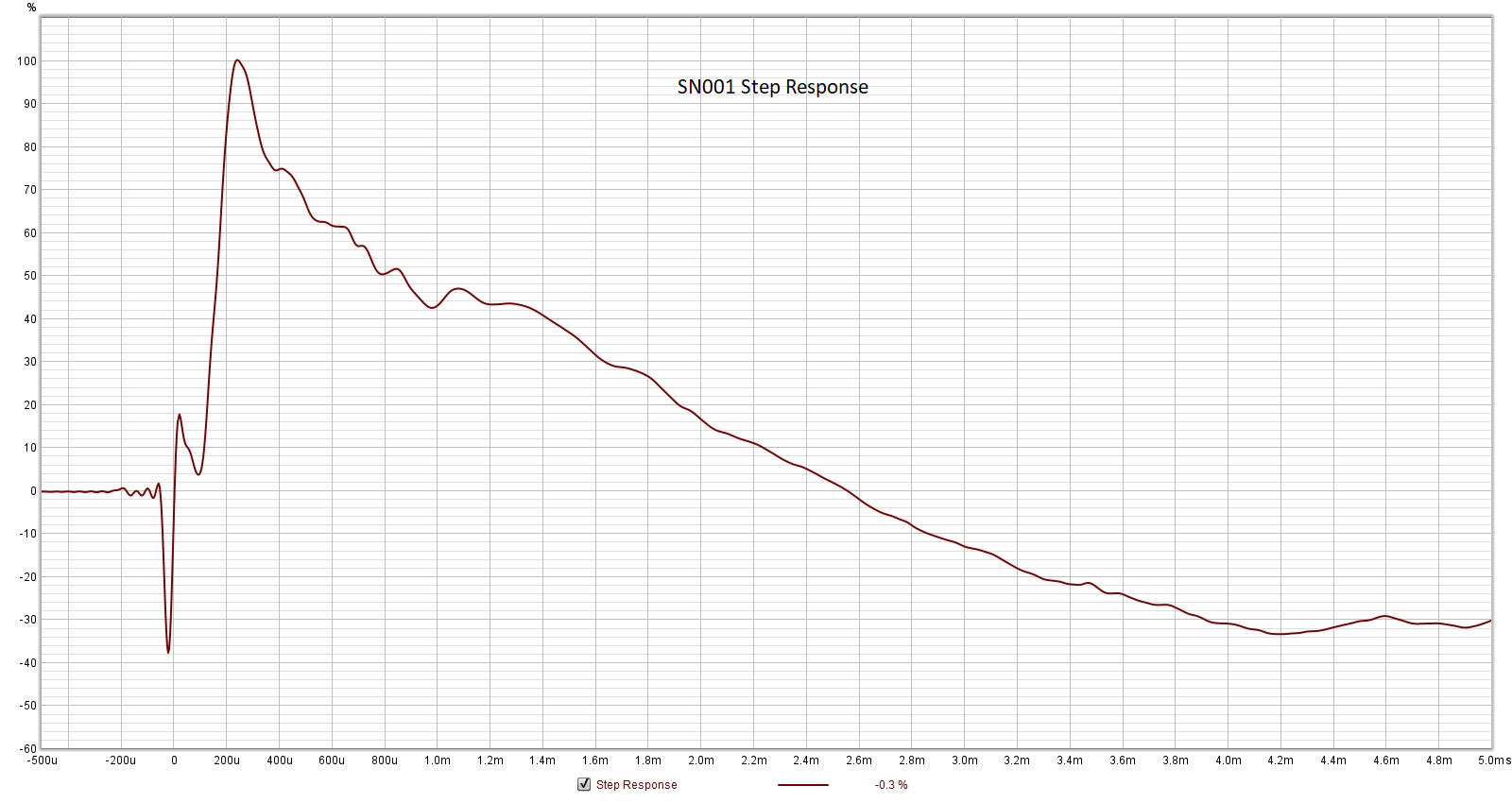

Hi Folks,
The ASR review had me scratching my head as to why the response was so off. I have measured this speaker many times before and it never looked like that. So I think it may have something to do with the variability in the driver responses or off-spec drivers.
I had a set of Vanguards from a later production run, serial number 105. I put it up on my test stand and took a measurement and was very surprised to see that it looked similar to the ASR response with a bump from about 700Hz to 3kHz and a depressed upper tweeter range. I compared that to earlier units: the first foam core SN00A, SN001, and later production ones in birch SN035 and SN036. We can see that recently with SN 105, the tweeter is low in sensitivity by about 5dB and the woofer is not as smooth. This can really be seen in the step function, also shown below. The tweeter response in ASR appears really off in its high pass function as it shows quite a high level at 2kHz whereas the response as designed falls off about 7dB more by then.
I would say that unfortunately, the test unit provided to ASR most likely had some bad drivers (both woofer annd tweeter) and this resulted in a response that is rough and not what was designed. I would be happy to replace the units tested by ASR with a set that is operating nominally, as designed.
Here is the frequency response measurements showing SN105 being out of family:
Here is the step response for SN001 (nominal):
Here is step response for SN105 (anomalous):
Please start a conversation with me here or on ASR Forum and we can arrange to test another sample. Do need to make sure somehow that whatever you send is what customers are buying.I would say that unfortunately, the test unit provided to ASR most likely had some bad drivers (both woofer annd tweeter) and this resulted in a response that is rough and not what was designed. I would be happy to replace the units tested by ASR with a set that is operating nominally, as designed.
