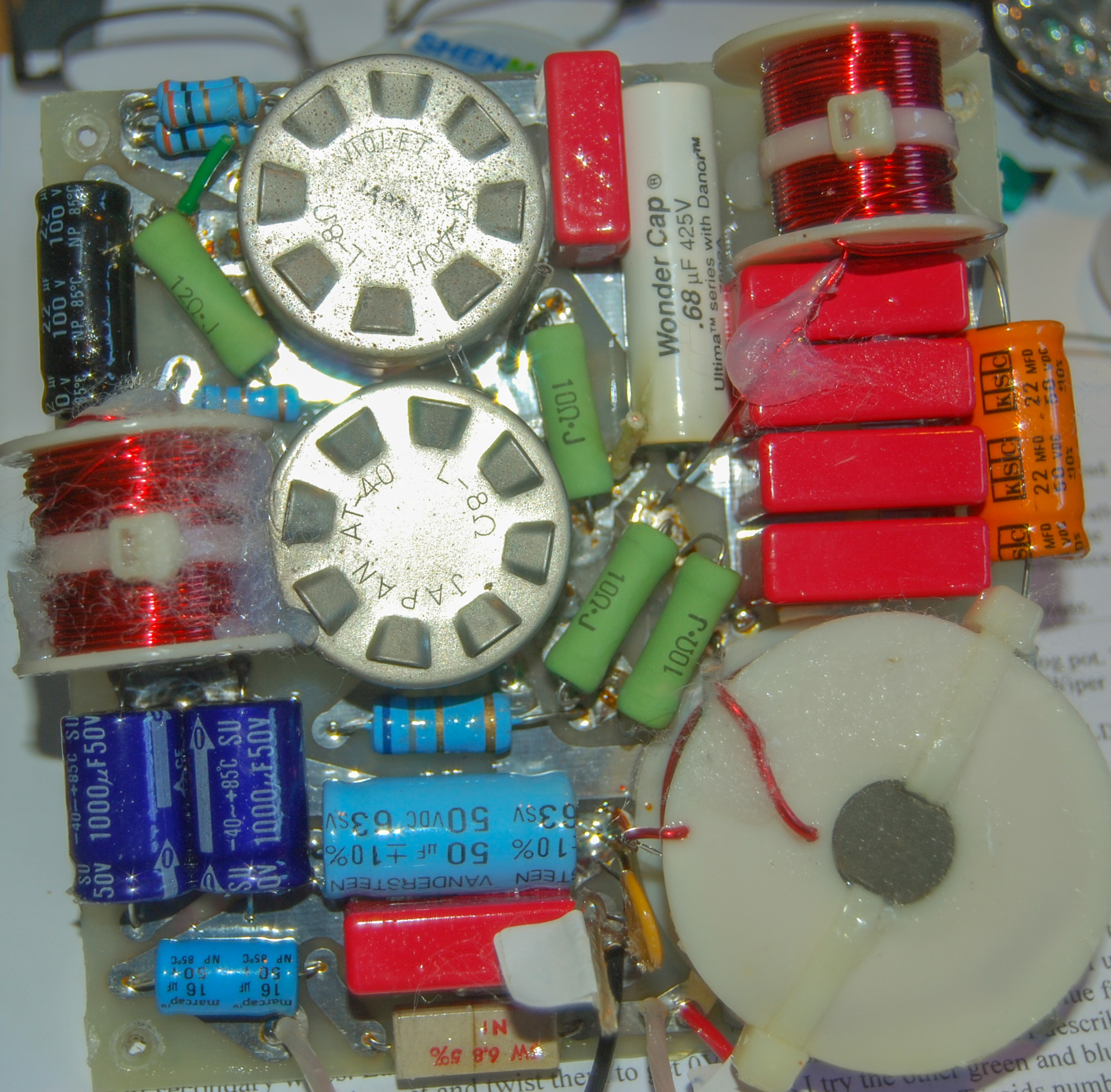

Are the 4 burned resistor on the filter ection of the treble unit ?
What wattage an type (cement ?)
What you could do is first swapping the treble filter resitors with the same values but cement type, if sibilance still here and you checked what Adason advised and hopping the treble unit has no damage cause too much abuse :
then swap the capacitor in serie with the treble by mylar type : it can helps sometime if the problem is light on the fhz curve in the highs.

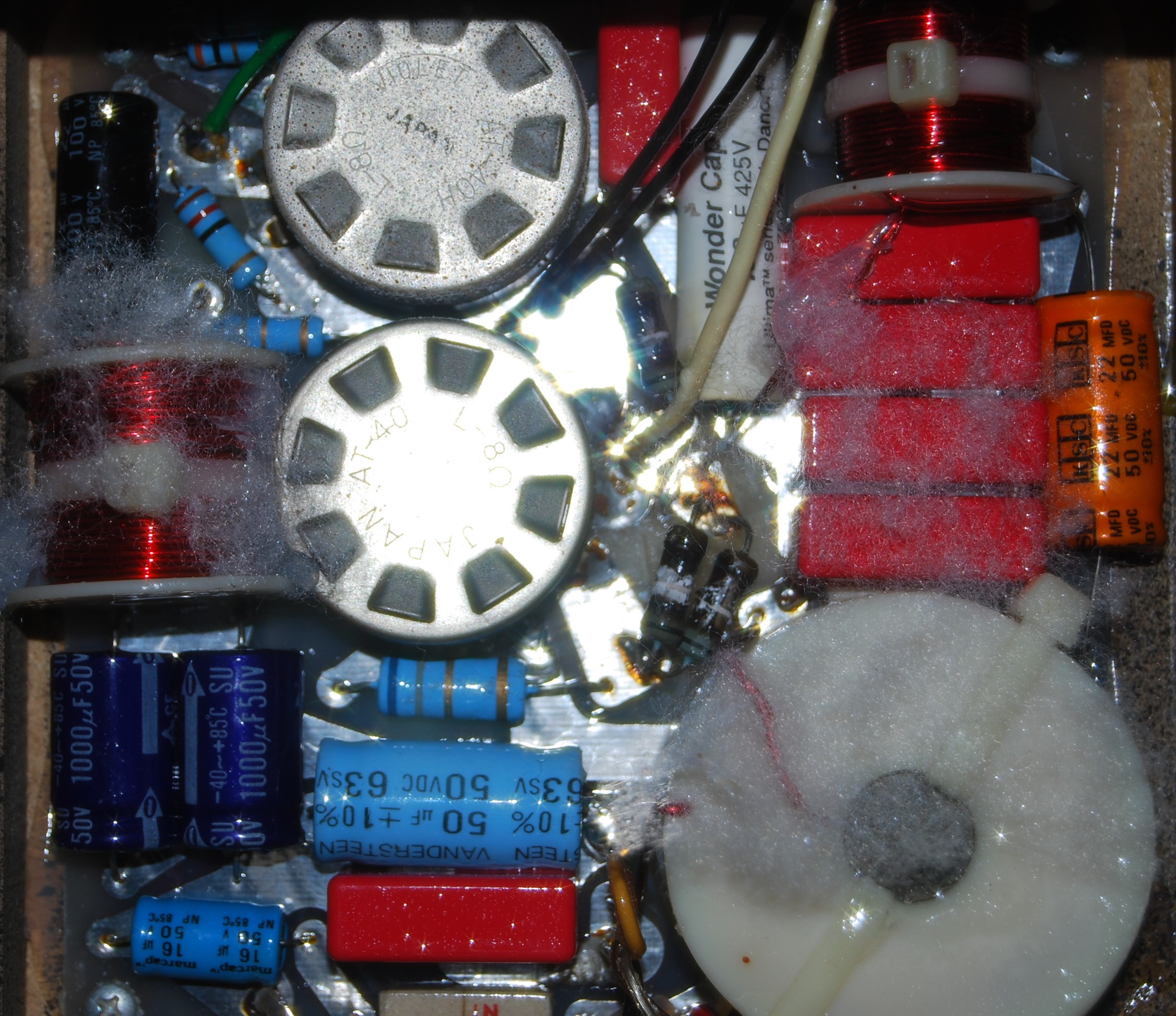

Since the three fried resistors were part of the series path to the midrange and because the midrange has ferro fluid, I would say it is the midrange is the problem. If the ferro fluid got overheated the damping of the midrange highs might now be non-existent which might well explain a peaky upper midrange ie: sibilance.
It seems to me that the resistors were under sized from the start being 2 maybe 3
Watts and since the total resistance is 3.3 ohms they will dissipate a good fraction
of the power into the midrange. The midrange is rated for a lot of power as can be
seen in the spec sheet that I linked.
I would replace each 10 ohm with 1o to 12 Watt types for a total of 30 or more and
they should be raised well above the circuit board so that there is good air flow
around them.

Pete, I just noticed that in the pictures you posted of the 2Ce crossover those resistors weren't there and the board was burned a bit.
Granted they are kind of low wattage but why burn now?

Are the deep blue caps marked with arrow and minus are polarised ???? So with tons of DF and ESR to avoid a resistor...probably shunt position!
And the lightblue rebadged Bennic???
Why so much efforts for a filter that would have a flawed design ?
If thetweeter is a diy add and themid has indeed sufferfrom hot summers and overheating...I may ask about a refurbishing to genuine original parts... norhing special with the audax...basic Morel is a possible swap but if the filter has particular impedance correction ...Fs not the same...
Any pictures of the burned resistors ?
