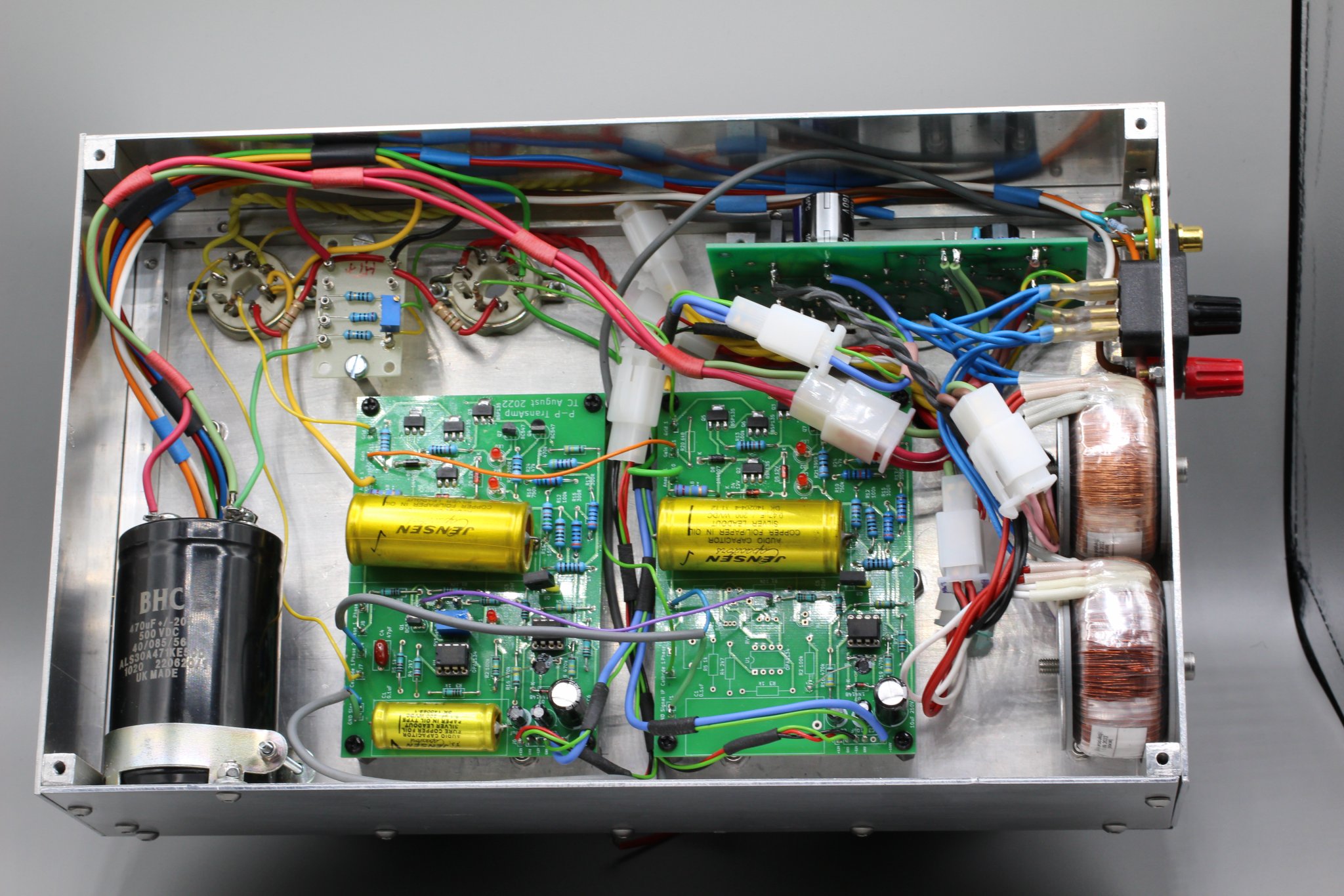

Hello fellow solder-slingers. Having retired at last, I thought it was time I tackled some of those projects I had waiting and the VDV Trans-30 amp was one I have wanted to build for years. I was impressed by the design which works to minimise the influence of the output transformer, improving the fidelity of the amplifier. I have trawled the threads but found no mention of this amp so started a new thread. Apologies in advance if I should have looked harder (my wife always says I seek not to find).

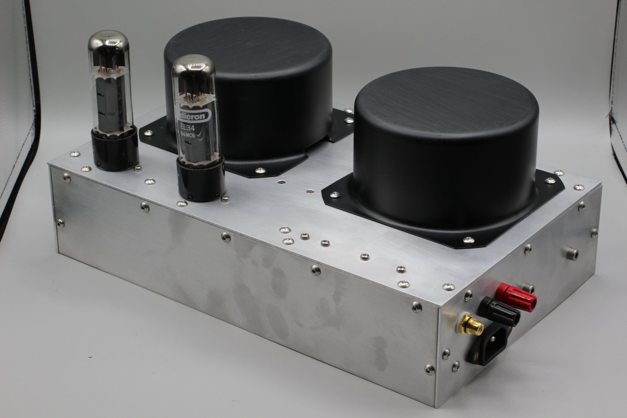

I decided to build my own aluminium chassis with individual side, top and bottom panels so that if the amp was a disaster, the top panel could be scrapped and most of the remainder reused for a new project. At one point I thought this approach had been well justified... I also decided to build 2 separate monoblocks for reduced crosstalk and the avoidance of needing a forklift to move it.
When I first started planning this project the UK was still in the EU, so I sourced the toroidal mains (TSTA 0220/001) and output (TTG-EL34PP) transformers from Toroidy in Poland and avoided paying VAT and duty 🙂

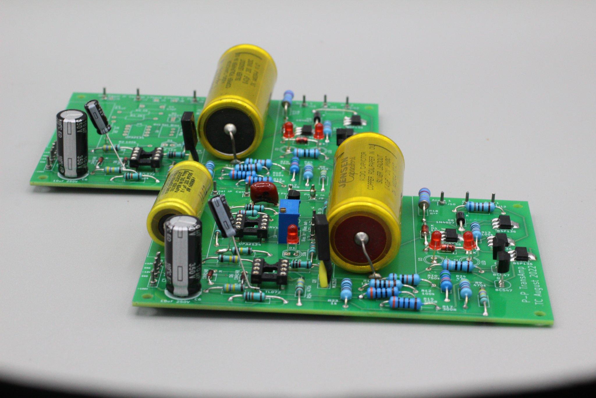

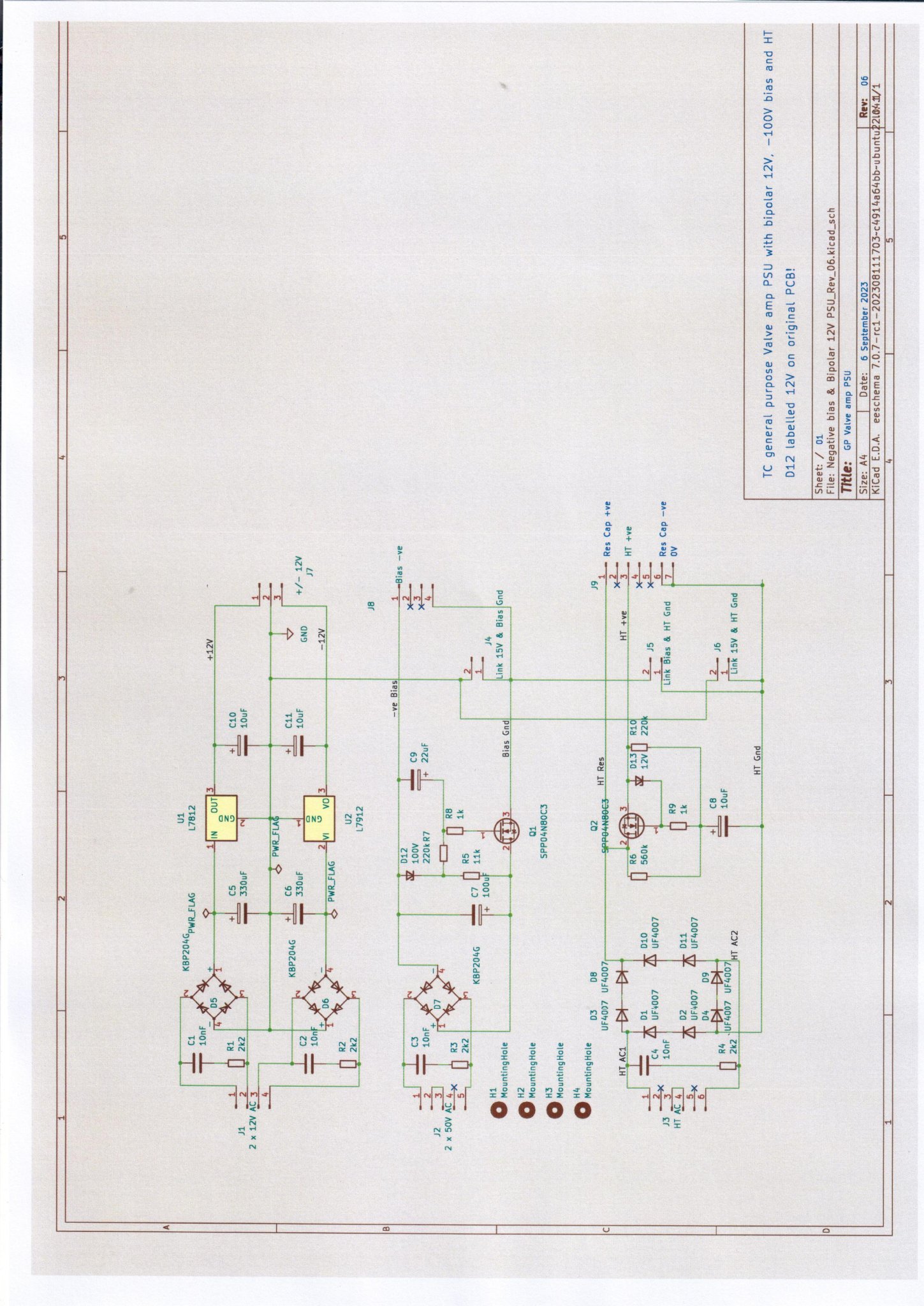

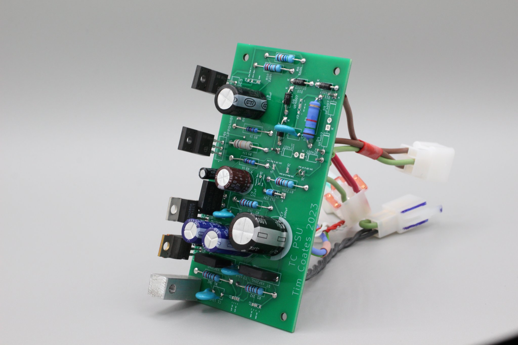

The VDV circuit comprises identical solid state drive/control modules for each of the push-pull EL34 O/P valves plus single bias set and phase splitter sections. A PCB was designed on KiCad that accommodated all these functions so that two PCBs were used per monoblock with the bias and phase splitter omitted from one of them. A power supply PCB was designed for the opamp, bias and HT supplies. I used a gyrator with an 04N80C3 for HT smoothing. Plenty of sand here! Stop reading now if you feel offended. 1k grid stoppers were mounted direct to the EL34 sockets and a small tagstrip carried the HT distribution, screen grid and cathode resistors, and the screen grid current balance preset. The PSU board was equipped with connectors to enable individual supplies to be unplugged and tested. Just one amp was built initially 😉
One cockup was spotted before testing - the footprint KiCad gave me for the MJE350 bias control transistor for some reason had its collector and emitter pads swapped, so this was fixed by bending the transistor's leads (see pics). The bias supply measured low, which was traced to me putting in a 12V zener instead of a 100V. This was caught on the bounce and the amp was powered up into a dummy load, monitoring the O/P on a scope. All seemed OK until it burst into oscillation and one of the EL34s started blushing furiously. My problem was that the O/P valve red plated as soon as the amp warmed up which made live measurements impossible. With many other things to do, I put the amp away in disgust. At least I had built it such that I could easily recycle the chassis!
I returned to it with renewed determination several months later. I reasoned that the red plating should be due to some failure of the grid bias circuit. Since it was the same EL34 that was affected every time, I tested the BSP35s responsible for pulling the grid down on its corresponding board and found the culprit. Having replaced the defective sand, I decided to critically review the bias circuit before powering up again. That was when I found I had altogether omitted the 10uF damping capacitors on the autobias circuit 😵 The sharp-eyed amongst you may have spotted the tacked-on caps on the driver boards...
The amp was powered up again, monitoring the volts across both cathode resistors and the O/P on a scope. Both resistors measured 0.6V, so 60mA quiescent bias current per EL34. No sign of oscillation so test signals were applied - all good.
Time for a listening test. I tried it with a Quad 12L2 and an Acoustic Energy AE1 speaker. It sounded highly detailed and musical, especially with the AE1 although it lacked the power to drive this speaker to high volume.
Having made one, its stereo partner was very much quicker and easier and I could then listen in stereo. The sound is impressive. I found myself hearing details that I have only heard before on good headphones (Sennheiser HD800 and Stax SR404 electrostatics).

A lack of a schematic causes blindfolded archers to miss hitting the bulls eye.

6A3sUMMER, the schematic is in the public domain - in the book 'Trans Tube Amplifiers' by Menno van der Veen
https://linearaudio.nl/trans-tube-amplifiers
This book describes Menno's development of his transconductance concept, culminating in this amp. As an author myself, I respect Menno's copyright which I believe I would be breaching by publishing his circuit here.
Thank you for your concern over the health of my O/P valves. They run at 80% of maximum dissipation - hot by any reckoning but acceptable to me in terms of performance and longevity.
