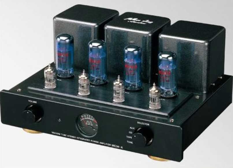

The schematic would be of use as it saves a lot of time when trying to figure out any of the calculations like how much +B voltage is going through. The iron if it is what they say it is, is what is preferred for iron in a transformer.
Other than that, we'll have to wait and see (kind of like being on Suhkumvit Road on a busy morning).
Code for, "engineered for fashion, not performance."
But does that actually make it bad or just not ideal... I realise they may be using wording that sells to some but seems fake to others, but how much effect does it have, and if lots is thins something I should be looking to upgrade?
Bare in mind this is not a top of the range amp... I can't afford one like that but for the money I spent it I think it sounds really very good...
I have a copy of 'valves amplifiers' on order, as it does look to be very good. and I have now got a copy of the schematics if anyone would care to take a look and tell me what they think... constructive critism is prefered though.
Except for exact values, and valves this is one of 2 "standard" Chinese EL34 schemas. The other configures the 1st tube as an SRPP. (different BTW from the schema i found -- i guess for an earlier variation of the MC34)
I affectionately call these pre-built kits. Decent performance for the entry price but room for a whole lot of improvement.
Without getting radical (is it on a circuit board or point-to-point?), 1st thing i'd do is put a lower gain, higher transconductance tube in the front, balance the LTP and put a CCS on the bottom.
The 1st stage has the same topology as the Bottlehead Foreplay -- you can get some ideas on improving that from all the work done on that circuit.

Poor choice of tubes, topology, and operating points. Other than that... It's cut-and-paste "engineering."
Briefly, the input stage is run in a configuration that drops the open loop gain while (in contrast to negative feedback) actually reducing linearity. The cathode follower does almost nothing to increase the drive capability or moving a critical pole higher in frequency. This is followed by a poorly balanced inverter which uses a tube that, under the large signal swing needed, has high distortion (of high order as well). The feedback is implemented badly- the "designer" has paid almost no attention to optimizing the open loop gain and the HF poles, and as a result, the feedback loop only achieves a small reduction in lower order distortion at the expense of increasing higher order. Depending on the output transformer, stability will likely be marginal- ironically, given the lack of attention to compensation, a poor quality transformer might actually be MORE stable in the circuit.
The same basic circuit is done competently (if not ideally) in the old Eico amps- HF-87, for example. That may be worth looking at for a comparison.
Ming-Da amps can be used as good donors of chassis and transformers for real amps, including output transformers that are surprisingly good. I would rather call them expensive DIY Kits than Hi-End amps.
