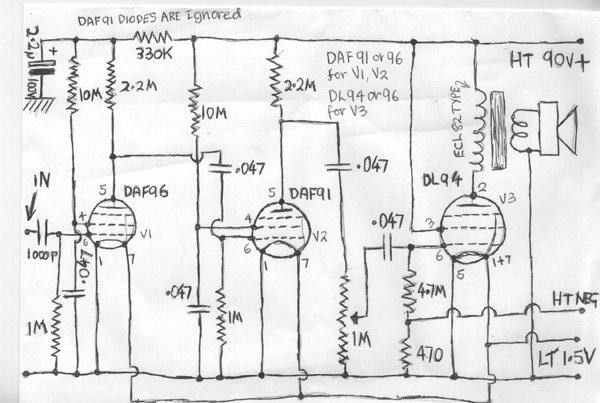

On post #10, Thomas shared a video of a battery powered radio converted into a guitar amplifier.
If we look at the schematic (attached), they keep things simple and just connect 1.5V batteries to the heaters.
Maybe I am being silly trying to do it differently.
What I would like to do is to bias the first preamp valve hot (close to 0V), so it can clip by saturation and then, the second valve is biased cold so it can clip by cut-off.
The power valve, should not clip at all, or only clip on the side that is already clipped while keeping the other lobe clean, so we can get asymmetric clipping.
This is non-sense in this amp, right? Should I keep it simple, as in the schematic attached?
Kind regards,
Pedro

It would be worth trying, maybe not easy to accomplish only using the battery.
I would strongly suggest, if you go down this route, you use a ICL7660 circuit to obtain different grid bias.
This way you can also remove it, if you want to go back to the normal bias.
If you add a good sensitive speaker (don't know if a MOD 6" would fit) it can get pretty loud, even with only some mW (for living room levels, at least).

My intention with biasing cold and hot is not because of the volume but because of the sound itself.
For eg, Marshall does that: they bias hot and then cold ("cold clipper") to have assymetric distortion. I want to avoid symmetric distortion.
@ThomasA
The ICL7660 looks a nice idea.
I will try a more sensitive speaker. Maybe first, my 12'' Eminence to see the difference, which I expect to be quite big.

If you are using the radio as a head into an efficient speaker then I would say you could play around with the bias. But I think going through the radio's speaker will have the volume (amount of sound out of the speaker) to low to appreciate any differences in the sound.
