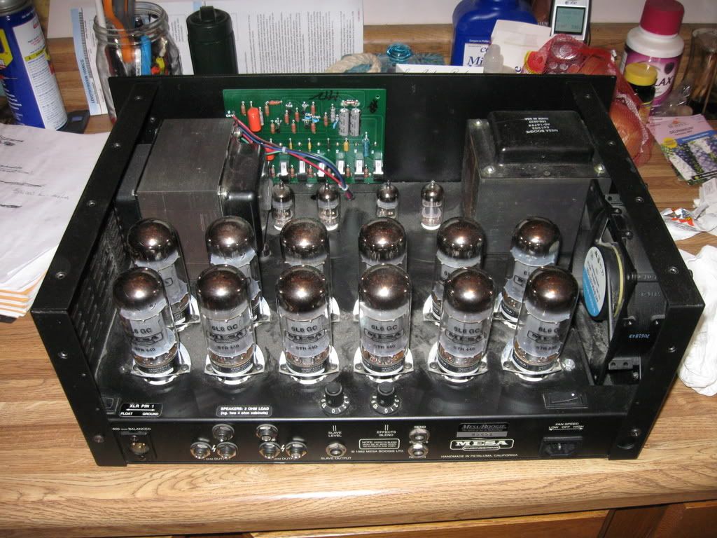

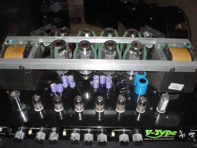

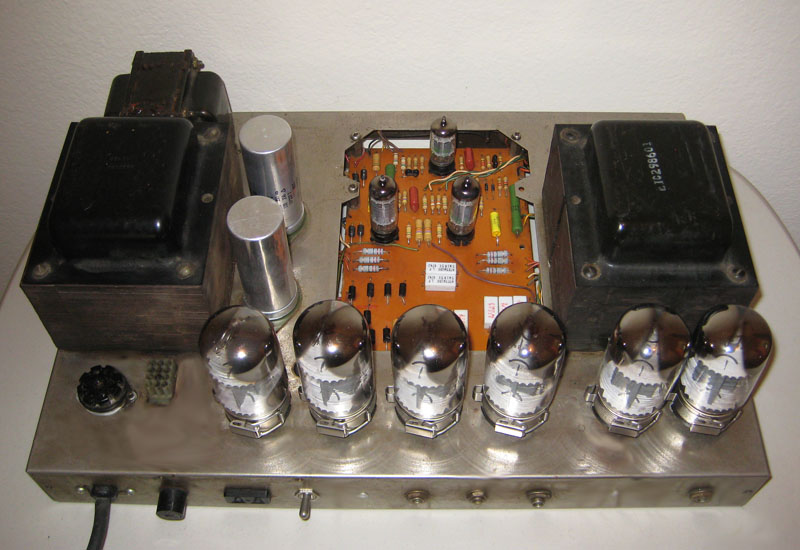

This might explain why Im a little confused:
Two Ampeg SVTs;
Trace V8;
Mesa something or other, maybe a 400+
All of these have the power tubes crammed in. Granted, the modern SVT, the Trace and the Mesa all have forced cooling, but it goes against all the advice here.
Anyway, I think Ive got a layout sorted that allows nearly a full envelope diameter between tubes. Im running them quite cool anyway, so I should get decent valve life.
Cheers everyone 🙂

Forced air cooling adds a lot of options. The SVT at top, when assembled, essentially has the power tubes in a duct with air being blown through. The real rule for tube spacing is that the envelope temperature should not exceed its max rating, ever. How you get there is up to you.
