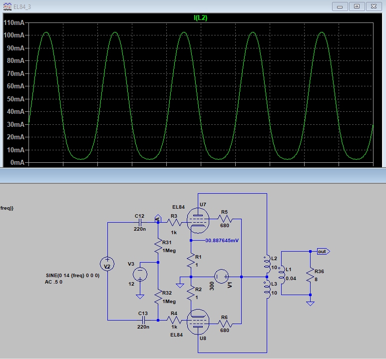

This EL84PP with 300 V supply voltage and 30 mA cathode current produce 19 W as maximum output power. Then grid 1 AC-voltage is 22 Vpp and operation is at AB.
At 10 W / 14 Vpp grid AC-voltage the output power is 10 W and plate current minimum is 2.5 mA meaning that the operation is now at class A.

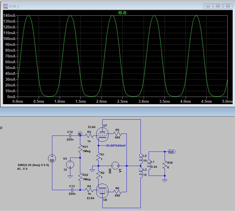

Here the point when the operation moves into class AB. Grid 1 voltage is then 20 Vpp. It seems that almost 80...90 % of the operation range is into class A.
