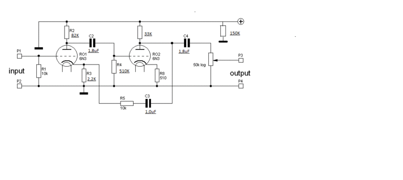

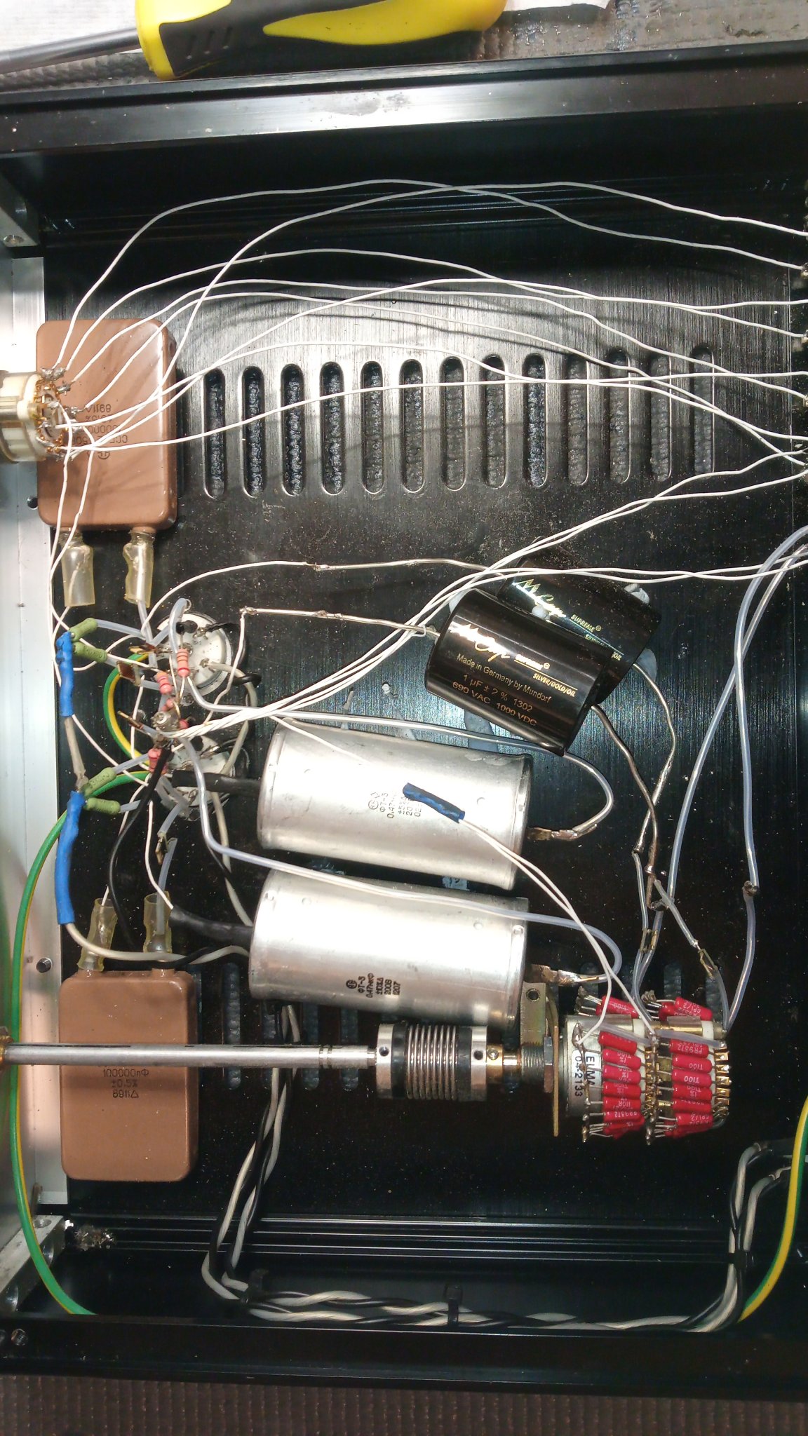

Hi.

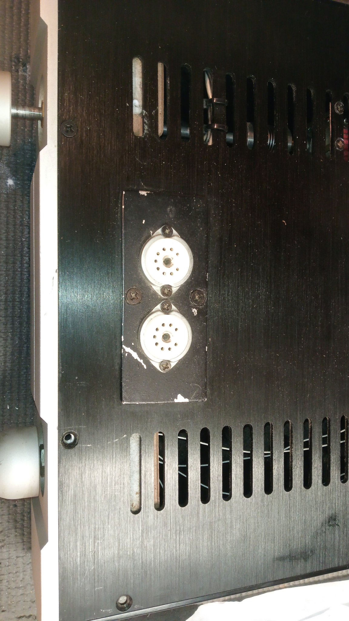

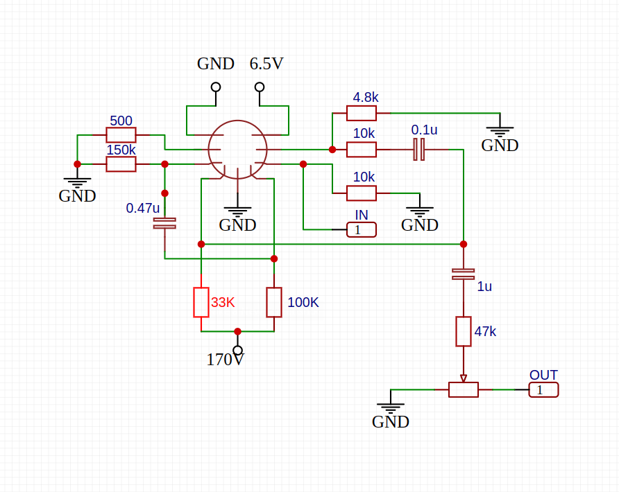

I recently get valve preamp with point to point connections and I cant figure out which valves been used there . Socket is 9ba but filament and high voltage are on different pins then for example 12ax7 . Psu give 170v dc and 6.3v dc but is adjustable and going for over 300v dc with pot . I've build few amps , preamps solid states , but never did anything with tubes and I'm interested to give a try . According to parts been used there it should be good preamp .I've drawed circutry but not sure I've did it right 🙂
If anyboby know that circut please advice .

Thank you for reply .
Stenak I understand my not understanding , I try draw it better way next time 🙂

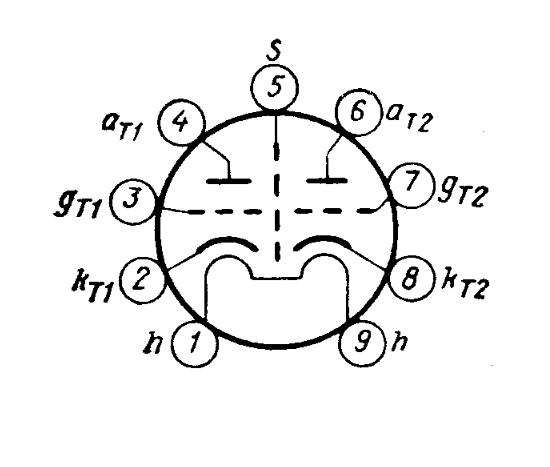

Depanatoru after checking 6np3 , again if read it proper looks like ground is on pin 5 and heater on 1 and 9.

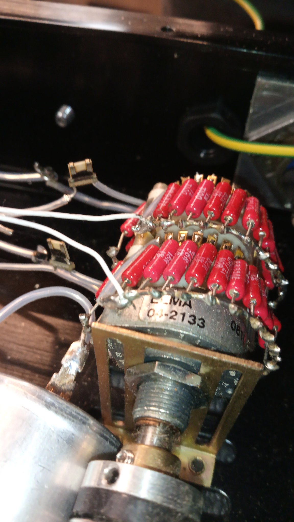

Hi. It took me some time to write here results . Preamp sound nice with 6n3p , but it burn me transistor in amp . I find out stepped attenuator make a pop when turning volume up and down . Also it have more gain then my boz preamp . Thank you guys for help anyway.

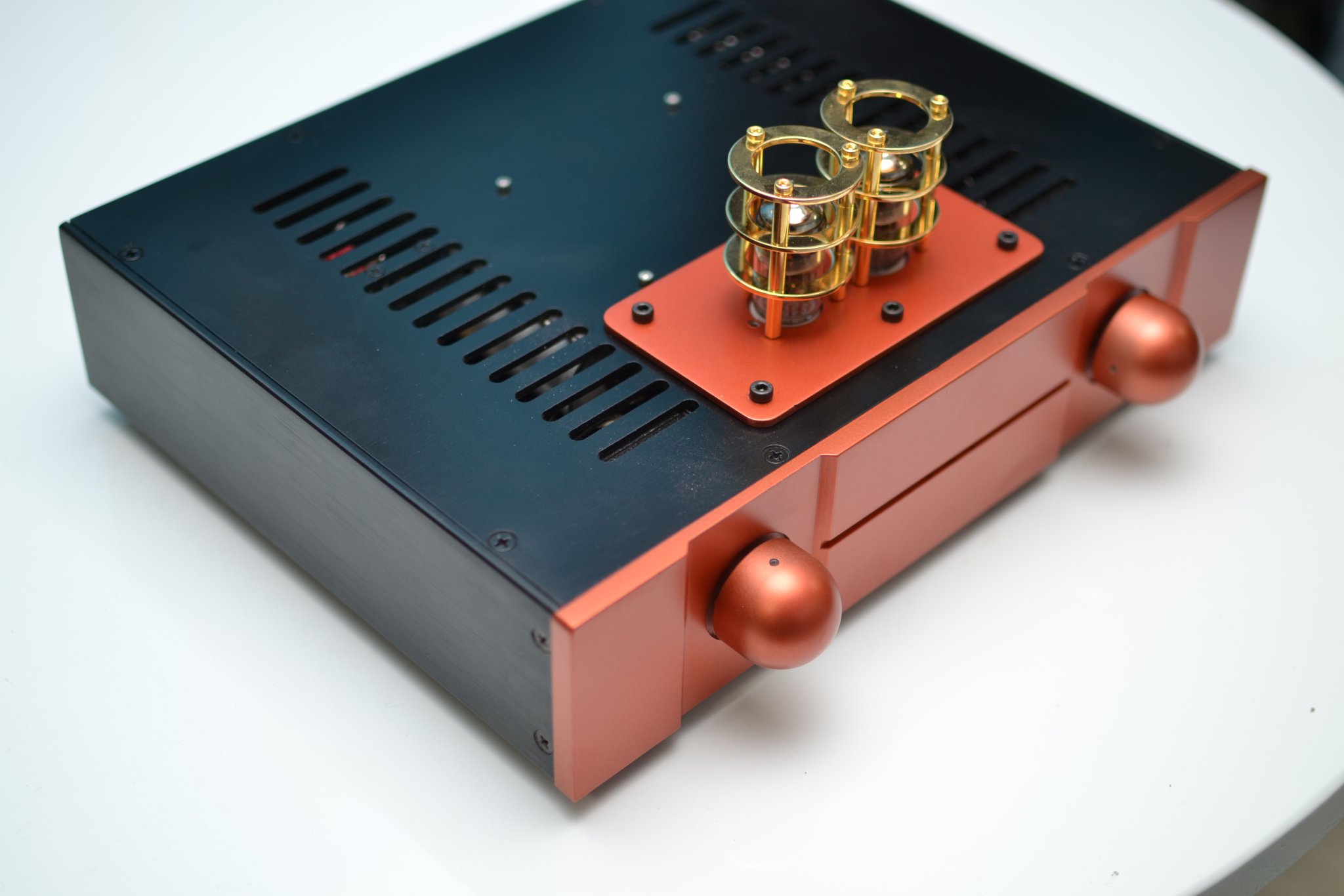

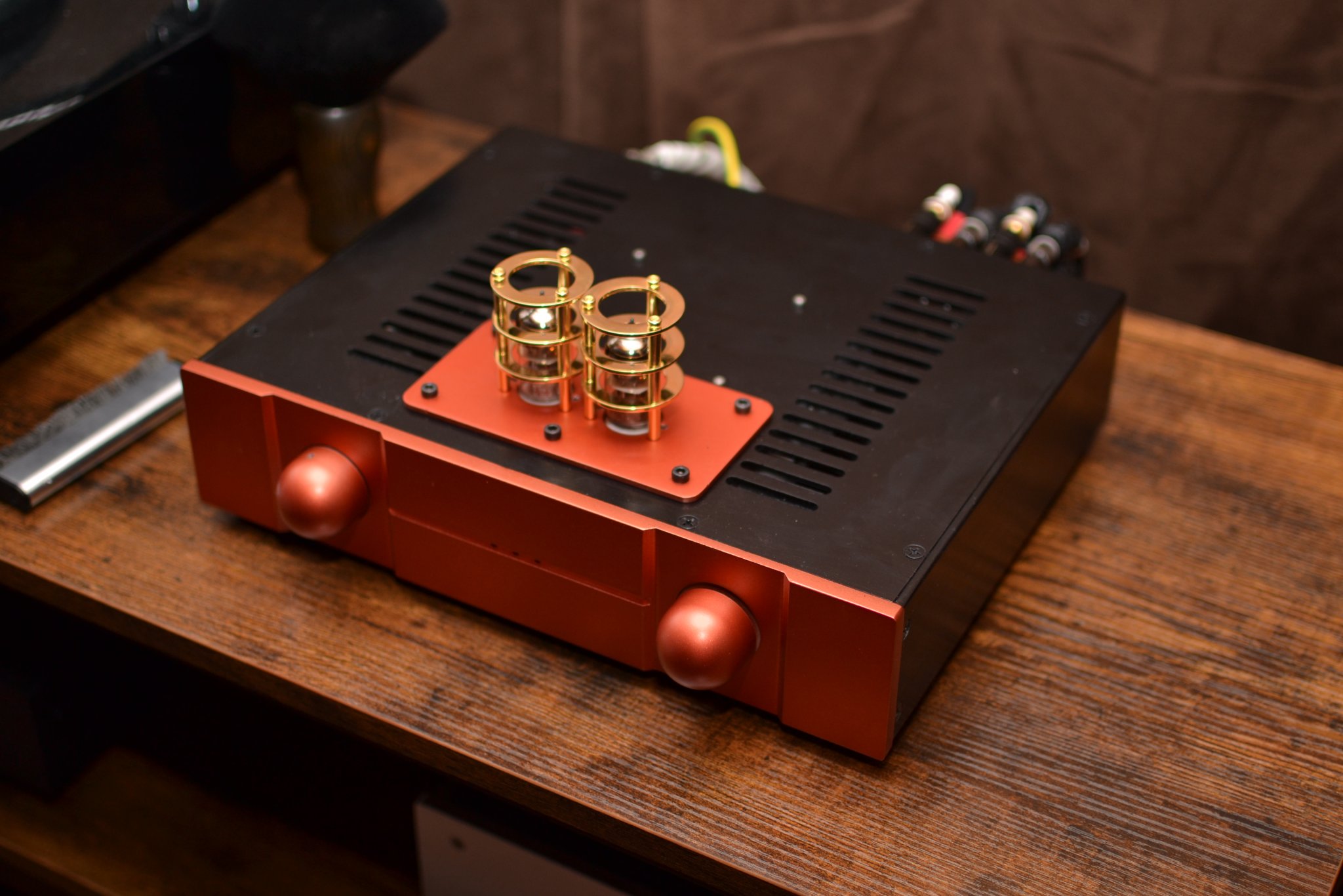

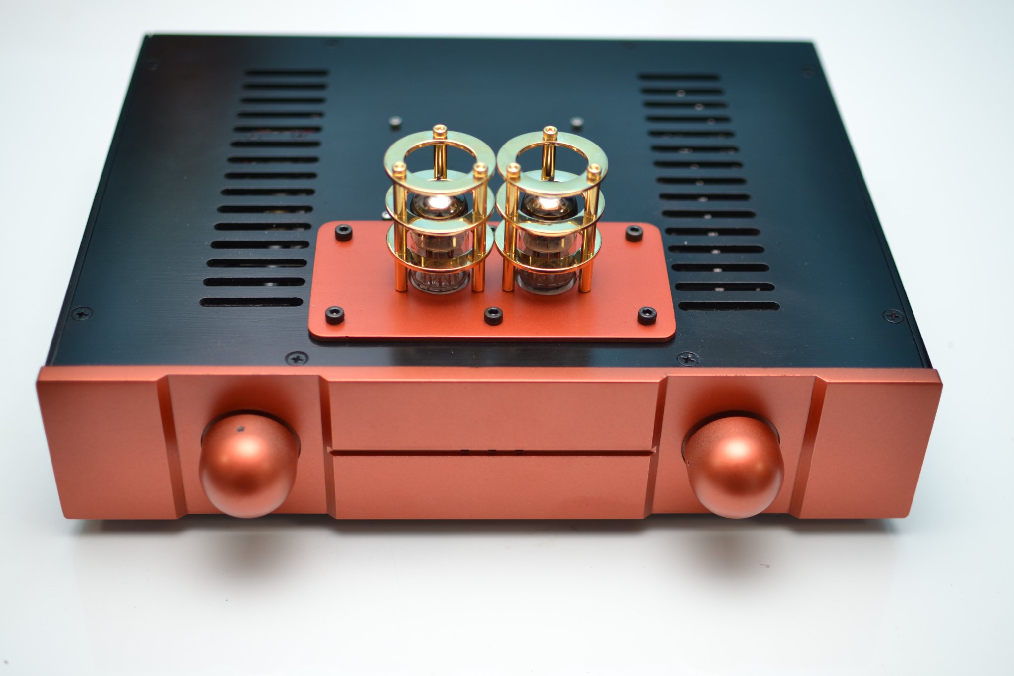

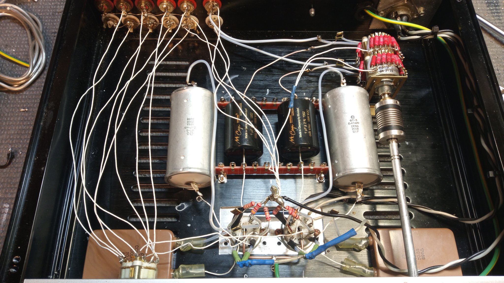

Hi . I want to share how preamp looks now and have another question . Psu gone and I want to replace it , but not sure what to use to get best results . What yours recommendations for good psu ?
