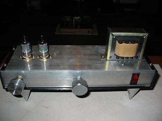

Commited, bottlehead needs to make a little money, don't they? 😀 My cheap Foreplay pic is attached.

nobody would like to take a stab on whether the Foreplay is well-engineered or not?

from the pov of a diy'er, there will always be room for improvement, that is why you see some mods on the web on how to improve it, personal tastes are at work here.
looking at the foreplay schematics, i guestimate it to have a voltage gain of about 2 or 6db, being a common cathode gain input direct coupled to cathode follower.

if i remember right, someone was educating me before that the Foreplay implementation is running on a non-linear region, but to me it still sounds good!
when I tried to make my own cathode followe pre using the 407 tube, i was forced to look at the curves, and try to operate it on a linear region. but funny thing is, while it sounded good, operating it in the non linear region, sounded better.
so, how's that? wrongly engineered approach? but sounds good?
what is the definition of a well-engineered circuit?
unfortunately the tube data sheet curves does not always show clearly the operating points we wish to operate on, so maybe this is what you call non-linear region, but actualy it is not.
non-linear region to my mind is that region where tubes are saturated, meaning increasing grid bias does not produce a commensurate increase in plate current, or when the tube is in deep cut-off so that any further negative bias does not produce any more decrease in plate current. i know this hold true for ss but is also true for tubes. for as long as there is a coresponding change in plate current with every change in grid bias, then you are still in linear operation.
so, when i look at the data sheet, i do a lot of extrapolations and interpolations and hope that i am within strinking distance
i believe that the reason tube data sheets always gives two operating points on its characteristics is so that we can navigate our way to desired operating point with reasonable accuracy.
